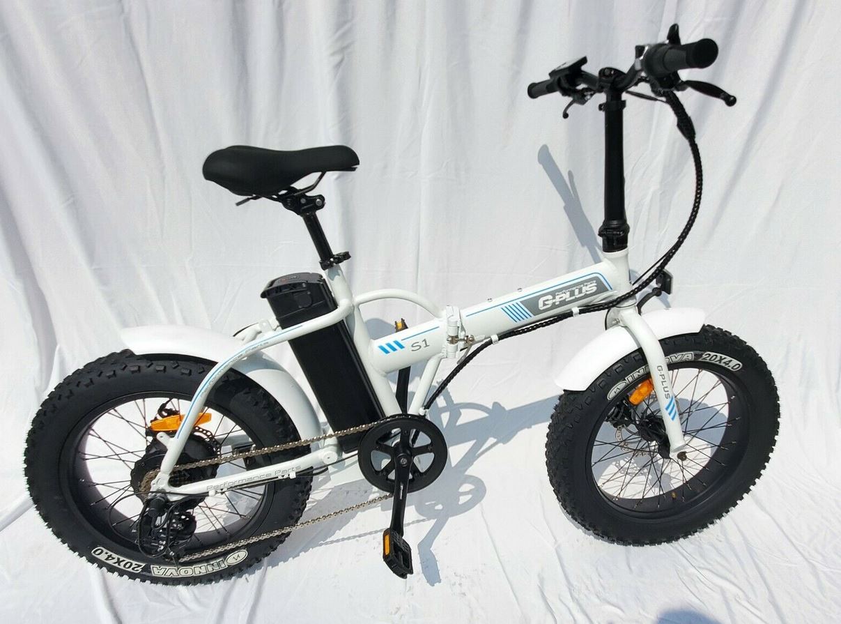

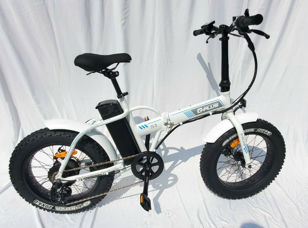

What about this ? Maybe a little heavy though , but it's cheap and pretty well priced. It's 500 watts though , you maybe able to slip by with it. It's only $1200 US
I don't know how aggressive your police are there. You could slap a 250watt sticker on it. If anything you at least have an off-road fun toy.🤣
noooooooooo!
I was going to say that I wouldn't be seen dead on that but it would be more accurate to say that I probably would...(subtle sorry)
