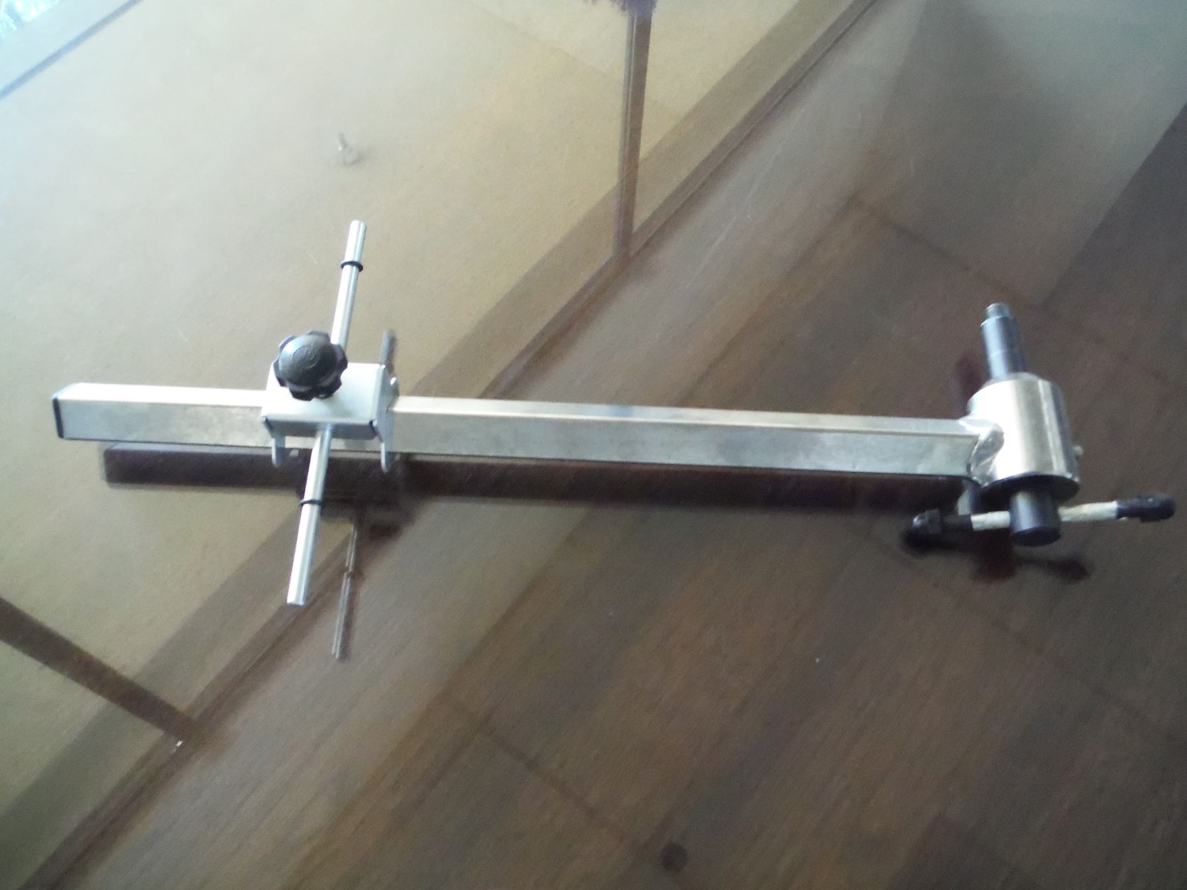

Get the Box Blue with its specific shifter. Put a DHAG II on the hanger first. That is the real cause of the problem. The hanger is tweaked. Replacing a derailleur with out this adjustment, will not help. Might as well install a new cassette and chain at the same time.

It's easy to straighten and/or replace the hanger using the tool mentioned above by PedalUma. It's easy to use and takes just minutes.

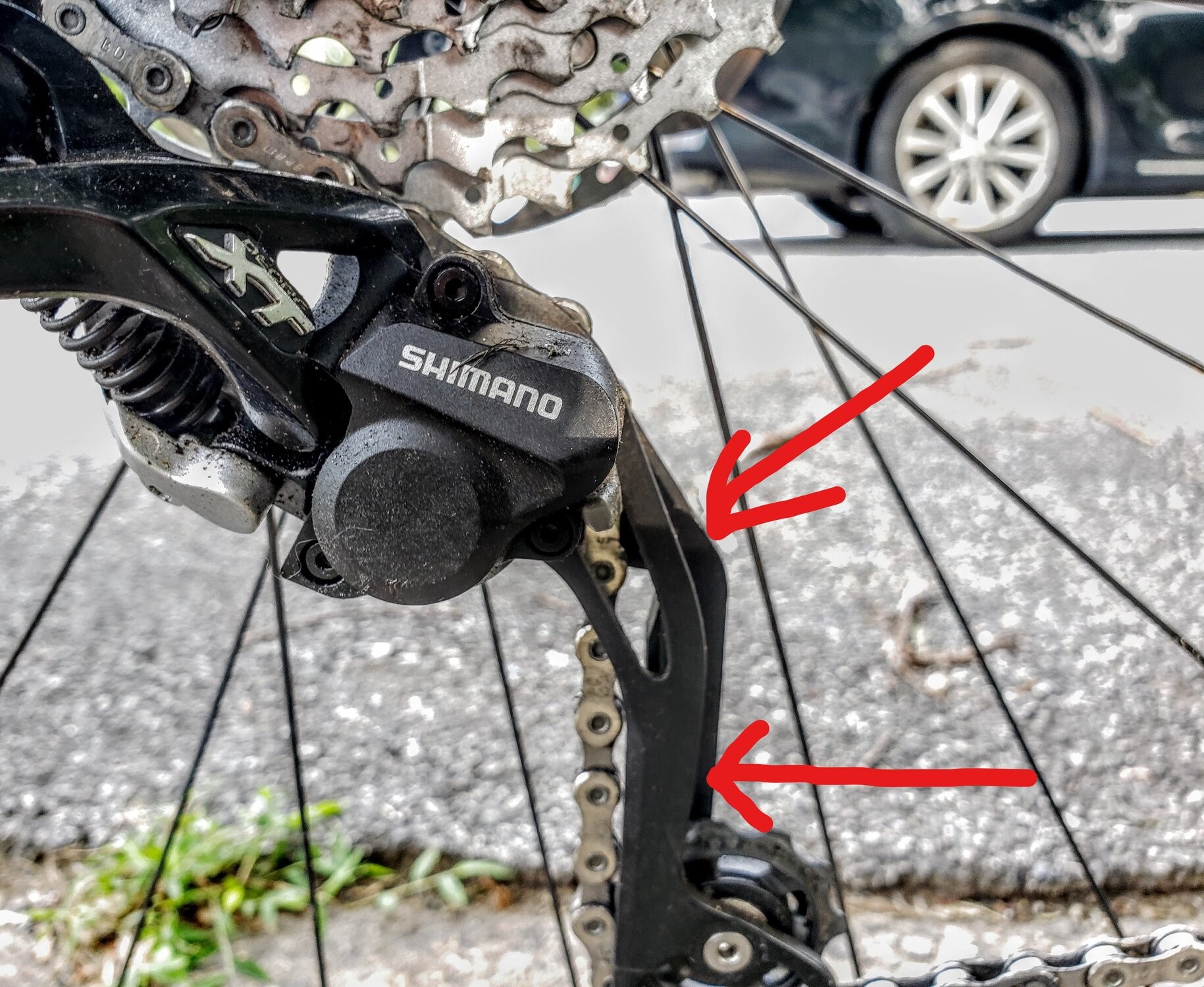

here is a photo to show where the bending occurs regularly. the two wheels on the derailleur end up not lining up, the lower one gets twisted and is out of alignment with the top wheel. Strangely enough the hanger has not bent much. the hangar has been replaced once and that was with one of the new derailleurs. I check the hangar regularly and it seems not to be the issue. it seems the construction of the bar between the two wheels on the derailleur is made cheaply and very easy to bend and twist. Hence the question, is there a better made derailleur with a more solid construction, maybe with heavier steel that resists bending and twisting.

That's very strange. The part you show is the chain cage tensioner, As long as the chain is adjusted properly, it's under no stress at all when you pedal. Are you sure you aren't stressing it some other way like striking the ground during a turn or while transporting the bike?
Since you have a single cog in front, you may not need that much chain slack. It may be possible to use a shorter cage, which in theory would be stronger. It might require removing a few chain links. I don't know if Shimano makes one for a 1x9 derailleur though.

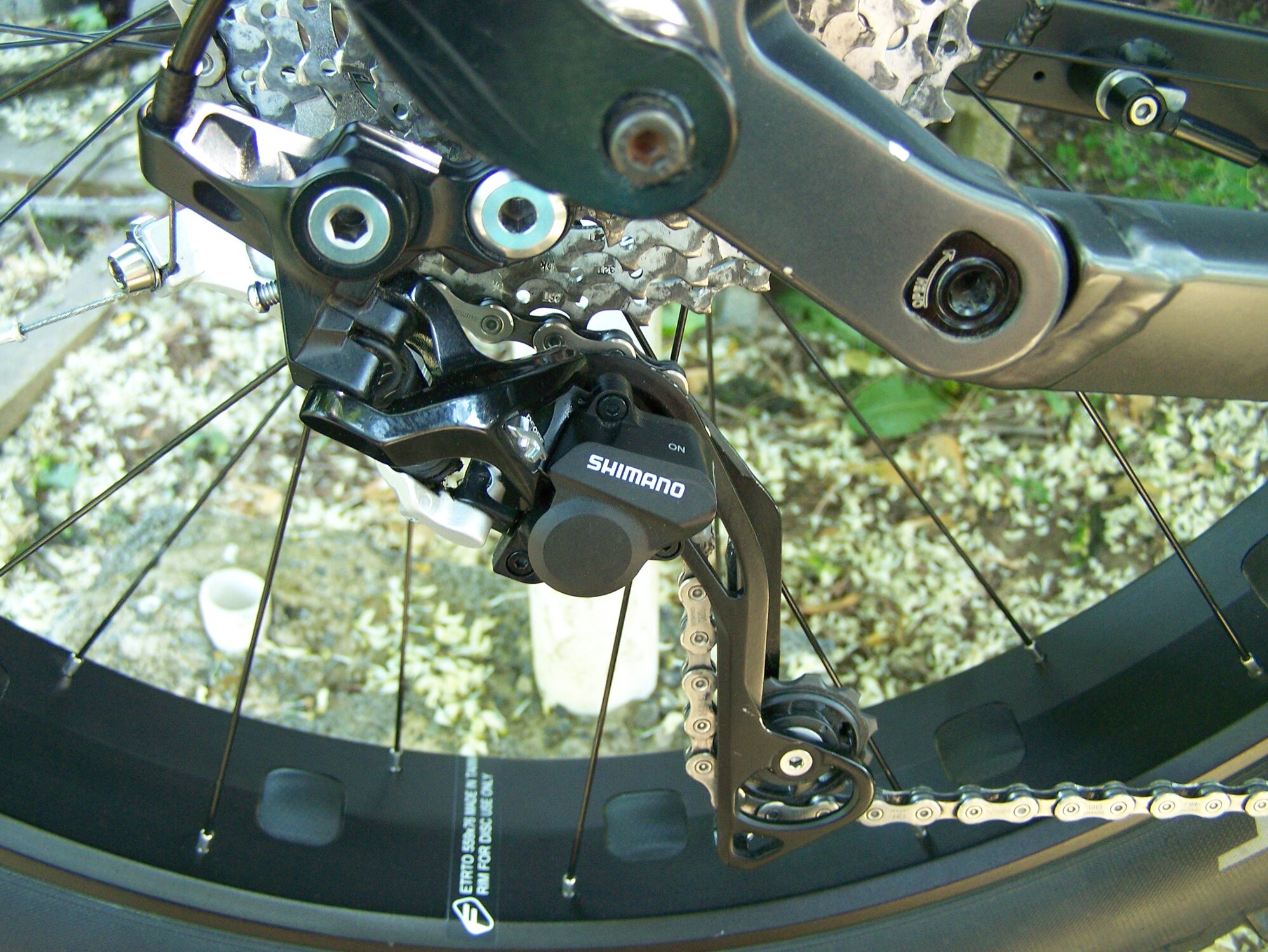

I have the same Shimano XT Long Cage rear derailleur on my own 2016 Haibike Full FatSix. It's a top tier derailleur that hasn't given me a lick of trouble. I replaced the first one after 11 thousand miles just for the heck of it as I needed to replace a severely worn front chain ring and stretched chain. On the newer chain, front chain ring and second rear derailleur, I am working on closing on 17000 total miles.
I look at your picture here and I believe just by what I see here, you are in 2nd gear and the derailleur body (the black portion) is riding FAR too close to the cassette cluster. If you were to shift into first gear (the biggest rear cog), it does appear that the derailleur is going to hit the cassette.
Please follow the below Park Tools video on setting your rear derailleur. Set the limit screws and the "B" adjustment screw according to the video. Check the clutch to ensure it is loose when it is set to off, and tight to when the clutch is engaged. Often, the internal spring can rust or get bound up with gunk and dirt and needs to be cleaned. If the high or low adjustments are off, it can throw the derailleur into the cassette, damaging it; or it can throw the chain completely off. If the B adjustment is off, the top derailleur cog can collide with the #9 cassette cog, damaging the entire derailleur. I do wonder if this is what is happening.
Fine tune the rear derailleur and I do believe you will be fine. No need to reinvent the wheel with a short cage or another derailleur brand. The XT is a good one. Ensure your existing derailleur cages are not bent, if in doubt, replace. Carefully look at that hangar and ensure the derailleur is mounted properly onto it. Make sure the chain is not stretched, if in doubt, replace. Ditto the front chain ring if you have high miles and teeth wear in the chain ring.

That is correct about the B screw, and the chain is a bit too long. The lower tensioner pully is vertical to the cage. It should be under greater tension and at a forward angle. It is as if a 116 L chain was installed on a 114 set-up. Good eye Mike!

Poor man's bike stand.....after replacing my front chain ring, chain and new rear derailleur, I needed to set the High/Low and B adjustments according to Park's video. Instead of investing in an expensive bike stand, I just used a 3 dollar Harbor Freight strap and used it on my homebuilt boat's tarp frame (made of 3 inch pvc pipe). Ran it under my saddle and raised the rear tire off the ground. You want the back tire up in order to make your adjustments while shifting on the fly. Use your eyes, use your ears. Your ears will know everything is perfect when everything is whirring along with no clicks or clacks, just a nice, smooth whirring motion.

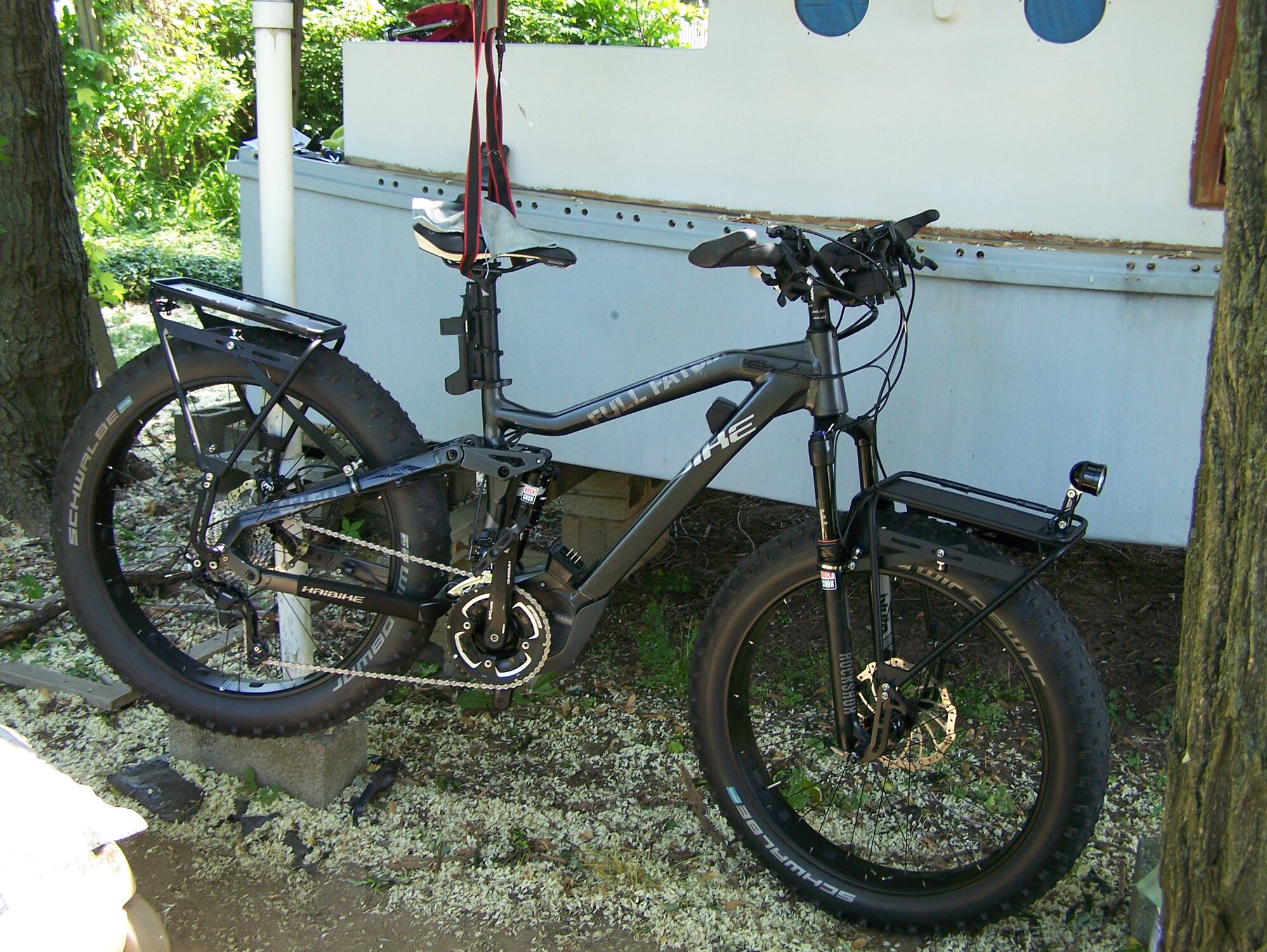

2016 Haibike Full FatSix, Shimano XT derailleur with chain tension clutch. If your cages are bent, replace them. They are available at online bike suppliers.
