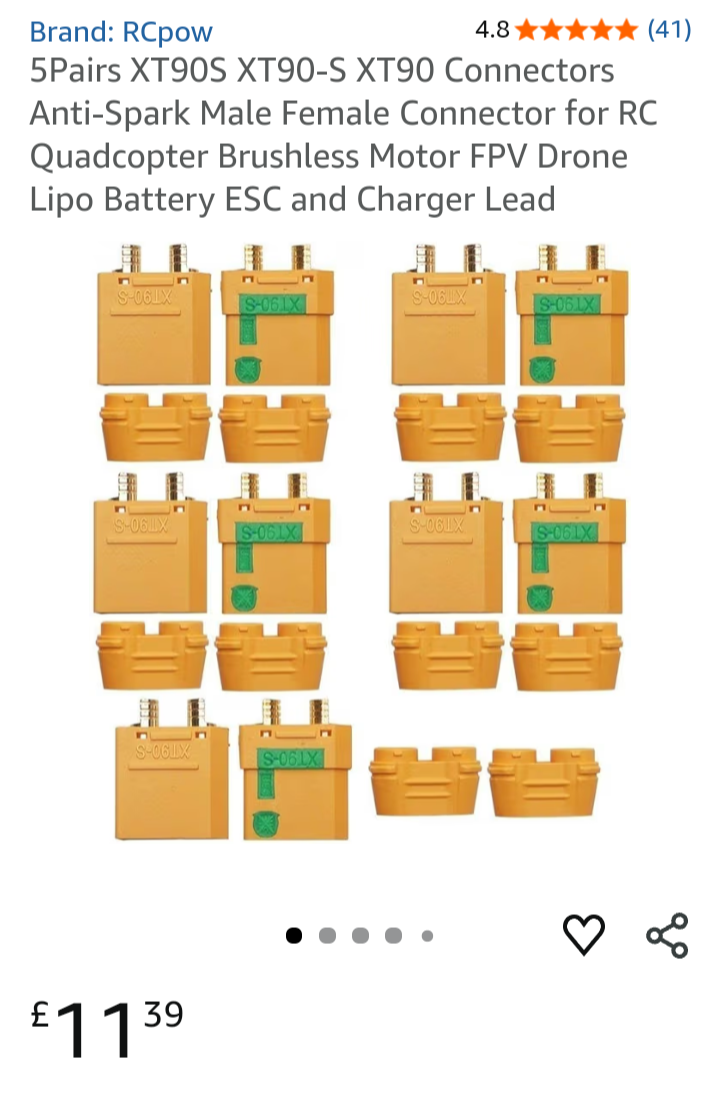

No. I believe they only make the female in anti-spark. So note that the adapter you found is a gender bender as well as anti-spark. You will need to change the gender of the other connection as well.
I would get the XT90 pigtails, cut off the XT60 connectors and splice in the pigtails. If you are not comfortable soldering the pigtails, you can buy butt connectors and crimp them.
https://www.amazon.com/Connectors-I...1-1-spons&sp_csd=d2lkZ2V0TmFtZT1zcF9hdGY&th=1
https://www.amazon.com/XT-90S-Conne...8-2-spons&sp_csd=d2lkZ2V0TmFtZT1zcF9hdGY&th=1
Thanks So I do not need to solder I got below Items
