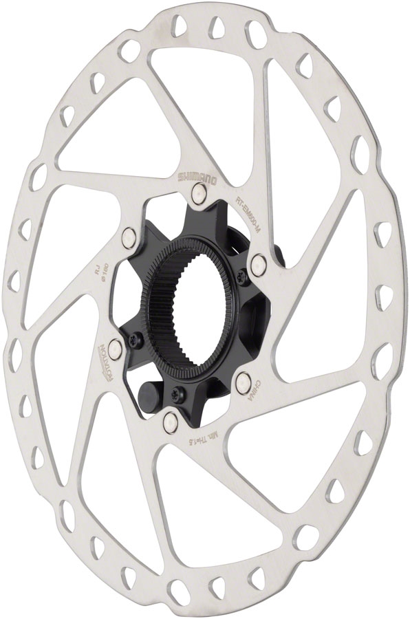

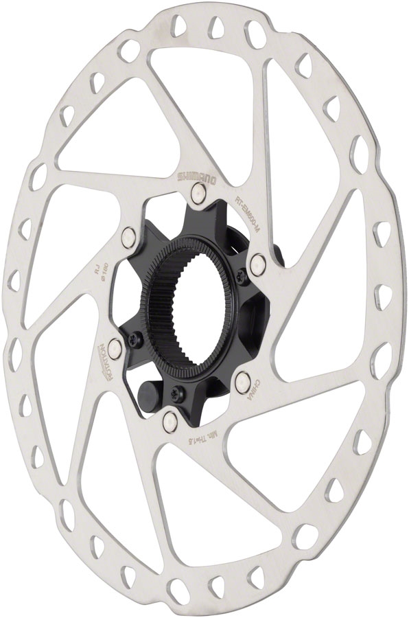

It is very hard to see on the inside of your rear brake rotor. It is a small magnetic disk, less than 1/2" in diameter, embedded in the the rotor concentric with the ring of rivets that attach the steel to the aluminum center lock spider. It is the small black thing at 6:30 in this photo
Thanks for the good picture. It is there and seems secure. I will let the LBS figure it out.
