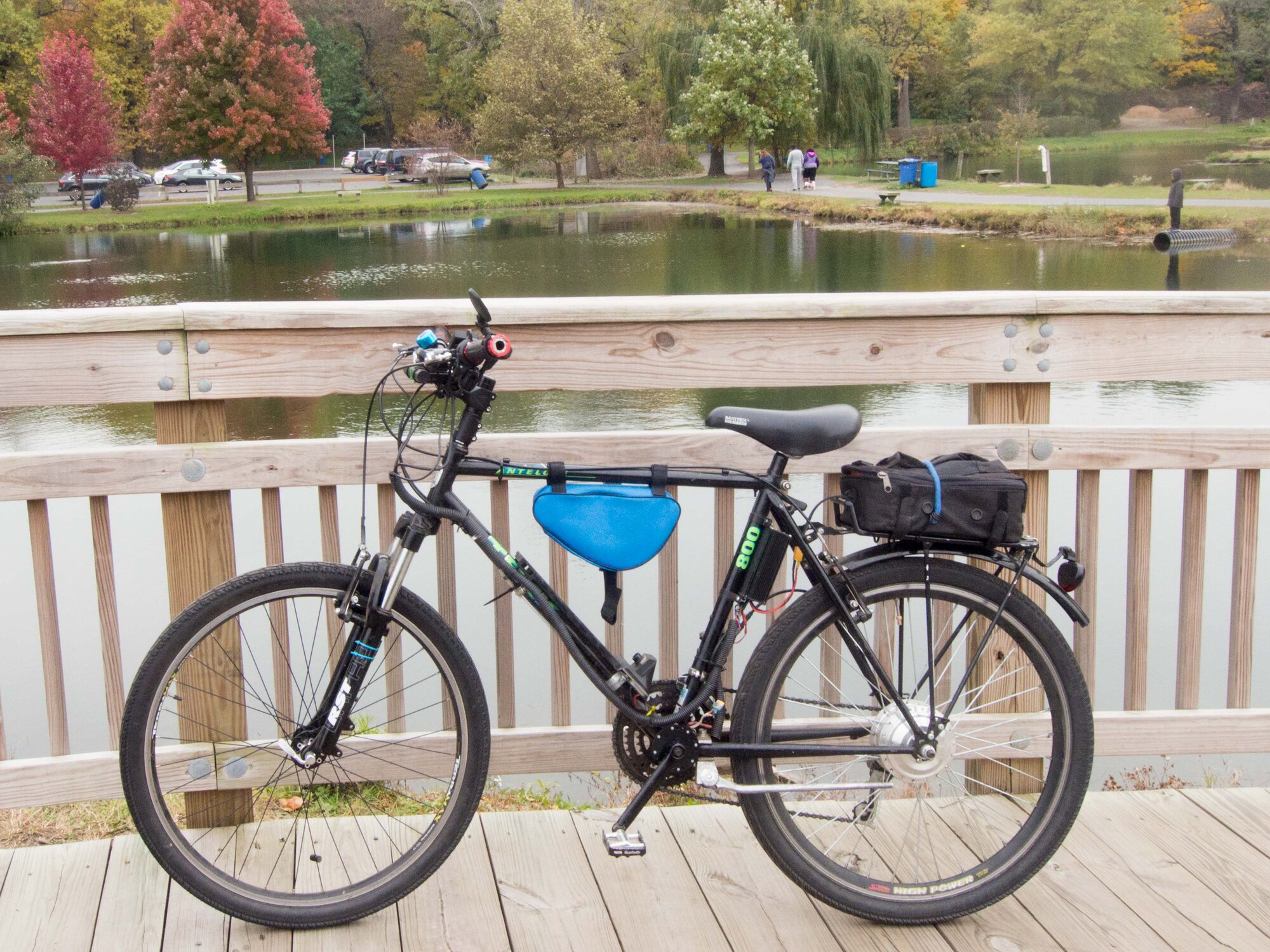

This one is a 2021. 16.05Kg, 80Km, 60/40 weight distribution to the rear for traction and handling up front. Center of gravity low, 8mm above the hub in the rear and 9mm above the hub in the front. Check out the messy wire nest at the HB and downtube. If you are interested in seeing some look at PedalUma.com some time. This one weighs 35.38 lbs and goes up to 50 miles on a charge with 80Nm of torque.

Let me start by saying I have never built a ebike conversion. I have the skills to do so. I have the tools and a great workstand all set up in a nice home bike shop in our basement. I am retired and have the time and I love to work on bikes. I like well integrated, well finished clean looking equipment. I also like the ride experience of a well designed and built mid drive with torque sensor. As I understand it, Bafang makes a decent mid drive conversion motor with a torque sensor as an option. I live in Bellingham Washington, a hilly town with hills to rival San Francisco or Seattle. All my buddies with hub motors regularly get stalled half way up some of them and have to walk their heavy bikes up hill the rest of the way while things cool off.
All this goes to my recommendations, if you want to build a conversion ebike, you should
  1. Make sure you have the needed tools and space to do the work
  2. Make sure you have the time to start and complete the project.
  3. Get used to watching lots of how to videos on Youtube, if you are not already.
  4. Keep asking lots of questions here of the DIY community here and elsewhere.
  5. Learn how to filter answers from people who aren't addressing your questions but rather trying to get someone else to do what they did for self validation.
  6. Based on where you live go with a mid drive motor with torque sensor.
  7. Try to mount your battery inside the frame's triangle, either on the downtube or the seat tube
  8. Keep the center of gravity low and centered between the wheels.
  9. Post a some pictures of your new pride and joy when you are done.
  10. Share with us what you learned in the process. Pay forward what you learn here by sharing lessons learned.
  11. Let us know how things are going with the new bike after a month or two of riding...is it performing as expected? Any problems, hiccups, gremlins or snafus?
  12. Make sure you are having fun in the shop and on the road.
