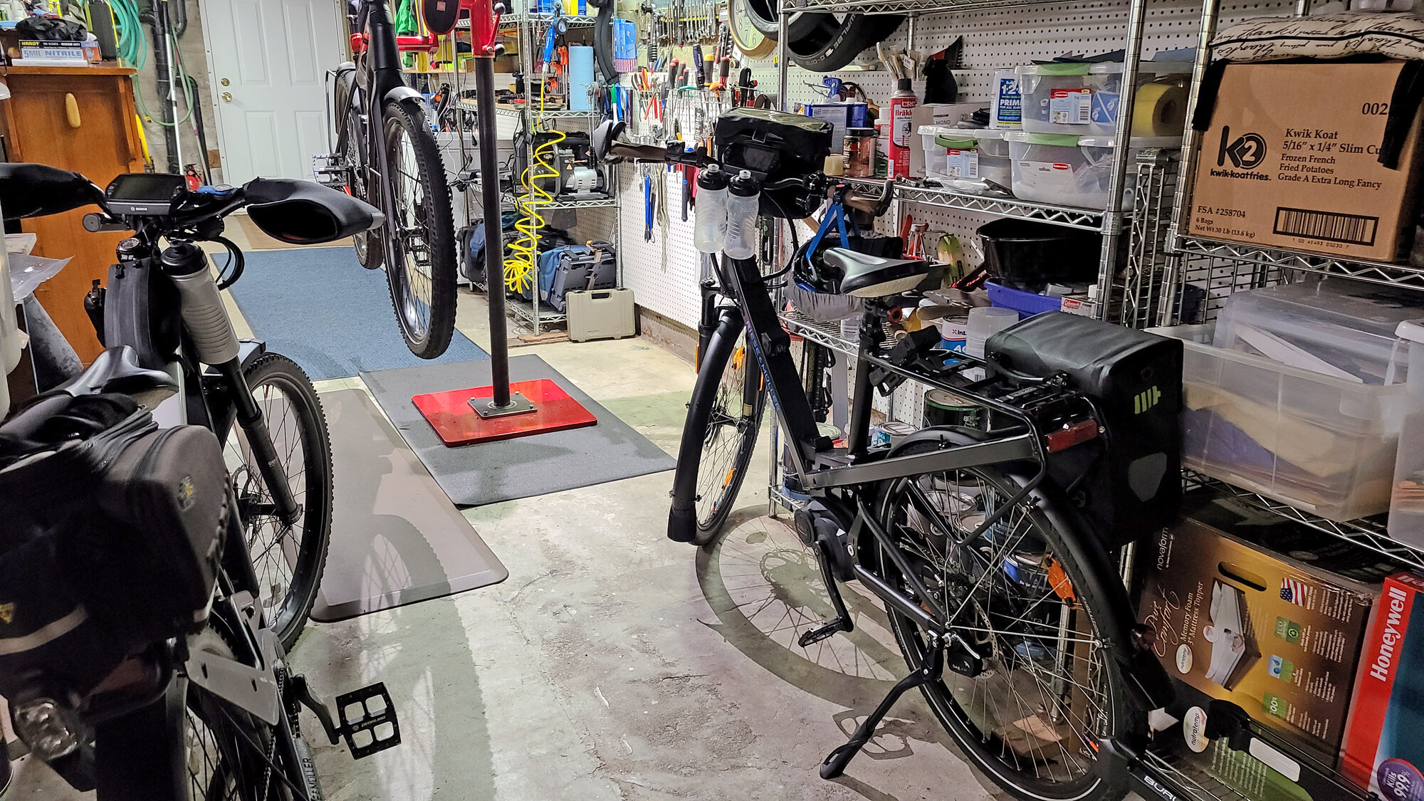

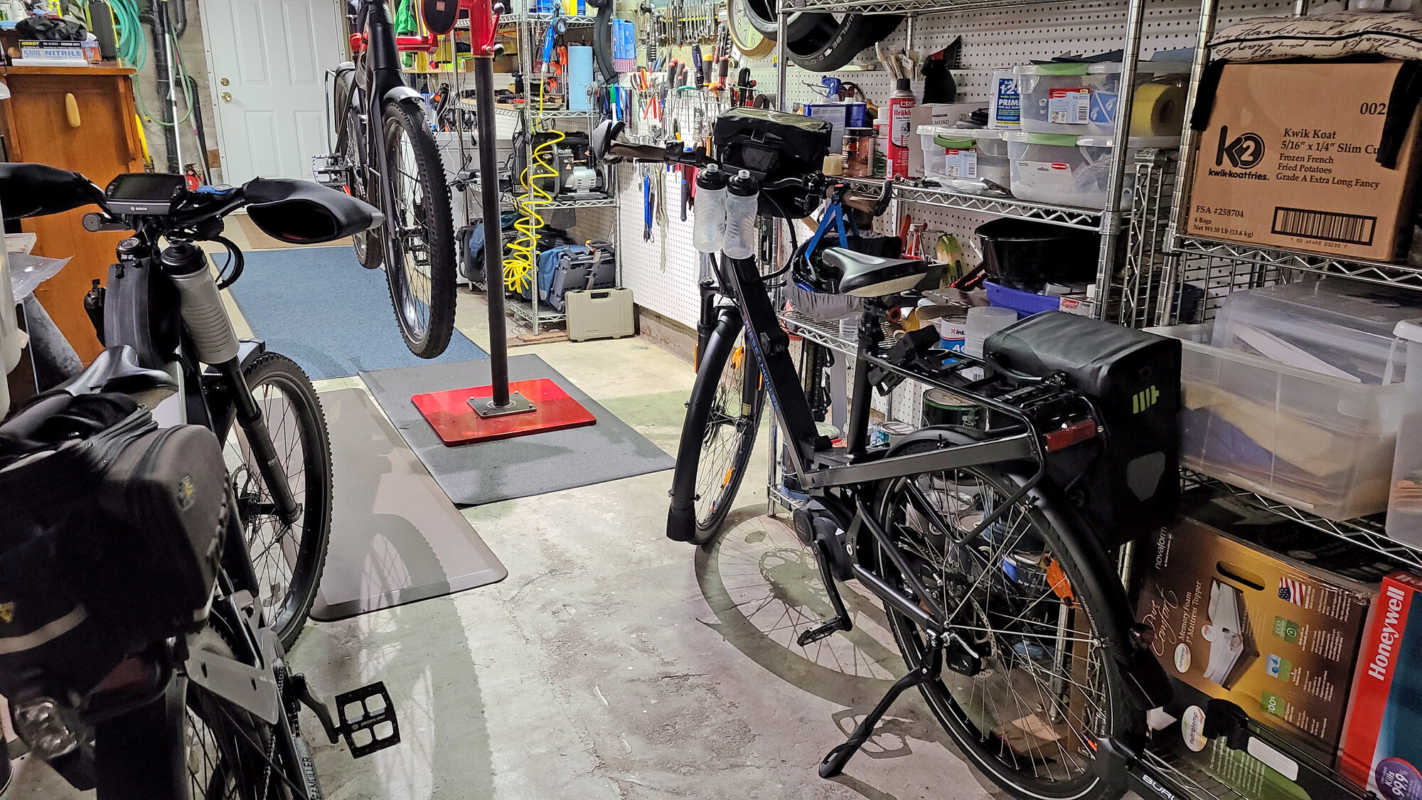

Let me start by saying I have never built a ebike conversion. I have the skills to do so. I have the tools and a great workstand all set up in a nice home bike shop in our basement. I am retired and have the time and I love to work on bikes. I like well integrated, well finished clean looking equipment. I also like the ride experience of a well designed and built mid drive with torque sensor. As I understand it, Bafang makes a decent mid drive conversion motor with a torque sensor as an option. I live in Bellingham Washington, a hilly town with hills to rival San Francisco or Seattle. All my buddies with hub motors regularly get stalled half way up some of them and have to walk their heavy bikes up hill the rest of the way while things cool off.

Jealous, your shop actually looks organized. Mine looks like someone has randomly strewn dozens of
tools every which way, no order whatever, visual search only. If you´ve ever read ´Shoe´ in the comics,
that´s what my desk looks like only worse.
