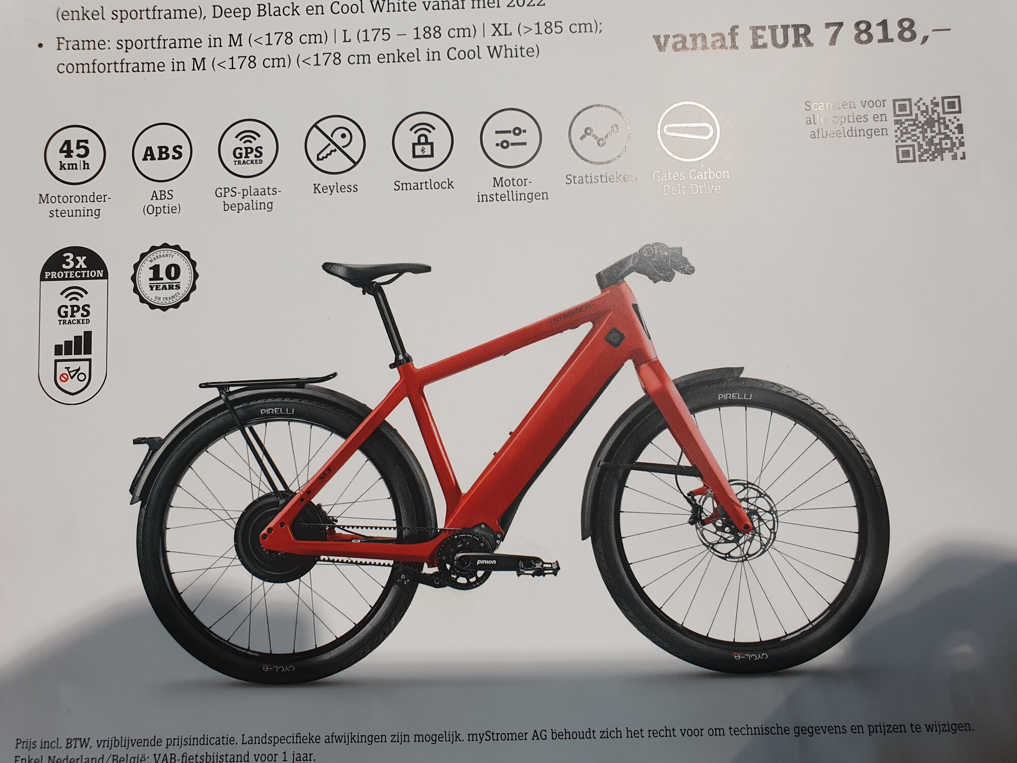

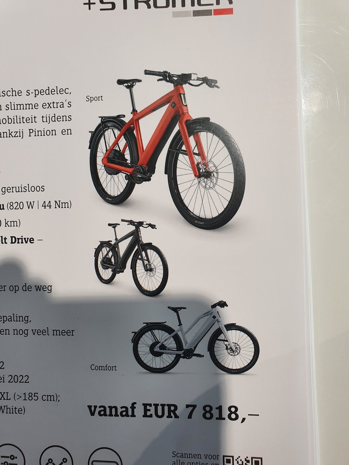

Well here it is! The soon to be announced new Stromer ST3 with pinion C1.9 and gates carbon belt, with optional ABS, Wren suspension fork, and Kinekt suspension seatpost.
About 9100$ without options.
820W 44 Nm
Launch edition red, after that regular black & white
This is going to be fun!

Finally. We have been asking for a pinion hub setup for a long time, with this setup it can finally be called maintenance free plus it will have a huge range. Since the belt is only carrying human input it should last a very long time.
