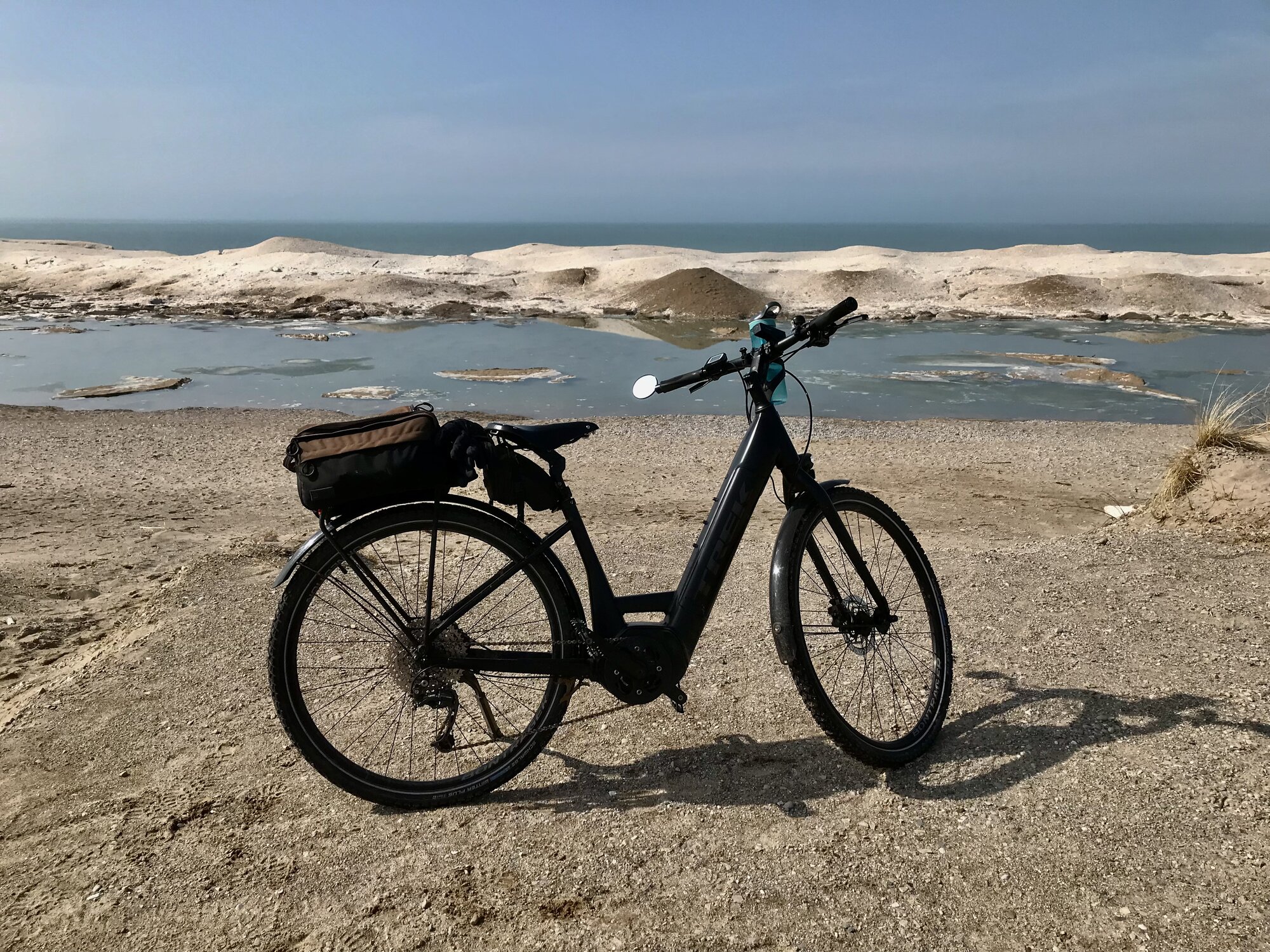

I am 67, short and overweight (but improving by 18 lb since I started biking). My Trek Verve +3 came with a pretty good Bontrager saddle and I added a Redshift suspension post (lots of info on this forum about the benefits/disadvantages of various suspension seatposts). My riding position is pretty upright. I also added Redshift’s flexible stem, which helped reduce vibration to my hands. For sure, my butt hurt for a few weeks when I got the new bike as I hadn’t been riding in a while. I put a more padded seat on, then reverted back to the original after a few weeks as it became the more comfortable one.
I would still get a sore butt on some longer rides (I generally do 25 to 35 km daily) and last summer, I switched to a Brooks B17. It took a few hundred km to break in, but is now beautifully comfortable for me; I seldom notice any discomfort and no longer wear padded shorts.
As m@Robertson noted above, a Brooks isn’t for everyone, but for me it was the final piece. Getting close to 11,000 km on my bike now, so my butt is fully experienced :)
