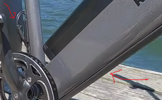

Updating the new Rover shouldn't be THAT difficult. The controller looks to be where it's been for a long time. The question lies in what connectors are being used for everything. The pictures I've seen LOOK like a KT controller will work (Bolton "kits" use KT controllers), but they are not likely going too have a brake light built in, and until I see better pics, there's no assurance regarding the motor or battery connectors being correct either.
I don't think that rather small box is the controller, cables are too small . More line a junction or test box maybe .
The second pic is a single frame of Court's review.
I suspect the controller in the down-tube. Remove the cover plate on the underside.
A 35A controller may be too large for the opening. Heat also an issue.
There are ebikes with controllers in the motor so might even be in the battery. One geared motor has the battery and controller inside the motor.
If Rad has made anything hard to work on or extra expensive parts to replace it will really cost them on warranty repairs. Also more unhappy customers. They need to gravitate towards easier to replace controllers with locking mechanisms.
RAD is trying to get more money for their service now; "making it easy" is no longer their goal. Unfortunately to support their mobile service and on-going business they are now more interested in proprietary or at least non-standard components.
Re: small box, you could be right, but the KT "waterproof" series are pretty small. MUCH smaller than the earlier series. In any case, there's plenty of room to install one in place of whatever that is on the seat post tube. I've messed with the KT-17a through the KT-25a controllers now, and they'll all fit in that area no sweat. Too date, all of them I've done have had to be packed into the down tubes, which really limits you regarding any more controller than what you need.....
