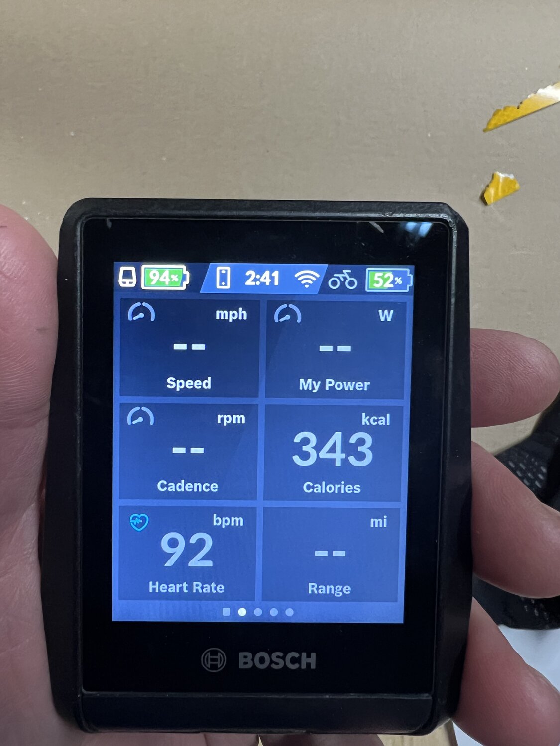

I dont know about the new one but the old ones had under display there is a field for the nyon or kiox display battery. there should be one somewhere.

Here is where it shows in the nyon when it’s off the bike top left
This Kiox does not have the second battery display like the Nyon.

you only get that when I remove it from the bike. so check and see.
