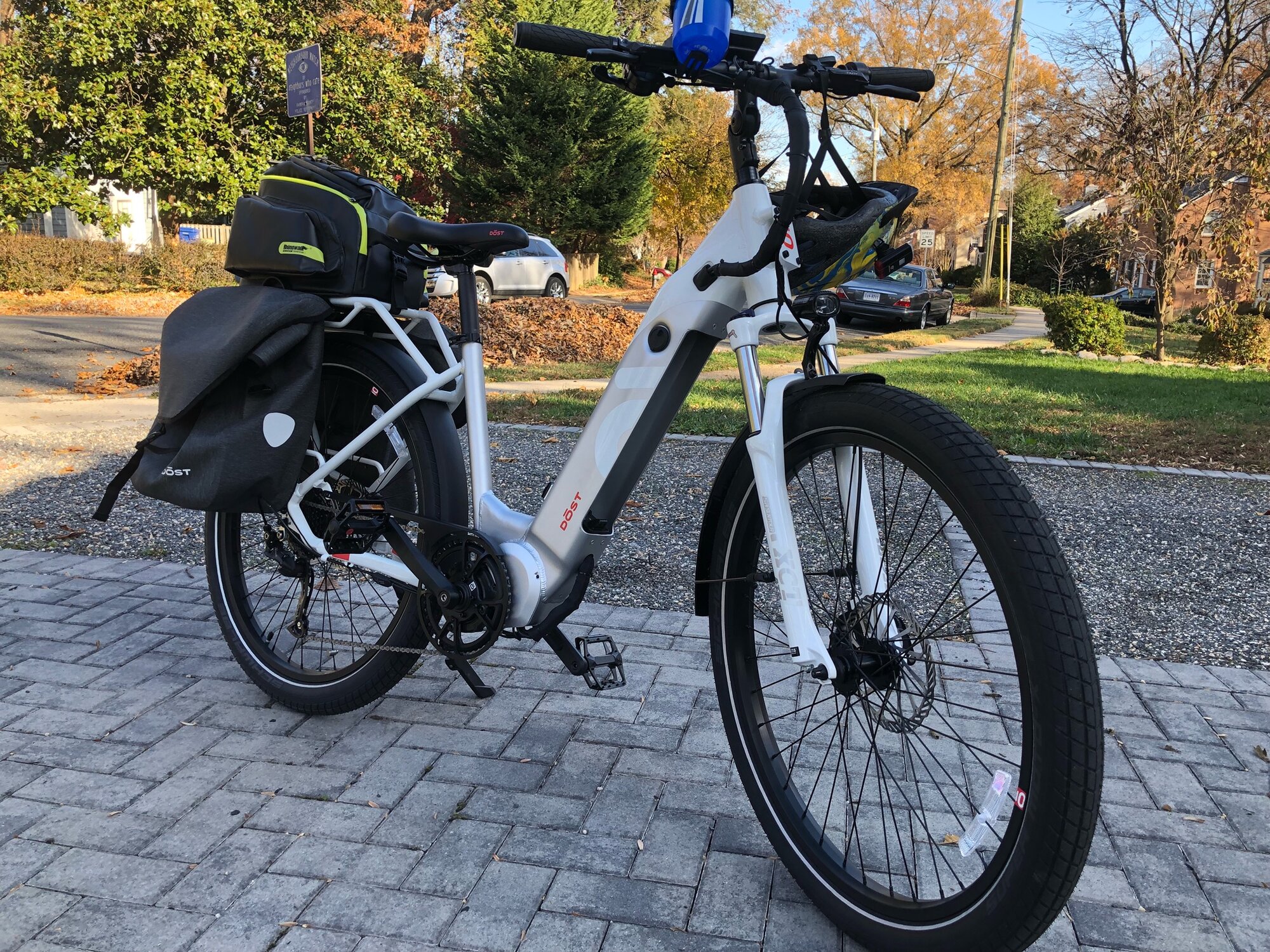

Just got my Drop. As there do not appear to be too many user reviews on Dost, I thought I'd post my first impressions. Here it is (without the battery as it was charging in the house), the Dost panniers (which are nice), some trunk bag I had previously, and generic water bottle holder I already had.

Putting the bike together was easy, especially if you have watched the Dost videos on YouTube. Just straighten the handlebars and tighten them, then put on the pedals with the included wrench. The kit came with some lock washers, but I have no idea what they are for and didn't use them.
Initial Observations​
The bike is heavier than it looks. I hadn't really given that much thought, nor had I realized the tires are a bit wider than a typical commuting bike. Both of those things give it different handling that make it feel less nimble.
The brakes seem a bit soft, and, for me, might need to be adjusted to have a shorter pull as gripping them with gloves is somewhat of a stretch. Also, the brakes seem to make a weird vibration noise when engaged at speed. I've got a support request into Does on the brakes. They aren't unusable by any stretch, but just not as good as I would have expected.
The rear cargo rack is awesome. With the rack on my Kona, I had given up on using the trunk bag because it moved about so much that it was distracting... not to mention in the way of panniers. The Dost rack's simple side drop bars make using a trunk bag with panniers simple. It also gives me confidence that it won't fall off.

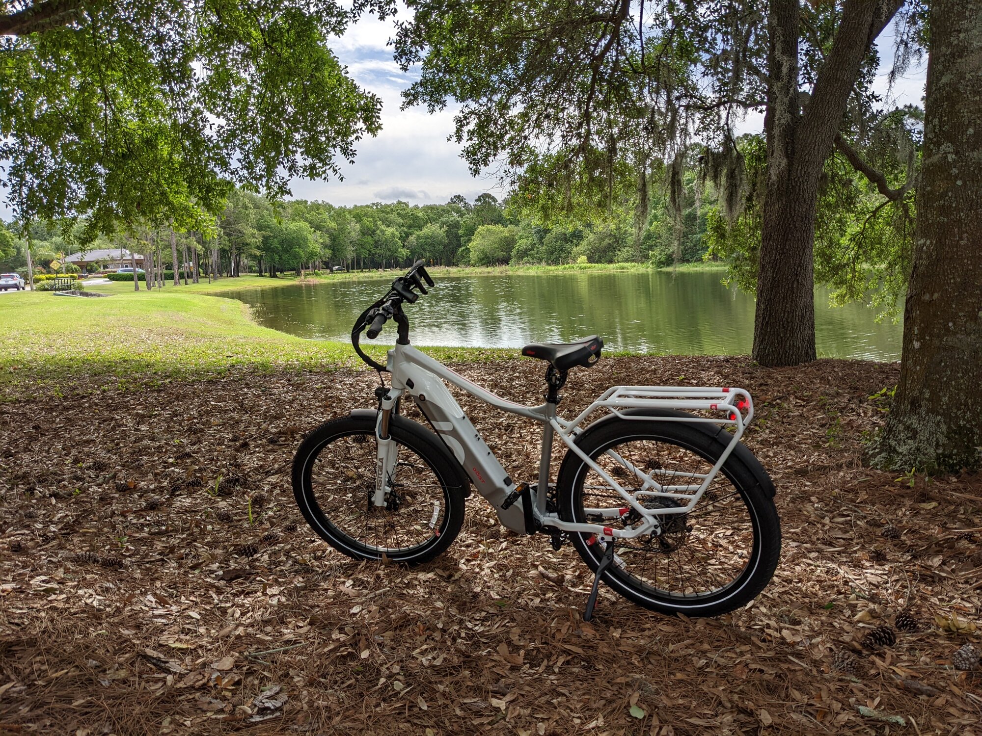

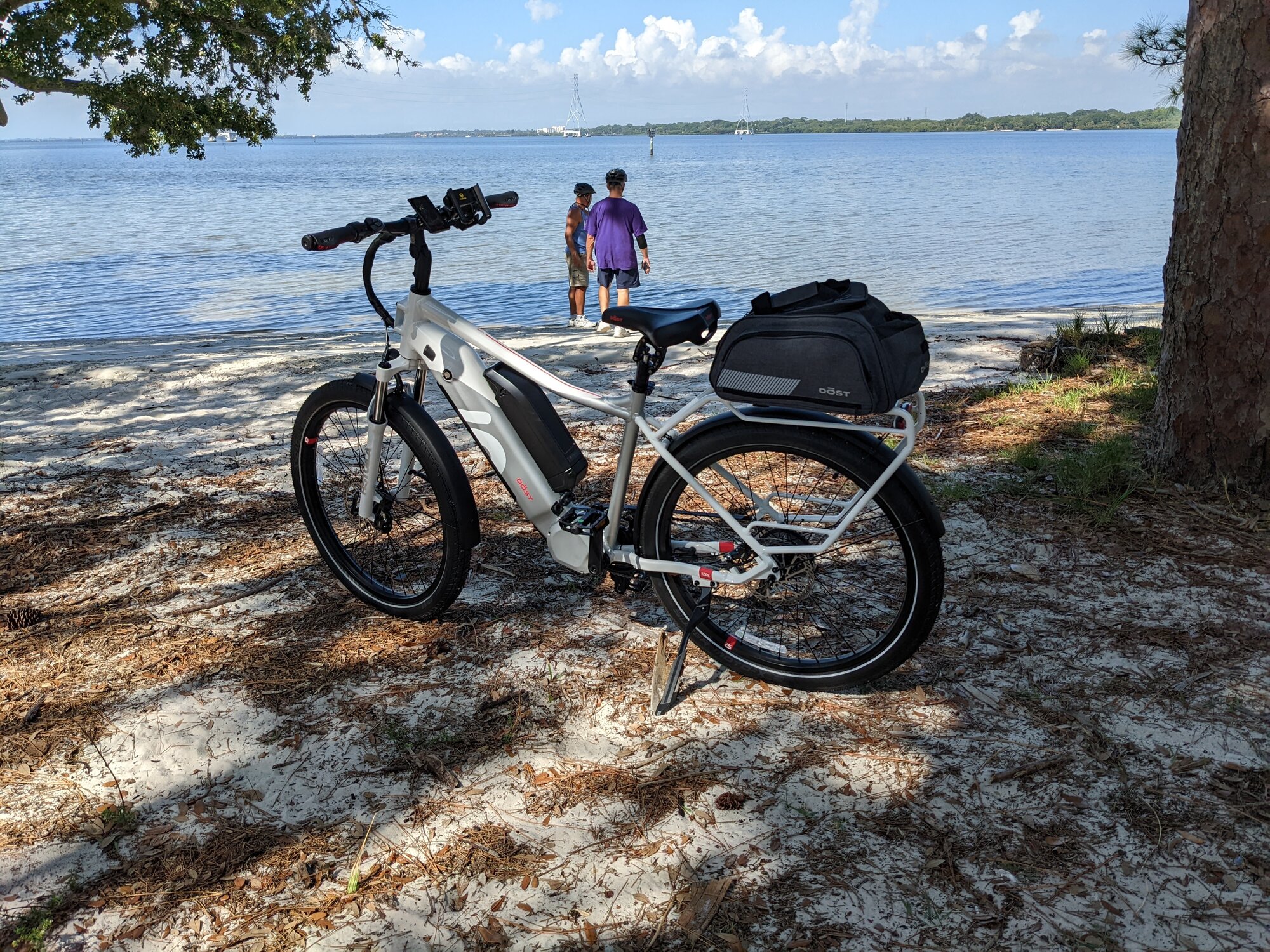

I received my Dost Kope at the end of this past February. It is s my first e-bike and I absolutely love the power and quality of the bike. The customer support I received could not have been better. My bike is chain driven not. CVT.
