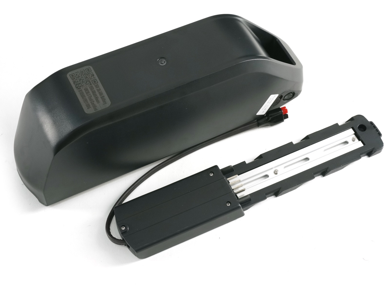

I have two identical good quality 52V, 20 AH Reention DP9 downtube batteries that I purchased from Grin Tech.
I charge both to 58.8V before a ride and discharge the first to 20% or so. When I switch to the second battery a couple of hours later, the voltage has dropped from 58.8 to 54.6 even though the switch on the second battery is turned off and stored in a pannier. I thought it was a bad battery at first but both do the same thing.
When both batteries are fully charged and placed on the shelf, neither looses more than a few tenths of a volt over time. The voltage drop only occurs during a ride when the spare battery is carried in a pannier or rear rack bag. The battery in use discharges normally with no sudden voltage loss. It appears that motion or vibration is causing the drop in the unused battery.
BTW, I also have several 52V, 17.5AH rear rack batteries that do not loose voltage when carried in a rear rack bag or pannier. The problem only occurs with the DP9 downtube batteries.
Any ideas?

DP9 is a typical downtube battery. but big.
