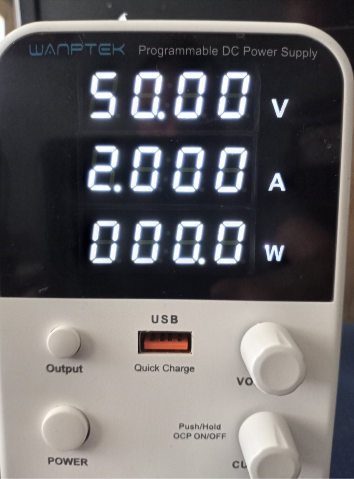

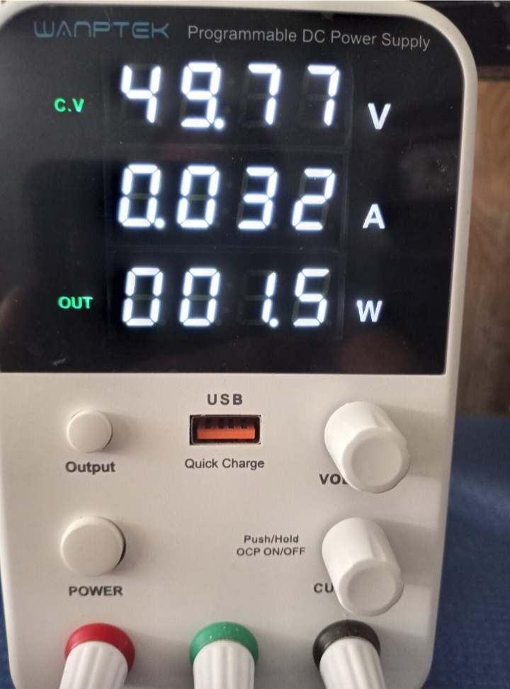

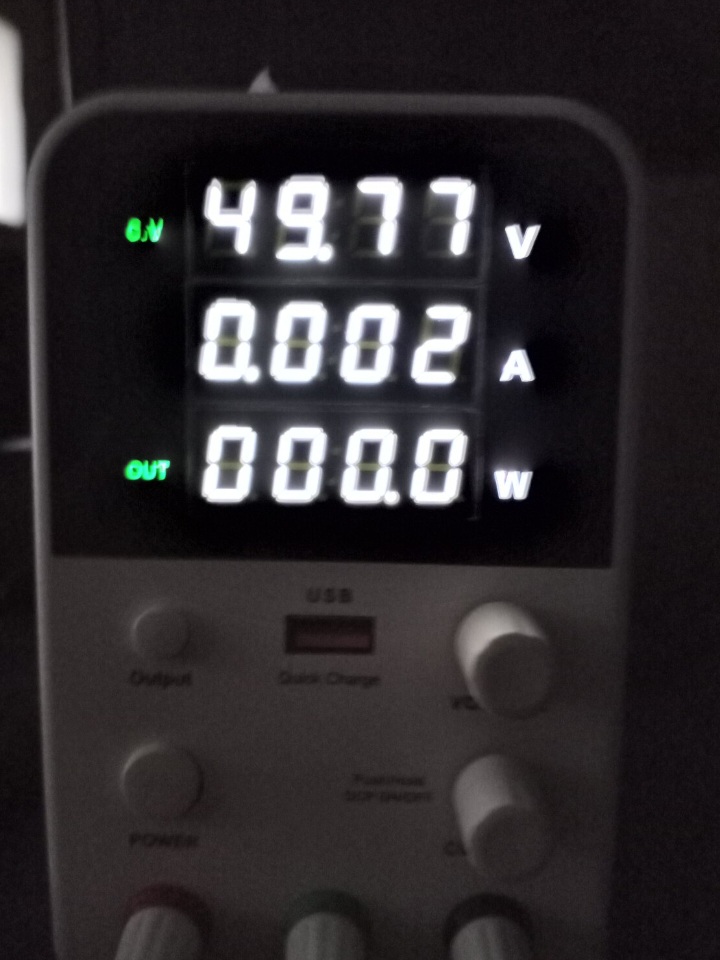

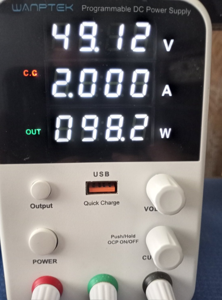

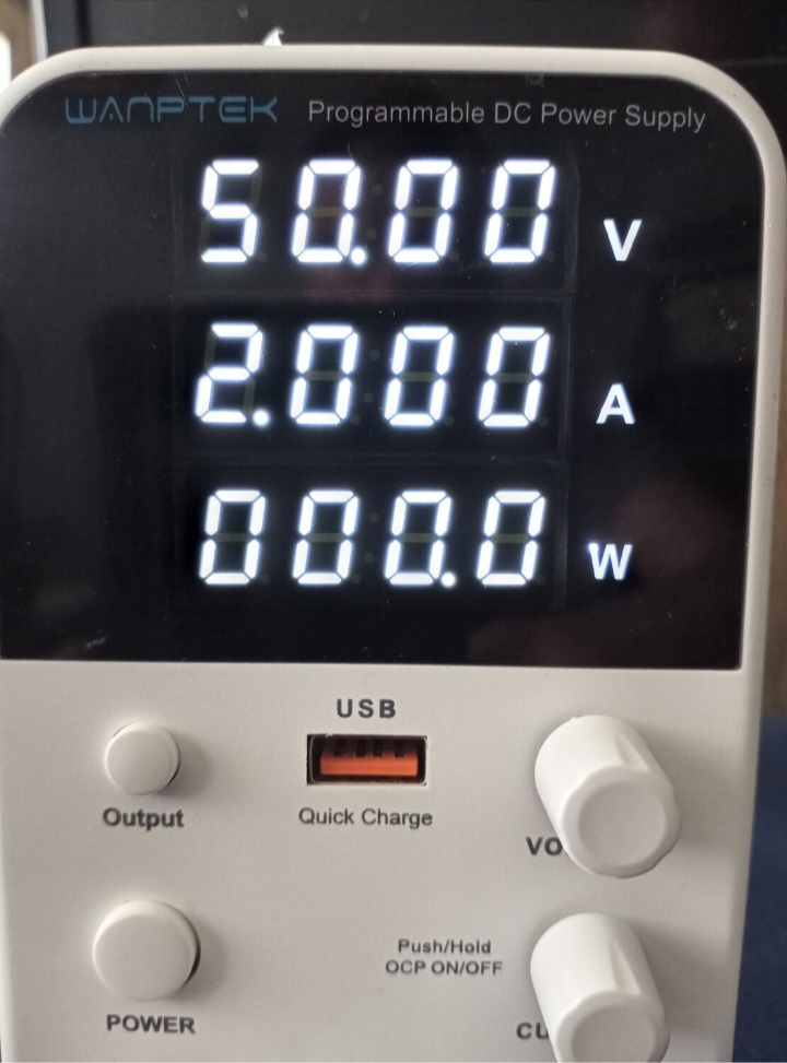

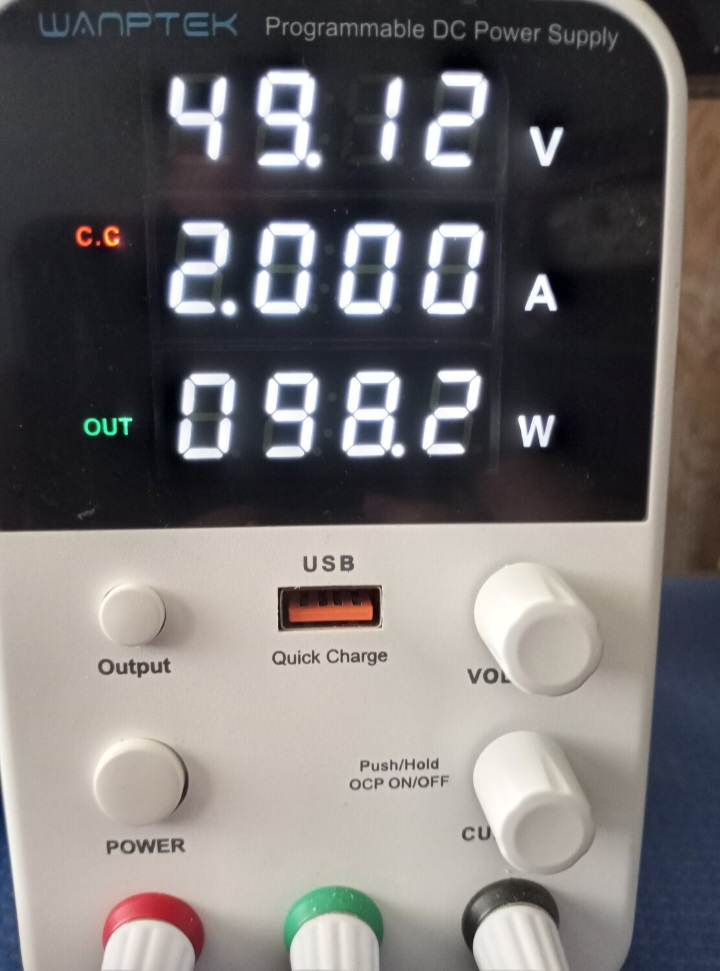

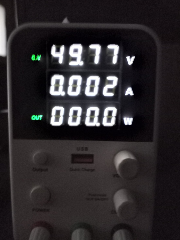

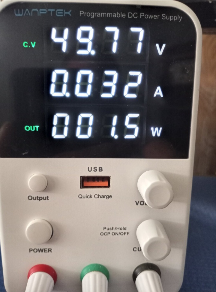

I set my power supply to 50.00 volts (for my 48 volt battery) and set CV at 2 amps.
I let it charge until the current and Watts drop to zero.
My battery should be balanced at 3.85 volts per cell group.
