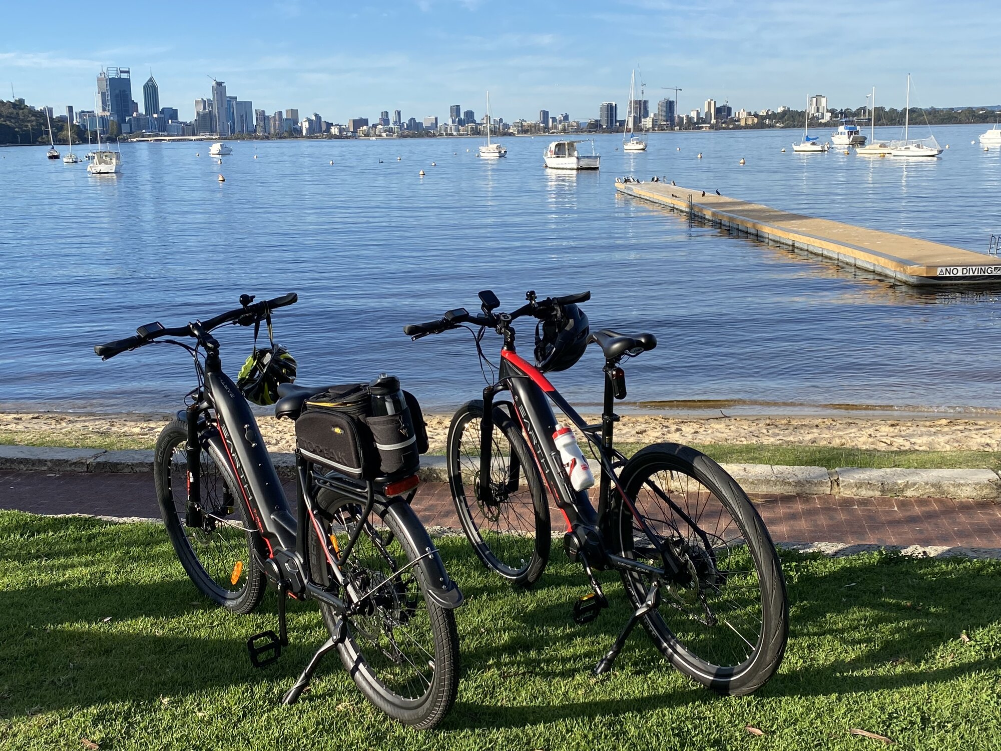

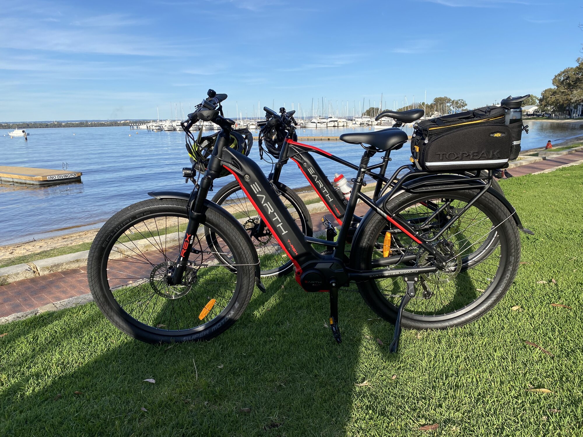

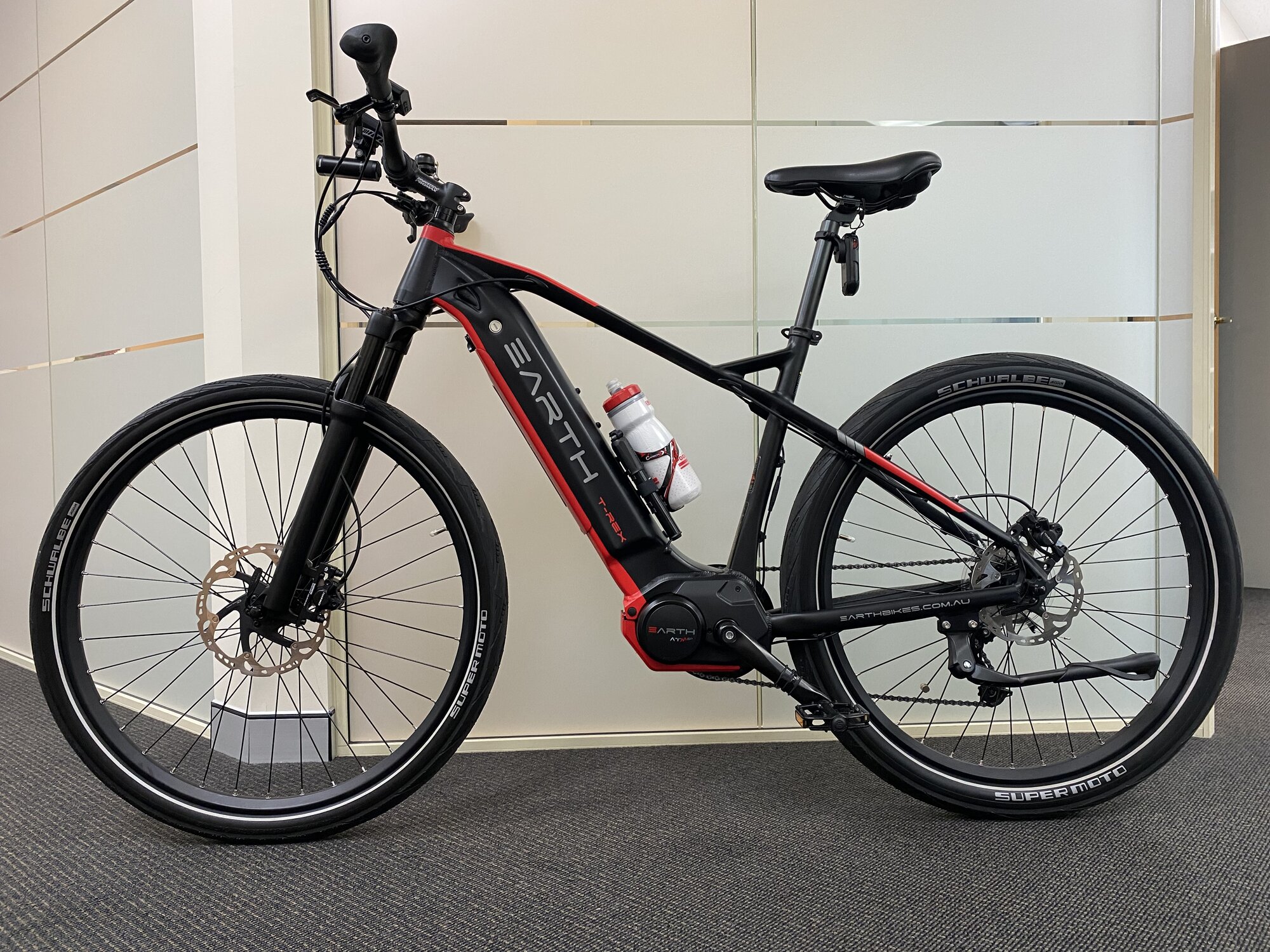

Pics of our bikes for attention
View attachment 165137View attachment 165138View attachment 165139
