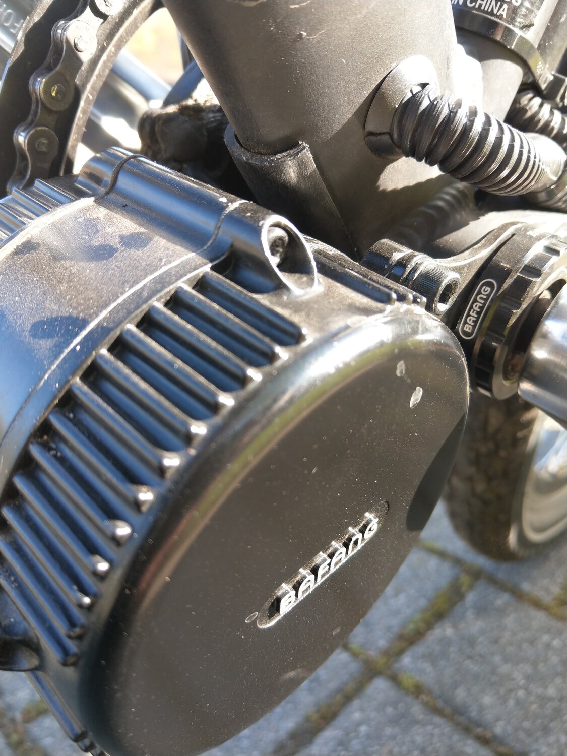

Ok so I received the new bike and I'm stoked. Removing cranks and bottom bracket went more smoothly than I anticipated. However an issue has arisen (if it's an issue at all).
There's a piece of welding on the bottom bracket which obstructs the motor from hanging tight against the downtube, making it so that the motor hangs quite low. Here's a video.
Would this bit need to be trimmed down or is this no biggie at all? Please advise!
In general, I would never trim down a weld. I would guess its purpose is to relieve stress on the unsupported edge of the downtube. Take it off, and you might get stress cracks coming off the end.
So you're saying just let it sit tight against the weld then? It just looks a bit low compared to other builds to be honest.
It's nice to put a piece of hard rubber/soft plastic between the frame and the motor.
Doing this just above the weld might allow it to ride over it... Maybe?
I used a sliver of sprinkler funny pipe.
I did some more research and apparently most Marlin riders have trimmed or cut that bump down at least a little bit in the middle to give the motor some more ground clearance.
As I don't wanna risk hitting a bump and potentially breaking it, I'm thinking of filing it down a bit as well (I don't have a cutter disc or grinder). But then again, the guy in this video seems to know what he's doing and he doesn't seem to care about it hanging low like mine does. So maybe it's ok after all?
A bit of rubber between kit and frame is a good shout, thank you @Gionnirocket!
Everything on the handlebars is mounted and ready to go, also mounted the battery which I'll be securing with some heavy duty velcro stretch straps cause it has too much wobble for my liking. I just need to pick up some longer screws and washers to go through the mounting plate. What size/length screws are recommended?
It's hard to tell how big or if it is a problem with the info provided but I wouldn't stress about it.
First ask yourself where do you intend to ride this bike?
Then mount the motor and measure the actual ground clearance for a better understanding if it really has any impact potential.
For some reference... Mine has 26.5 cm clearance and this is on a low end fs mtb set up for comfort. I mostly ride paved trails but do occasionally ride slowly through root strewn trails. I've taken it off some pretty large curbs in both directions and it's walked down 2 flights of stairs on every ride. I've yet to hit the motor.

On my install...
1. I sealed mine off with heat shrink and tucked in in the wire Loom along with the other cables. I did not cut them.
2. A water tight Butt Splice that I then put heat shrink over each wire. If you stagger them you can make a tighter bundle.
3. Spacers are typically inexpensive.. But more importantly is maintaining a good chainline to the rear cassette. You should be straight front to back when in the middle of the rear cluster .
Just in case others end up facing this issue - i trimmed the weld down with a dremel I borrowed off someone but only ever so slightly, and mostly in the middle of that bump. All good so far.
