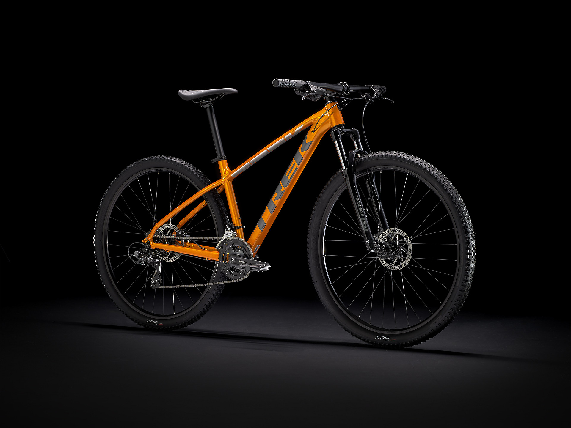

Rather than adding to other people's threads I thought I'd post here as I'll undoubtedly have questions and can share my experience this way. People on here seem to be helpful, accommodating and knowledgeable so why not. I'm based in London and have ordered a 2021 Trek Marlin 5:
I also went ahead and ordered this BBSHD kit. Looking to do a bit of cruising about, and ride the thing to work when everything ultimately opens back up.
I guess when payday comes I'll pick up some tools, spacers and the like as well as I cannot bring myself to spend any more £££ this month :eek:.

Sounds like a nice project.
I highly recommend that one of the tools that you get is the programming cable... Relatively inexpensive and well worth it.
Good luck and post pics of the new ride.
