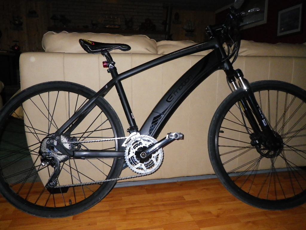

i put a little wider tires on.i still have to play with the air pressure.it takes the train tracks now no problems.
Nice Steve, which size tires did you get? Can you read the info on the side because a few people were asking about how large the tires can be for Easy Motion bikes and still fit. They look great and I'm glad they feel better... That makes a big difference when riding at higher speeds :)
i went with the resist nomad 700x45.they are cheap but the reviews liked them for the price.they go on super easy.thought maybe to easy.but there holding out.people use them in gravel etc.think they look bigger than what they look in the pic.they look really nice on the bike. would like to try big apples also.
