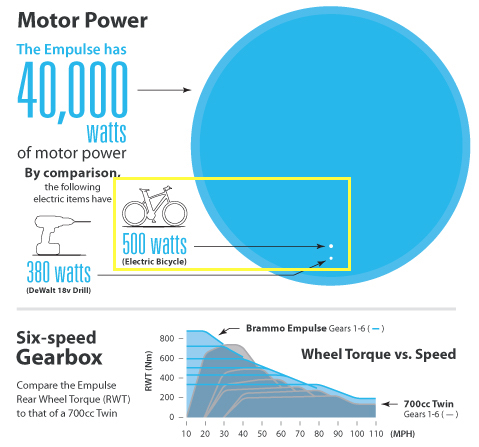

Polaris acquired Brammo electric motorcycles, which manufactures NMC batteries. If Polaris adds NMC batteries to Aapex eBikes, Polaris could leapfrog the entire eBike industry. NMC is used by Tesla, BMW and most EV manufacturers. NMC can cut battery weight in half and double power of traditional Li-ion batteries.
NMC battery advance is what I am waiting for.
