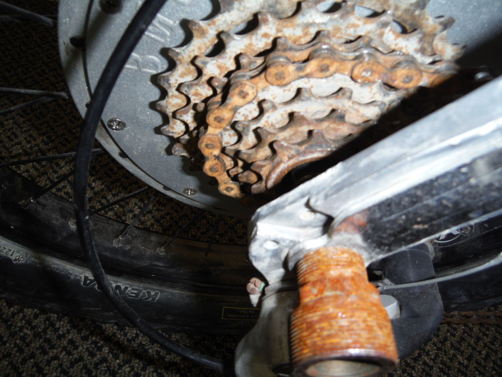

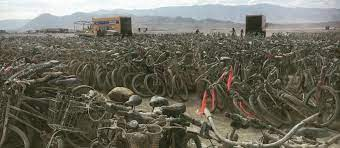

Actually I said "oxidation" which applies to many materials. I make a DOT 5 emulsion which seemingly reverses the effects of oxidation on rubber and plastic components. I came up with the stuff for Burning Man bikes. These will rot before your eyes. The gritty ashen dust is full of salts and bacteria which have evolved to eat metals. Thousands of bikes are abandoned there each year. I will treat bikes before they go, then after they return. Who would have thought that washing your bike gets rid of corrosive bacteria?

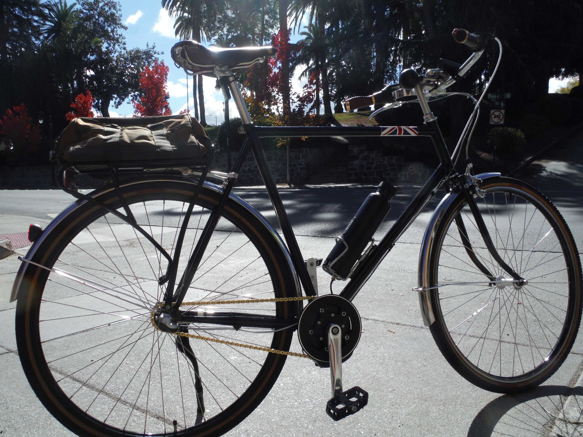

I just winterized this old Polish bike. It is a Crème. I used auto wax, even inside the reassessed hex cap screws. It also got a tire rotation, an IGH service with a cog, a new motor, and a new battery. The new chain is an extra-heavy duty half-link that is lubricated with boron ceramic.
