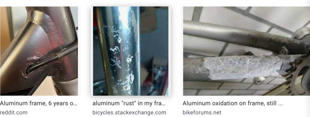

Oxidation of what?
It does oxidize!

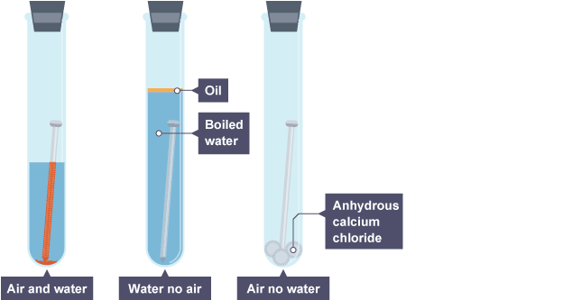

Aluminium oxide is the best corrosion preventing layer known. With iron, the rust penetrates the metal until it eventually turns into a powder. Thin layer of Al2O3 doesn't penetrate the metal. On contrary, it prevents it against corrosion.
(Can you remember Tom what my profession is?)
It is true that a thin layer of inert Al oxide protects against further corrosion on theoretically pure aluminum. Alloys are slightly different. For anyone interested below is a good article on that topic. Bike frames and components are made from alloys and a little car wax helps keep them shinny and clean. Try some in the iron alloy hex screw on the top of a headset, on painted parts, chrome plated parts, and exposed aluminum alloy components. It dose not attract dirt like oil, yet seals frames and components from oxidation. It is okay if you find this un-credible and want to dismiss it.

I mentioned the fact steel actually does rust. Aluminium doesn't. I cannot fail to notice Uma typically makes irrelevant comments based on his very limited experience while the OP explicitly mentioned manufactured e-bikes. That's all, Tomasz.
P.S. Did you know the shiny aluminum foil/film was actually covered with Al2O3? Put it into aqueous solution of sodium hydroxide. It might end up with an explosion (thermal + hydrogen released) when Al loses its protective oxide layer.
