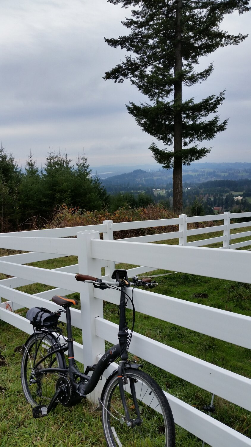

Here is my wife's Dahon Briza folding bike (24" wheels) that I had installed a tsdz2 for her. Total weight including battery is <45#. It doesn't have disc brakes but I haven't found them to be necessary, rim brakes have worked fine for me and my wife. At least one seller has complete kits including battery for $500.

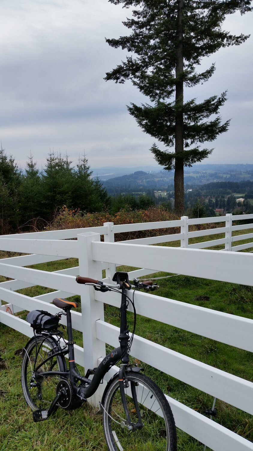

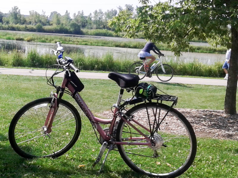

There are all kinds of ways to approach it. This bike went to Colorado with its puny rear motor and passed all the gassed out tourists on their rental bikes at 9000 feet, It's under 45 pounds.

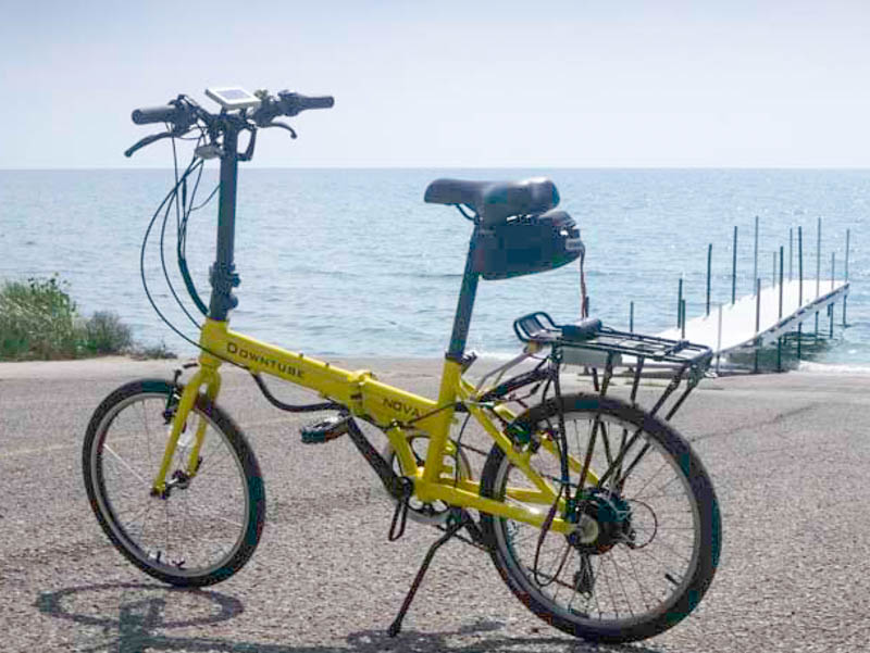

These bikes love riding in the minivan to Florida. Both under 40 pounds.

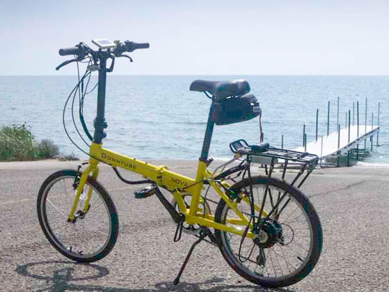

You can have small batteries for short rides, and pack larger ones for longer rides. The only drawback is you can't hide the battery in the frame like you can on a commercial bike, but at the same time, you don't add 5 pounds of aluminum around it to hide it. If the bike already has disk brakes, it's not hard to replace them with hydraulics.

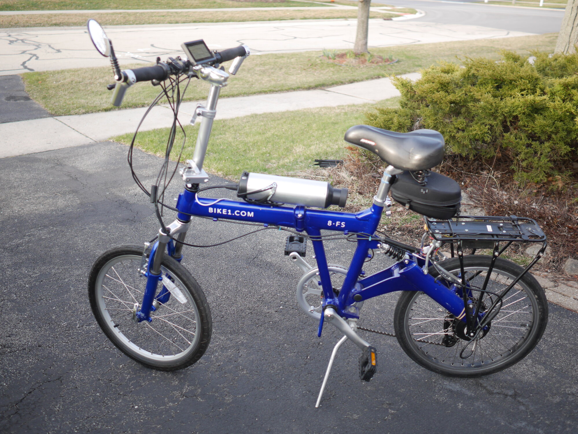

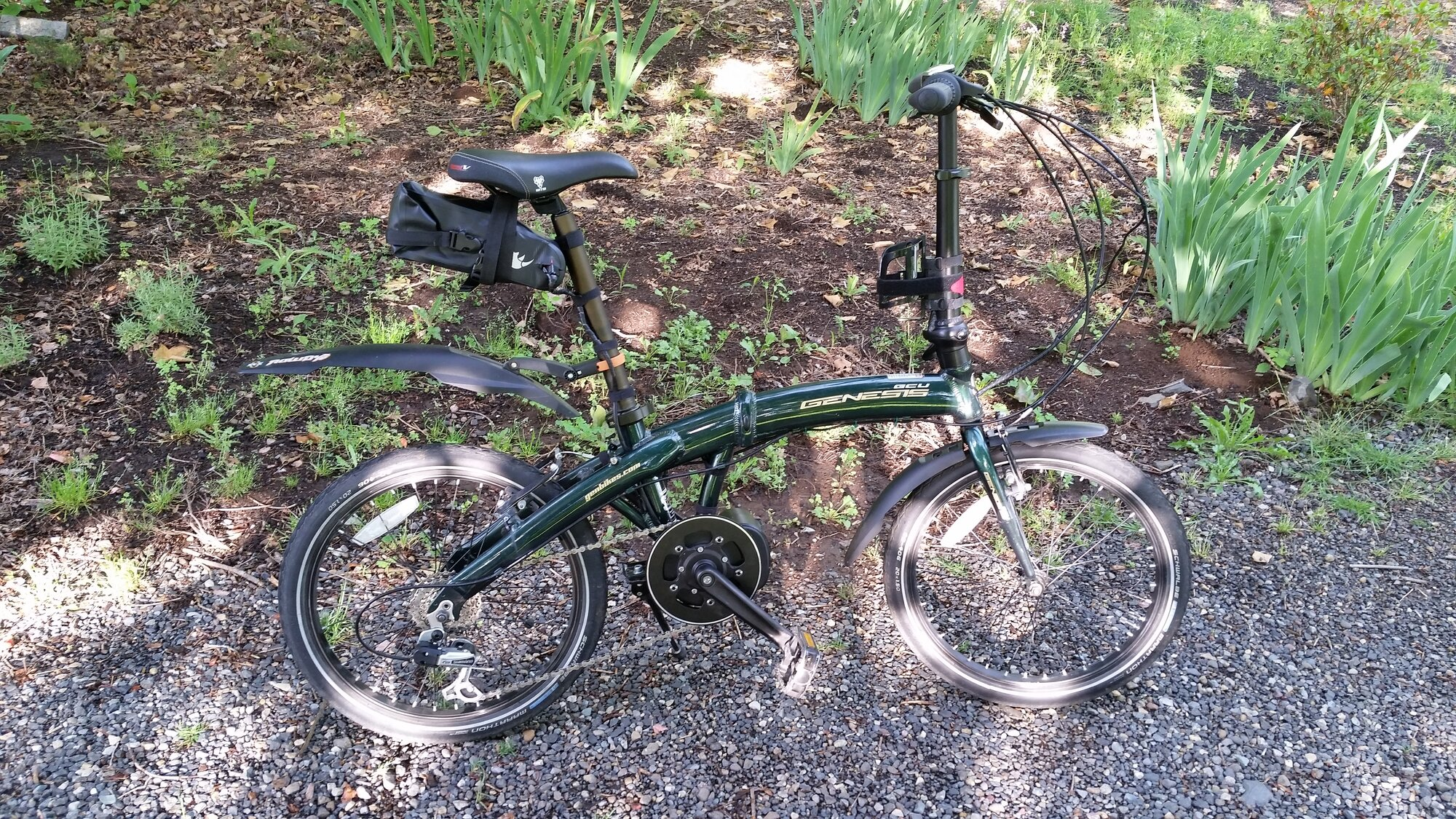

Here is a 20" folding bike that I installed a tongsheng mid drive. This one weighed 40# including the 36v 10ah battery in the seat bag.
Easy conversion if your husband knows his way around a bike, inexpensive, works great and can be put on a bike that you might already have and like.

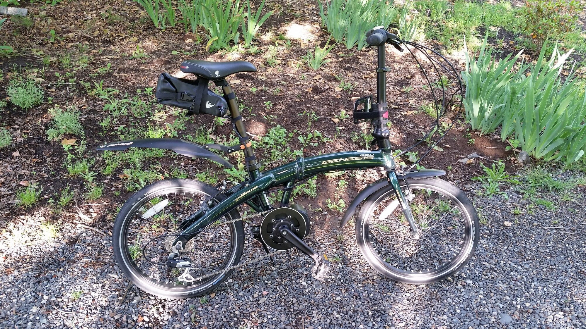

I've done this conversion 6 times and soon to become a 7th, just because I already had the bikes - and loved the performance each time.
Beautiful bike! Thanks for the inspiration. DIY may be a FUTURE project for us. :)
View attachment 108847 View attachment 108849
