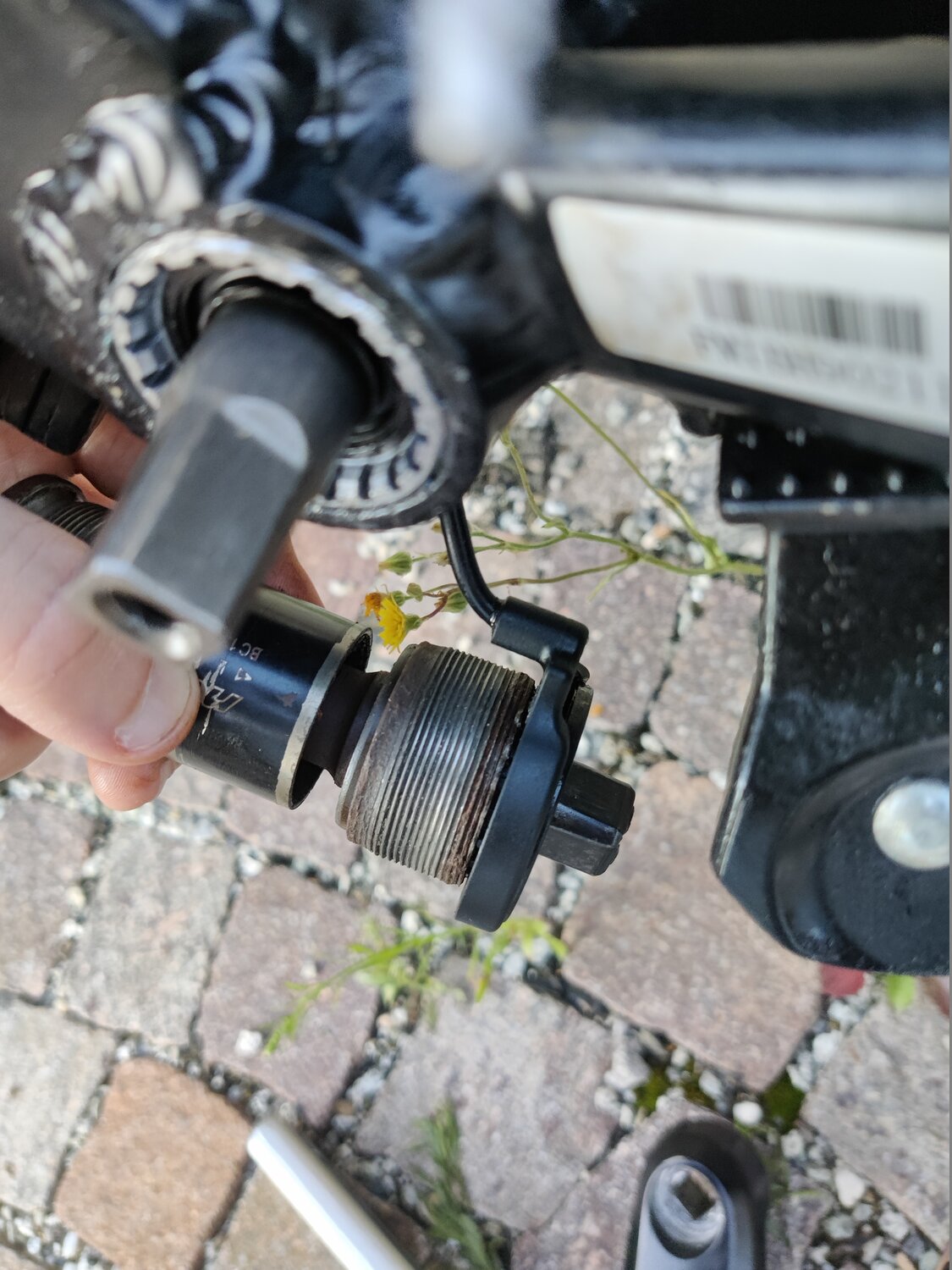

Before I break anything, I'm trying the remove the stock bottom bracket from the standard Moscow, which way do I have to turn the bracket with the removal tool on either side? I don't understand if it's completely stuck or I'm just turning it on the wrong side. I would like to at least know which way is correct.
Have you tried the University of Google/YouTube? For example:
Yes, that's exactly why I'm asking here. That video shows that the drive side unscrews counterclockwise, while I found another video of the Shimano UN300 with the opposite direction (same drive side).
Very good! Sorry I can't help. When you do get it done, maybe you could post result here? I my want to do something with mine as well.

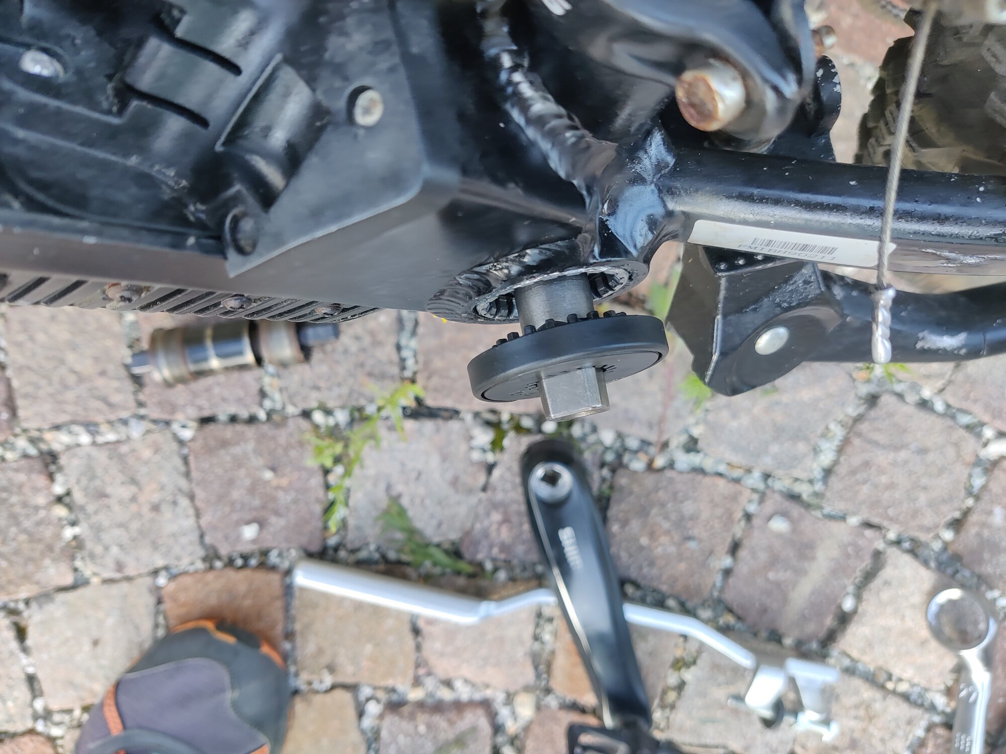

I was able finally remove the left cup, which by the way unscrews counterclockwise, however when I installed the new bottom bracket I bought SHIMANO UN-300 BSA Bottom Bracket Silver / Black 68 mm/122 mm I realised that the sensor doesn't it! :eek:
This is how it should fit - all the way - on the stock NECO left side
and this is how it doesn't go all the way on the SHIMANO UN-300
Basically the inner part is thicker compared to the NECO one. I wasn't expecting this, I thought the sizes were all standardised!
I bought the UN300 cause I couldn't find the UN26. Can you confirm the UN26 has the right inner width for the sensor?
Or I could buy the NECO one since it's widely available. I just thought Shimano was better.
Thanks, I ended up ordering the original NECO part cause it was the easier to find and to be delivered.
