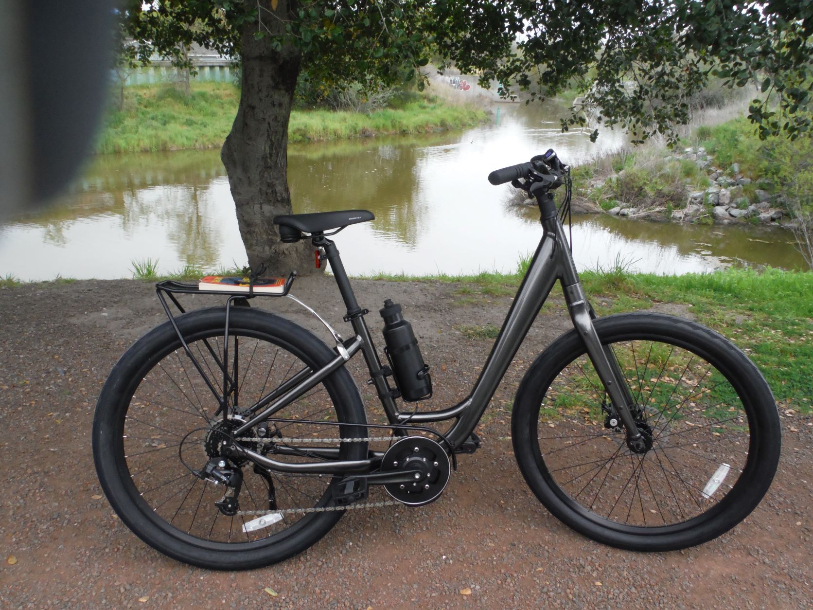

I think that @chunk had or has the right idea. A replacement charger for one of my bikes is less than $20 from Staples, Target, Amazon, eBay... Other parts are similar. I make my own so I am not left waiting in line or online. I have a bunch of projects going but decided today to make a new bike for me. It will be a Giant Liv men's bike with a mid-drive and a continuously variable enviolo gear hub. It will ride like the new $4,000 Como. Here is a Giant Liv woman's bike I recently made electric with external gears. It was $750 before conversion and feels just like a Como.

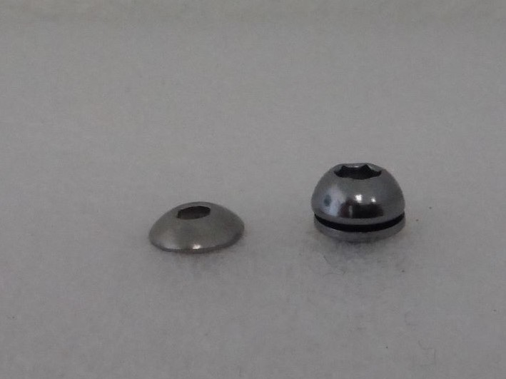

First off; How do you explain inexplicable behaviors? I can't. I have no idea! Because the guy is an idiot? He was hypnotized by a Vegas Magician into thinking that he is a marshmallow? It looks like what happened is the battery case was breached on the underside by the mounting plate, shorting one of the cells. That could happen if the hex cap bottle boss screws or at least one of them had a head that was too high and the guy forced the battery on anyway cracking the case. Here is a low profile head for comparison. I only posted it for its Schadenfreude entertainment value.

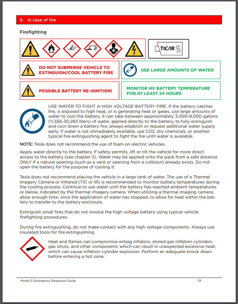

Tesla's emergency responder procedure manual specifies that firefighters use 'copious amounts of water' in case of a battery fire. The same is true of Nissan and others who make BEVs.
Now that Ford sells the Mustang E, I decided to look up their procedure. Sure enough they say the same thing. This image is from the current Tesla Model S Emergency Responders Guide.

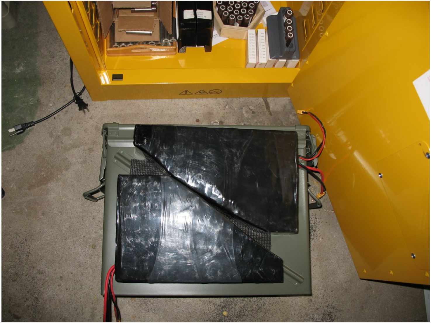

A lithium fire rated fire blanket. Charging in a protective shell that can vent is wise.

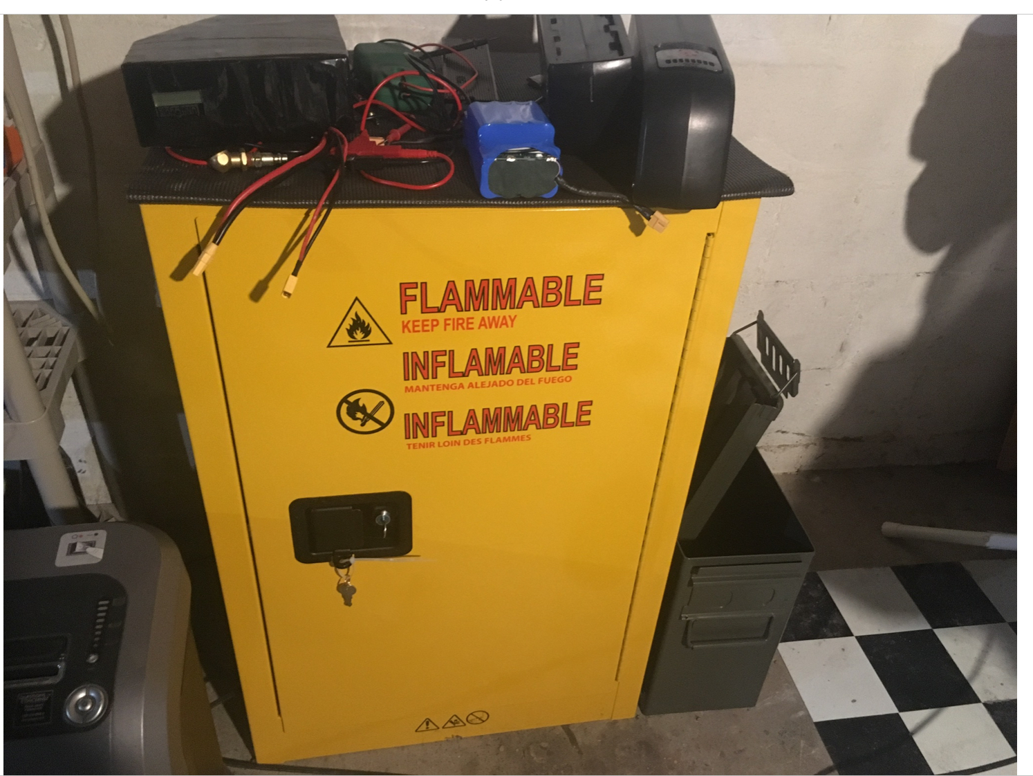

A strorage cabinet with heat and smoke detectors is my way. But I have a fire blanket coming. They smother the fire quite effectively. You’d need a lot of sand, not a very workable solution.
