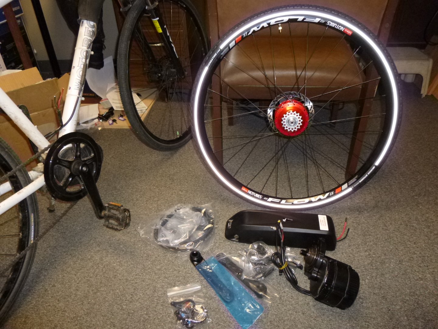

All the components are ready as pictured.....note the bike in the frame. This is my first conversion...a 36V BBS02 500W. I'm replacing the battery.
NCRB cells in the shark. I found out yesterday that BD has finally shipped the bike, it should be here by Monday or Tuesday. I will take pictures for you of the components and the bike in different stages of assembly. Is there anything specific that you are more concerned with? There are plenty of youtubes showing the BBS02 install. On this particular bike the only real challenge has been building the rear wheel with the Rohloff (which is done) and will be installing the gear shift for the Rohloff which I have never done. The rest of the conversion will be straight forward and fast. Since I'm riding a 48V BBs02 750W bike now I am expecting about the same level of performance out of the new build. The only foreseeable difference will be 52V versus 48V and the Titanium frame should be stiffer and a bit lighter, the shark is quite a bit lighter then the "bricks" I've been using so the final bike weight will probably be 8-10 pounds lighter.
