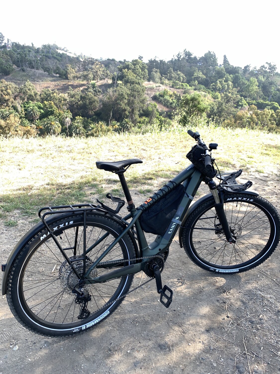

So, instead of a build kit, I decided to get a complete e-bike as my first so I can learn something from it as I tinker along. I got myself a new Canyon Pathlite ON SUV. So far, it’s been a blast to ride these past few days I’ve owned it. I’ve immediately made several changes to the bike so far: Installed one of my old trusted Brooks saddle, switched to tubeless, installed SPD pedals, removed all the reflectors and the dork disk, swapped the stock 42 chainring to a 34 on the Bosch motor. I had to buy a tool for that.. but I’m sure it’ll come in handy again. I’m not too crazy about the stock, straight handlebar, so I’ll probably swap that out for Jones H touring bar I have laying around. But I’m hanging on to the kick stand for now…. it’s very useful! Last time I had a kick stand on my bike was when I was a kid.. Lol..

This is the best plan I think. Your first bike is put together sanely and can be a gateway drug to give you ideas on what to do next now that you have a working platform to see how these things really behave. Hard to go wrong with anything from Canyon. I bought my first ebike too, then upgraded one part after another, including motor+controller+battery. Built all the rest from there.
Free advice: Pretend you are not a cyclist and ride the platform with fresh eyes. Be willing to learn as if you're new at this. Some of the worst ebike advice ever comes from the most experienced cyclists who think they are riding a bicycle, when in fact its only a bicycle-shaped object. Riding technique in particular can be quite different. So are component decisions on stuff like drivetrain durability. Having a bike that was built for you will moderate these concerns considerably but they are still there.
So, here is my new bike, with a few changes and additions I’ve made so far. Significant changes I’ve made so far to the bike are swapping out the stock 42 ring for a 34, and swapping out the stock 170 cranks for 155’s.
