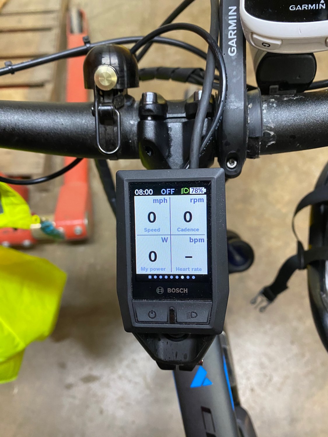

I had wanted to get the smartphone hub but that was delayed from mid feb and is still not out. I thought about the old nyon and getting a intuvia installed but I waited. well the Kiox came out and this bike is my commuter and i don't need gps navigation for the post part so I got it. its 275.00 and what it costs to install it. but they have to drop the motor and run new wires for it. my bulls has super tight wire tubing and they had to tear the bike apart to do it. some issue happened and with the pandemic things are slow. so it took a bit over a week they found a faulty battery wire that would be fixed under warranty.
so its easy to connect the kiox to the e bike app and navigation through the kiox menus are not bad. but I have had a lot of practice with my garmin Plus it lets you adjust wheel size and I am tweaking it till I get the same average as my garmin.
you can adjust what each screen shows. I have my main one that shows speed heart rate wattage and cadence. the only other thing I like is the grade but that's a whole other thing. it is easy to read and easy to operate.

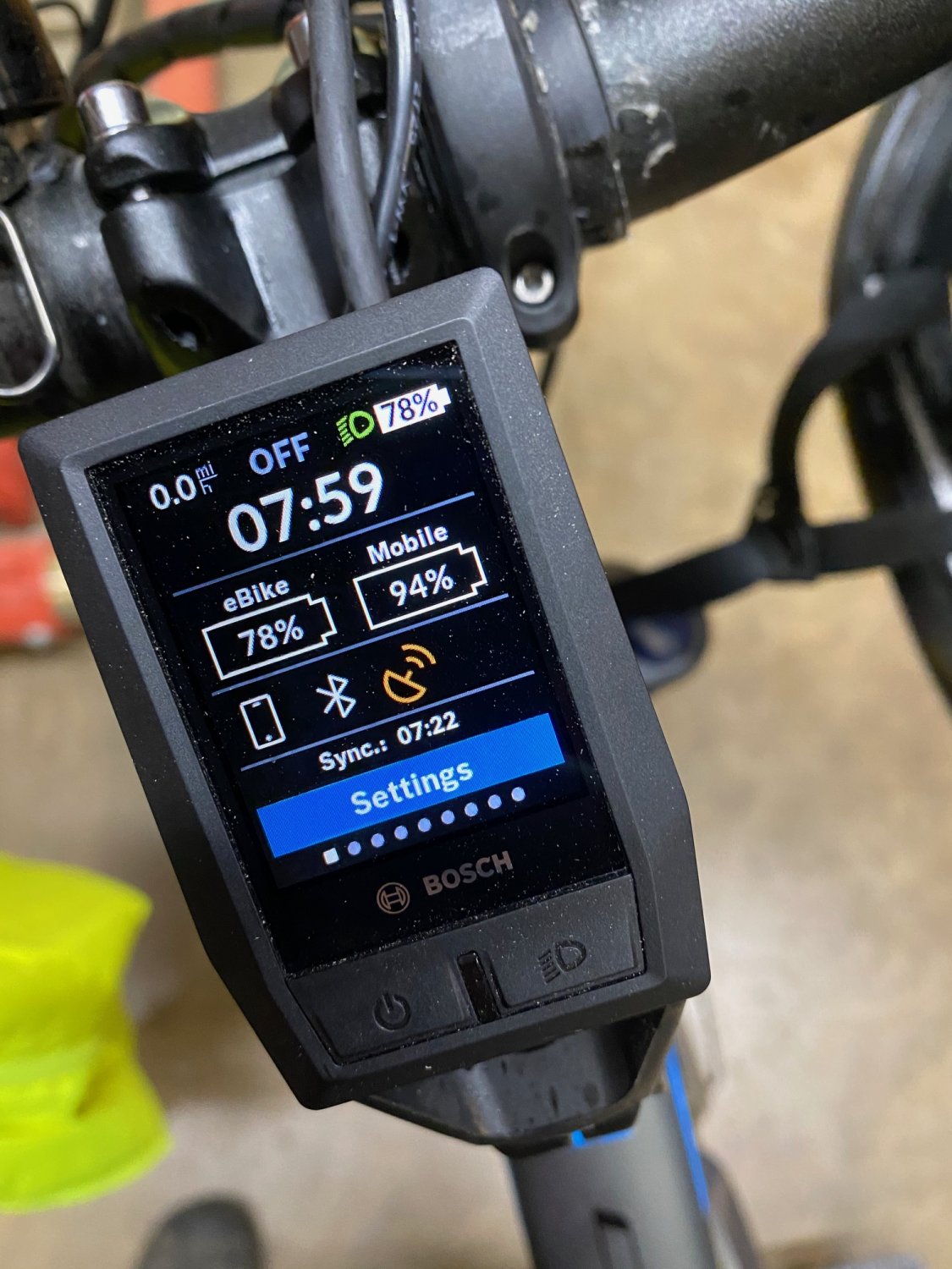

But is it worth the money? really the only thing it gives you over a garmin is wattage. but it does show you more at once battery % lights mode and your choice of screens. so its better then the intuvia. but for the cost the garmin will show you more info and will do more. Plus it only syncs with your phone once in awhile. I don't know what causes it to sync but it is not every ride maybe every 4 rides? the app does not sync with apple health or strava or much of anything. only komoot and that's more for maps. sometimes it does not record the gps data and sometimes it does. it does not seem to get any altitude data either.
I would say inf you want to see how much power your putting out I would not recommend it and go with a good GPS. it cost me about 450.00 to buy it and have it installed. you may need a new stem depending on the angle. my bike came with an adjustable stem and that had to go.
the app needs to sync to other apps and more then cone in awhile. I ride from 2 to 6 times a day.

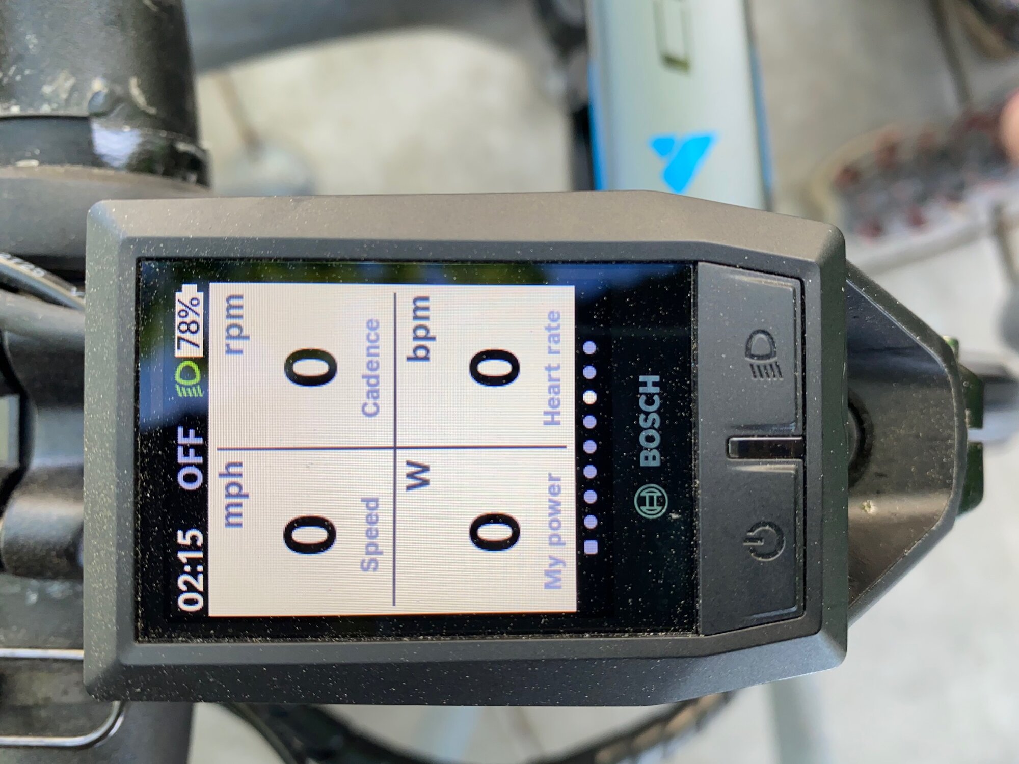

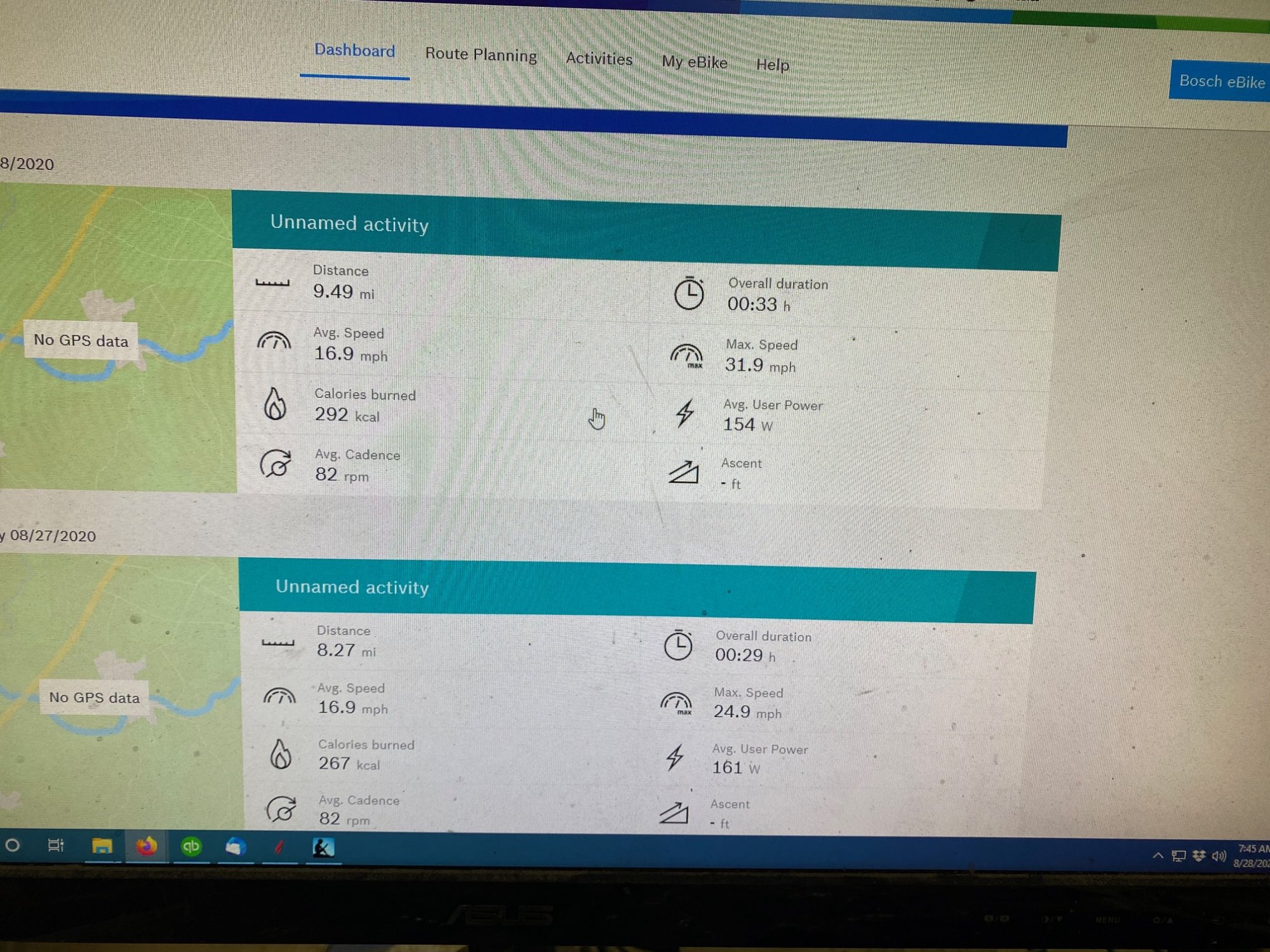

I see that it tracks average user power. Does it track instantaneous user power and also the power generated by the motor? Thanks.
yes the bottom left on my pic is watts. it also has a chart of heart rate cadance power and speed. also this screen. but these only happen after the unit syncs.
Yes, it does.
See picture below.
The snail shaped semi circle around the number "19.9" shows two different colors of blue. Dark blue is instantaneous machine power and the light blue is your power.

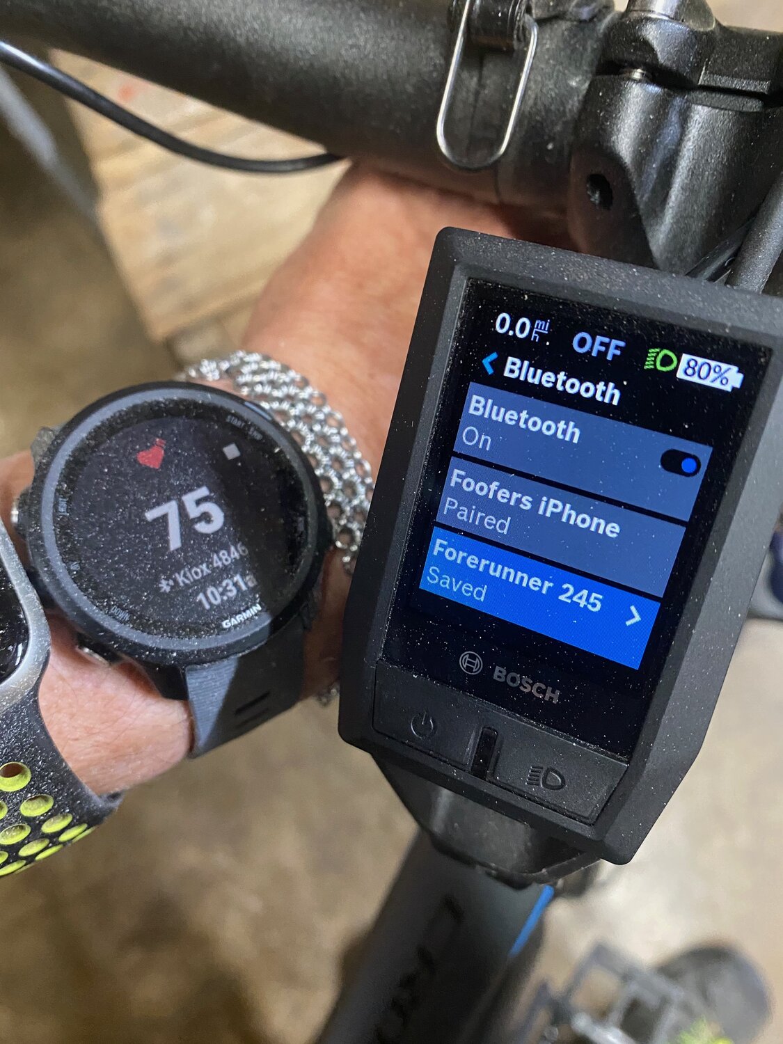

I have had a weird thing going on. it connected to my garmin HRM fine and worked. but I dont like wearing it so I got a garmin watch that transmits bluetooth heart rate. with it connects and shows its connected but shows 0 heart beat.
View attachment 64309View attachment 64310
This site might be of some help:
one possibility might be the watch is connected via Bluetooth but is broadcasting HR data via ANT, and needs to be set to broadcast HR via BT.
it is brodcasting bluetooth. it needed a update to do it. both are connected and the kiox shows it is connected to the watch and the heart rate icon is there. when I took off my garmin Harm (it worked fine) and tried putting the watch on (it did not work because it needed the update) I tried the garmin harm again it would show connected but the same 0 heart rate. if it is not connected it shows a dash.
ok I bought one of the recommended heart rate monitors and it works fine so if you want to use a bluetooth hrm use on that is supported.
