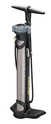

I've installed Schwalbe Rock Razors (60-584) without too much difficulty. My pump is a Topeak JoeBlow Booster which has a secondary air tank (the wide grey cylinder) which is filled to a pressure of 11 bars (four or five times the tyre's riding pressure). Twisting the blue-grey dial releases the air in a rush.
In the video, note the order…
  • Step 5 : 'dry' seating of the tyre (what I described above),
  • Step 6 : adding sealant through the valve (core removed).

I bought my Topeak JoeBlow Booster from bike24.com. Cost is around 100 euros (excluding tax) plus 20 euros freight.
Thanks. That's about the same price as buying it online from a Canadian source. Plus I'd get it faster. I'm just waiting for one more local bike shop to open so I can check if they have it. Even if a few bucks more expensive, I'd rather have the pump sooner than later.

As for the JoeBlow Booster, that looks like a good pump for the purpose but a 12v or 120v mini compressor and a tank like this might be easier for home/shop work. Air Tank I worry a little about what you're going to do about a flat on the road too if you should ever break your bead. Maybe a 25g CO2 cartridge would be enough to put you back in business after repairs. To be safe it seems like you ought to carry a tube....

I didn't buy the Joe Blow Booster pump but did buy a new model Giant booster pump yesterday. Seems like it would work just as well and was cheaper. Plus I can return it if I don't like it. But it's not something to ride with.
Oh, I very much doubt a 12v mini compressor would do the trick here. Those just lack the oompf (for lack of the proper term) to get a tire up to 100+ psi quickly.
