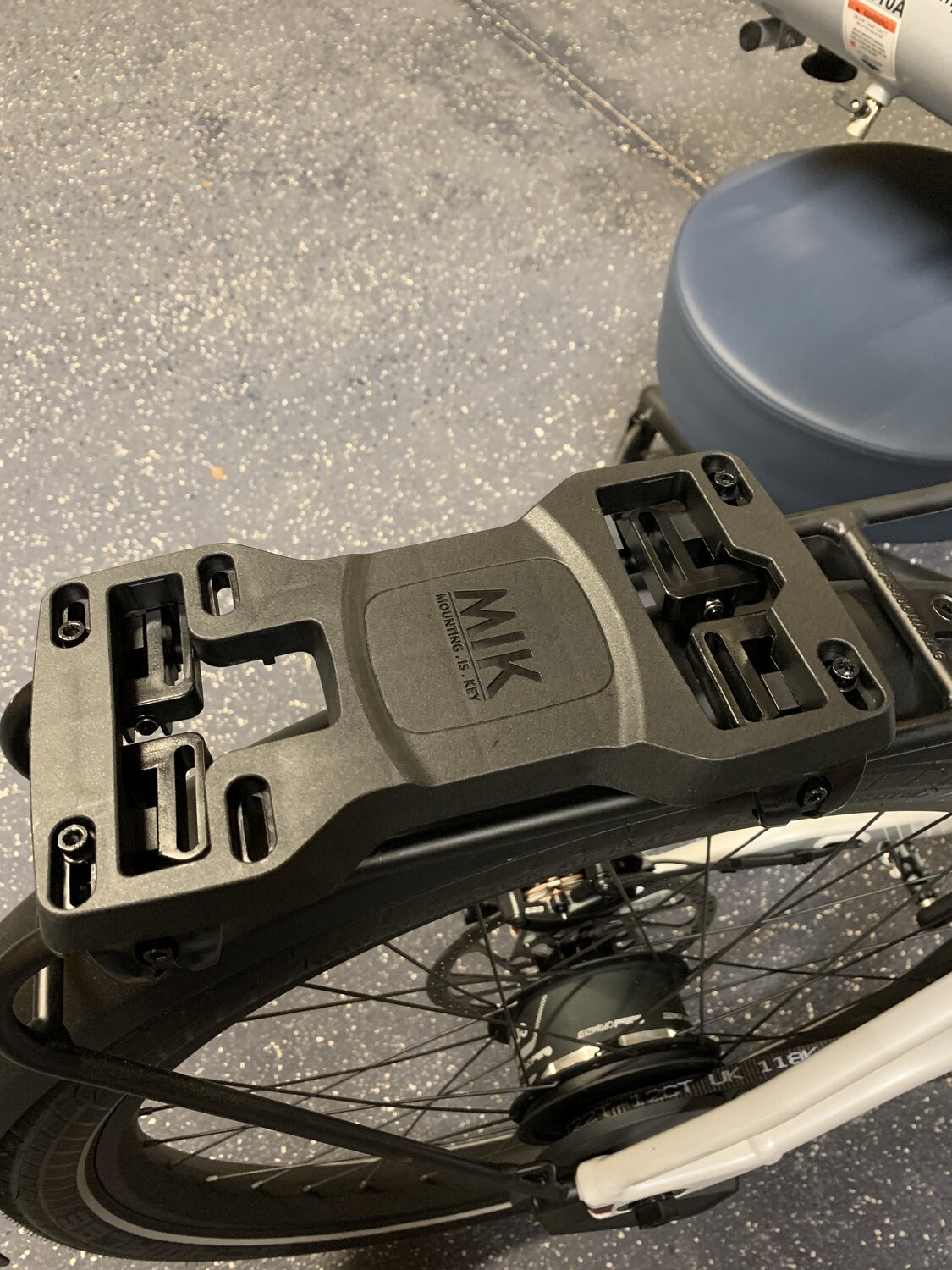

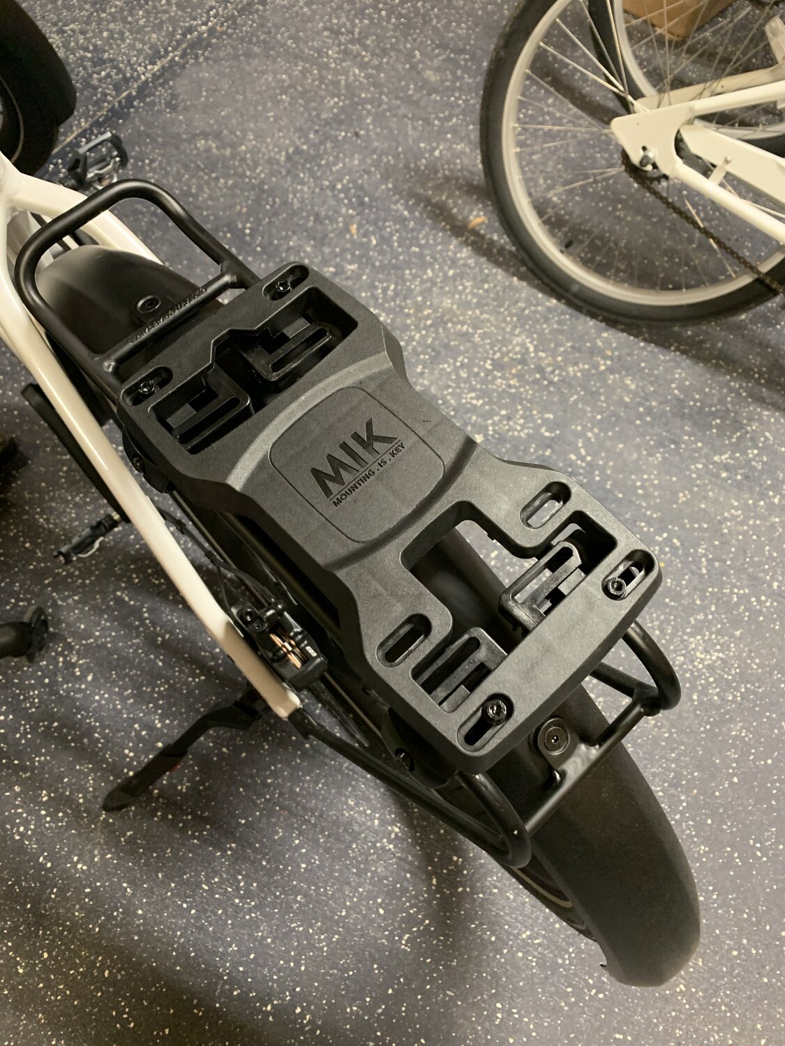

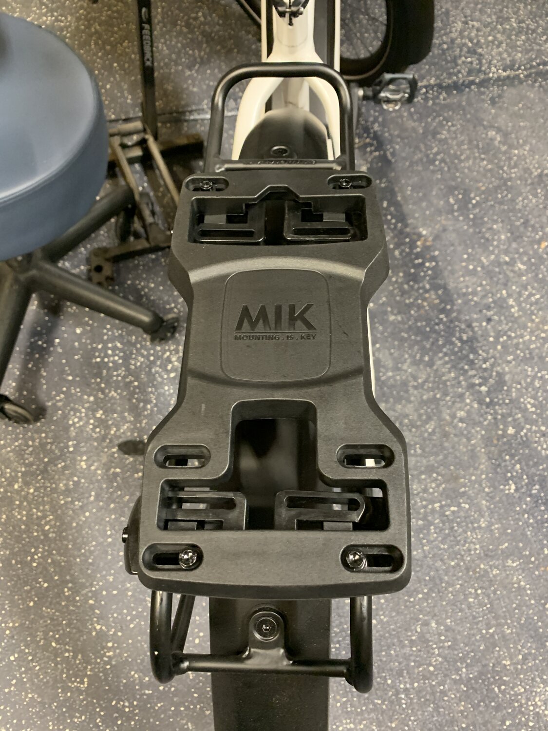

I was having a difficult time attaching tail bags and panniers to my Serial 1. I decided to try the MIK adapter plate and voila, perfect fit and secure attachment!

I have ordered a second MIK adaptor plate. I think (according to my measurements) i can place it on the front rack if i use the close in adaptor holes on the MIK plate. If i get a good mount then the rest is easy peasy.

you only need the plate you see in my above pics. google amazon MIK. Then buy any bag that is MIK equipped. or you can buy the MIK adaptor plate and adapt any bag large enough to fit... this would include certain panniers see BASIL brand for ready to go ideas.
I ordered the Mounting Plate and, the Bontrager MIK Utility Trunk Bag which includes the MIK adaptor. I tried 2 different strap on bags and the narrowness of the rear rack made for a sloppy fit. Pretty sure this MIK solution will work and appreciate your help locating this.

i never put the mik adapter on the front, just the back and it's as snug as snug could be with no noise.
