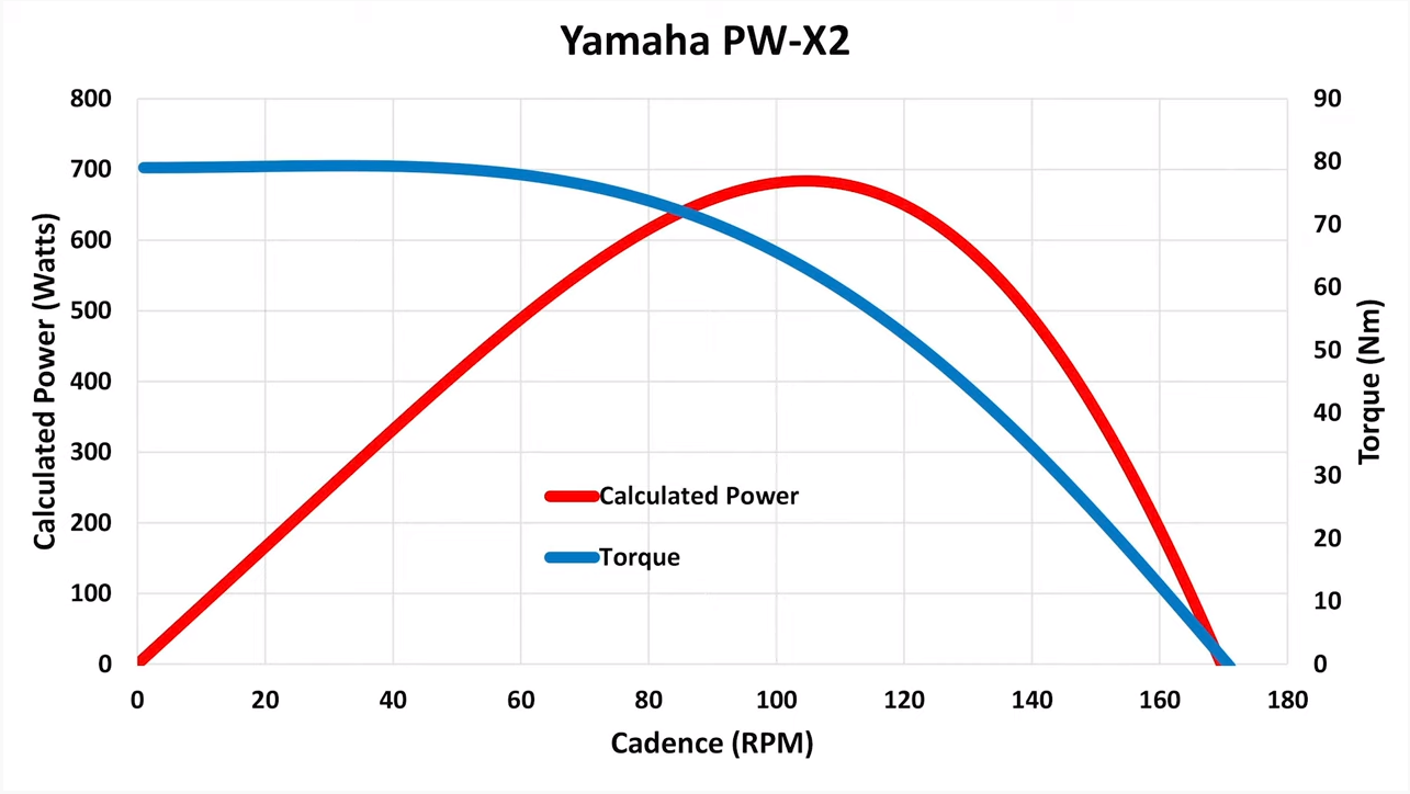

Motor Power: Both Mission Control and BLEvo can only measure the battery power draw. Brose declares the maximum efficiency of the TF motor at 85%. I have determined the actual efficiency of that motor run at the 100% Turbo mode and cadence 80-85 would be closer to 78%.
