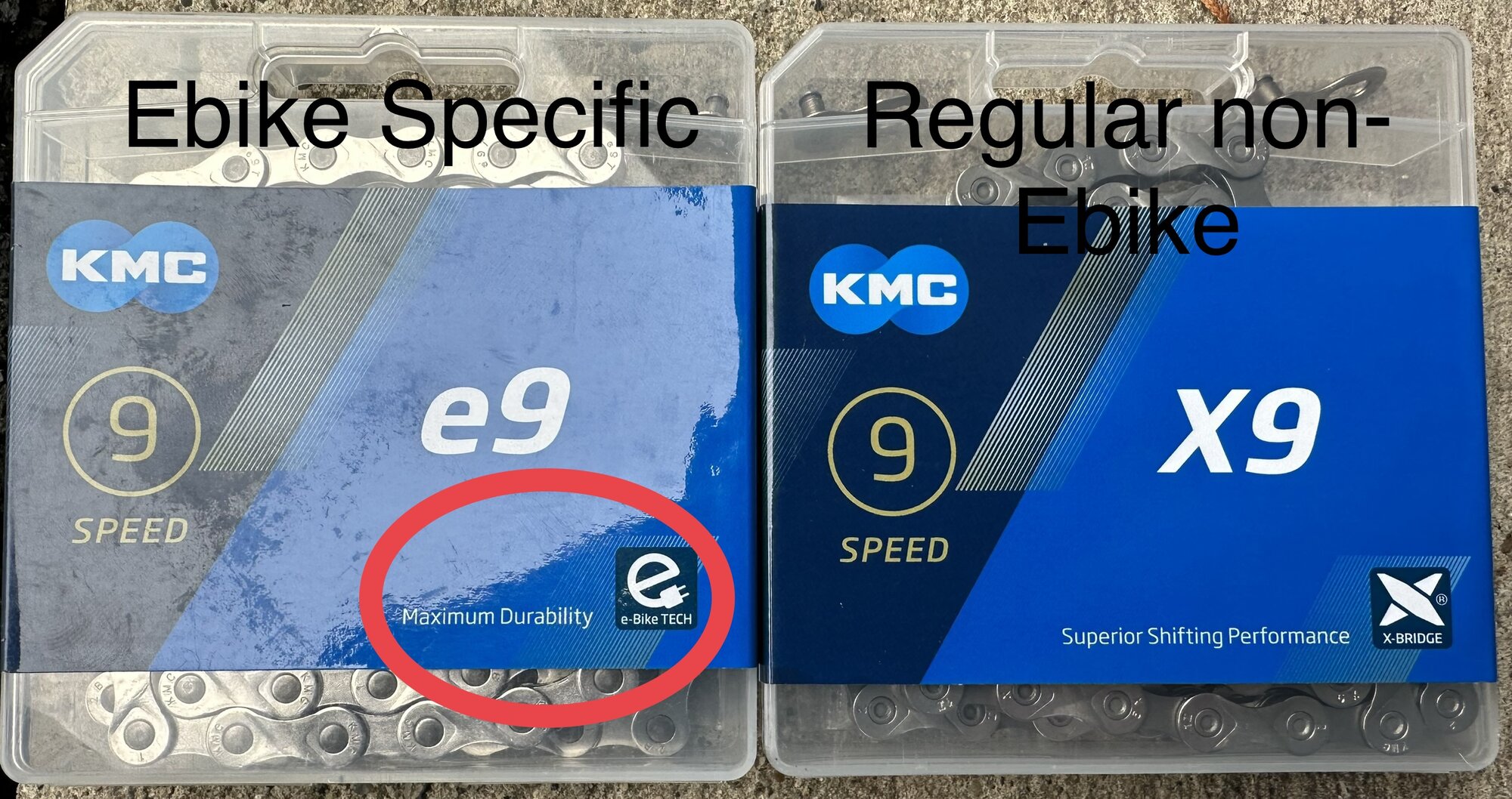

I'm wondering if anyone has experience with ebike-specific chains, specifically for mid-drive ebikes?

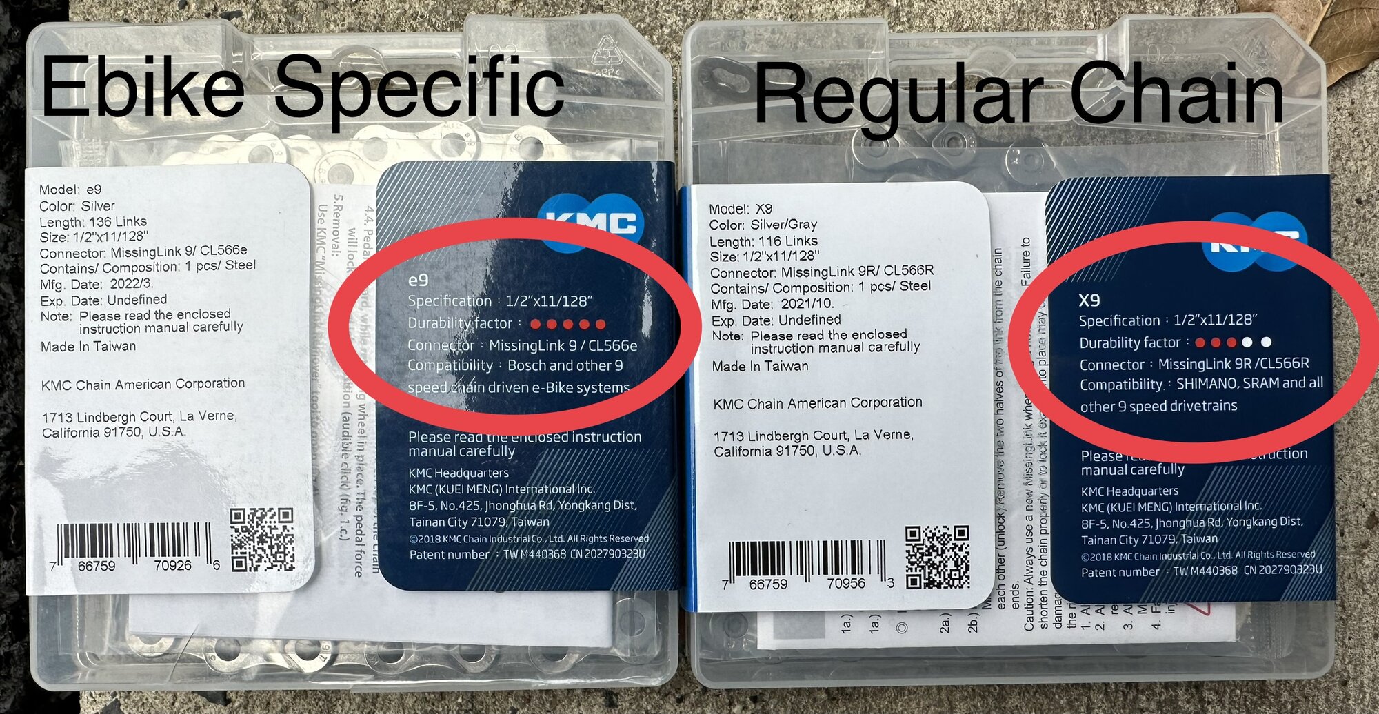

I finally installed the 'KMC e9 Sport 9-Speed E-Bike Chain' (along with a brand-new cassette), after riding 1,000 miles on a regular chain. My LBS said my regular chain was on its last leg at 1,000 miles. The bike is powered by the Bafang Ultra motor, but I'm always very careful shifting and usually don't give it a lot of torque.
On the attached images you'll see that the ebike-specific chain apparently has a higher 'Durability Factor', with a Level Five durability. A regular chain appears to have only a Level Three durability. Both chain are made by KMC. The ebike-specific chain is called 'E9', whereas the regular chain is called 'X9'.
Friends, are 'ebike chains' simply a ploy or gimmick for chain manufacturers to sell a higher priced chain to us, or is there an actual improvement in build quality and durability?
Please share your thoughts
, thanks! :)

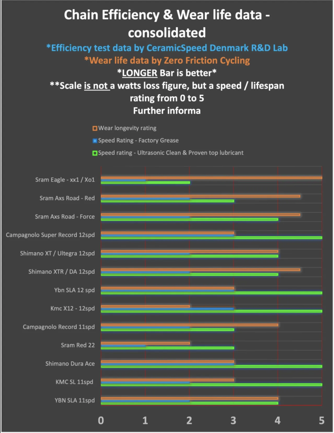

Sram eagle Xo1 and XX1 chains have frankly amazing wear durability due to Srams HARDCHROME treatment. This is very different to the level of chrome treatment used on their 11spd road chains (PG1190 or PG1170). Srams 11spd road chains with whatever that chrome treatment is have just ok longevity. Hardchrome, from a wear longevity perspective, is all that and a bag of chips.
Srams GX and NX level chains do NOT have hardchrome, and have really very average (aka, poor) wear lifespan. Do not buy GX chain, make the step up to X01, the difference in price will be pay for itself about 50 times over.

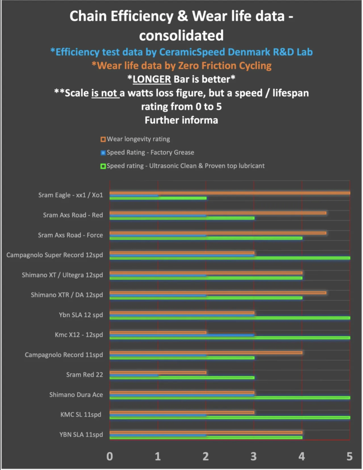

And here are the test results from that article:
What these tests consistently show is that newer chains are better than older chains, so even if you don't need 12 speeds, in general a 12 speed chain is better than an 11 speed chain, which is better than a 10 or 9 speed chain. And the "guidelines" about link thickness or solid vs hollow pins are almost always wrong. The newer and lighter chains are better than the older and heavier chains because metallurgy wins out.
And this is important for those of us running SRAM 12 speed drivetrains because the cassettes and front chain rings aren't cheap. Better to replace the chain before its wear affects the sprockets on those.
I have been looking at the X01 chains as a possible replacement, however I have seen posts where the hollow pins have been crushed on more powerful M620 builds.
I've been running X01 chains since before I first posted about them, so a few years. Two Luna Apollos, with 1500 watt output, bikes are 70 lbs, I'm about 185 lbs, my wife is substantially less though. Climb hills as steep as 18%. Chain stretch has been minimal, and no breakage. I can't speak for all hollow pin chains, of course.
