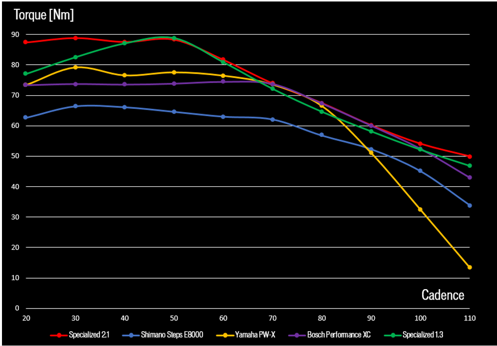

This comparison chart is a couple of years old and doesn't include the latest motor updates such as Yamaha's PW-X2 but it's still useful in comparing mid-drive torque vs cadence. My understanding is that the PW-X2 motpr extends its peak torque curve out past a cadence of 100rpm.

I know this graph and I really like Specialized being open about it. I am curious how the X2 and gen 4 Bosch looks. I expect gen 4 Bosch to have a closer curve to 2.1.
You can clearly see that even the best drops down to 60 nm around 90 rpm which translates into around 570W. Also the peak power output of 1.3 looks like it is less than 600W , are you certain 800W was not battery consumption ?
I really don't think X2 will come remotely close to 80 nm at 100 rpm since it will be way higher than the peak output.

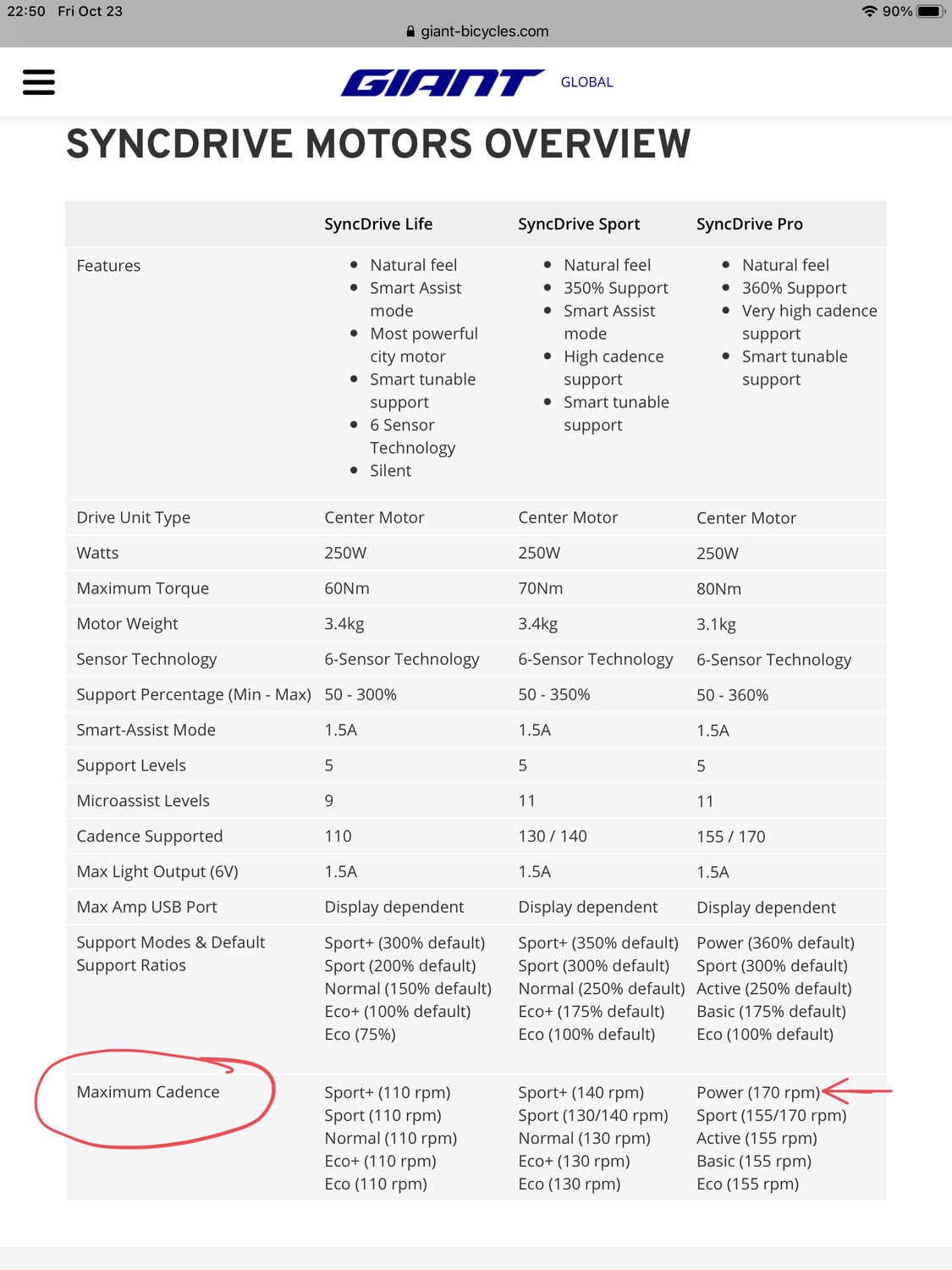

The new Yamaha X2 supports up to 170 rpm and the torque curve is significantly improved. ;)
Honestly this is just marketing, it gives absolutely no information.
To have 80nm at 170rpm that motor has to have almost 1.5Kw output maybe you can show me a document that states their peak power.

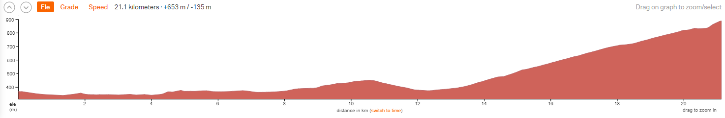

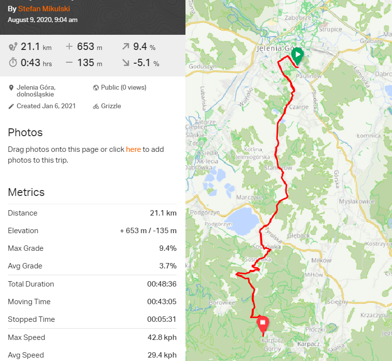

I was riding in Turbo (my brother rode in Giant level 3 of 5) and we were actually doing our best for the 20.1 km (12.5 mi) uphill ride. Our average speed at the average 3.7% gradient was 29.4 km/h (18.3 mph). We rode uphill for 43 minutes net with total of 5 minutes of stops. (All data here refer to the uphill direction of our loop only).
P.S. I have split the original ride record of 08/09/2020 to extract the uphill ride from the loop.
I see now it makes sense. I don't know what your effort was but I think the motor output was still around 400w which is reasonable.
On a side note this is quite a mild climb and a good hub will be faster on this one. It is %15-%20+ grades that mid drives will have the advantage.
