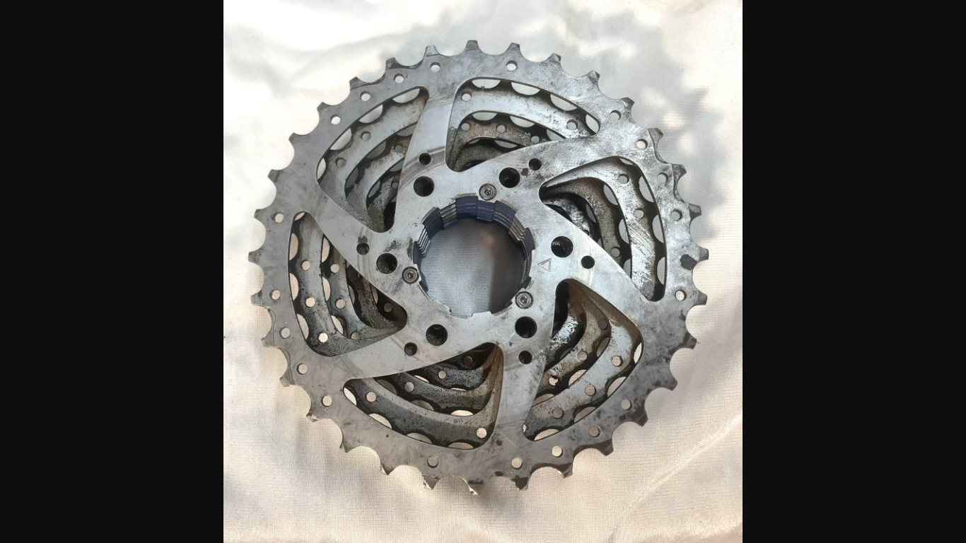

Small Shimano cassettes are not serviceable because of their low price. You replace the whole cassette.
10, 11 and 12 speed ones are serviceable except for the top high end ones (which are milled from a single block of metal).
Besides, the cassette model number is usually printed on the back side of the largest sprocket.
The issue with a freehub is also if you space out, you end up with a high torque low gear sprocket that is sitting on the splines with a tiny contact area.
The larger ones are usually bolted to a spreader.
I took apart a huge dinner plate cassette I got 2nd hand off a friend, I used the spreaders as a spacer, bit of a botch, but it works.
