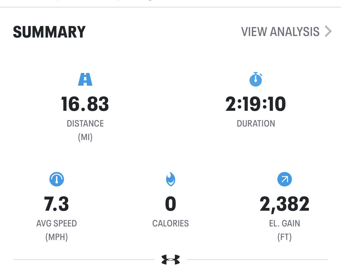

Thanks for chiming in @Jeffr. I guess I am not alone. However I am getting somewhat better range @ 17 miles/2400' with the stock tune using 1-3 of 5 and didn't come up against the cut out.
Ride 12:31.png
However since then I have and the cutout sounds the same. I am glad that the JonA tune drops the LVC on the display because I can monitor via my display that I don't go below 41v but as Scrambler has said it may be set high also at the BMS which would override the display voltage? And thanks to @scrambler for being the voice of reason also! It is always good to have someone that really understands the nomenclature on board.

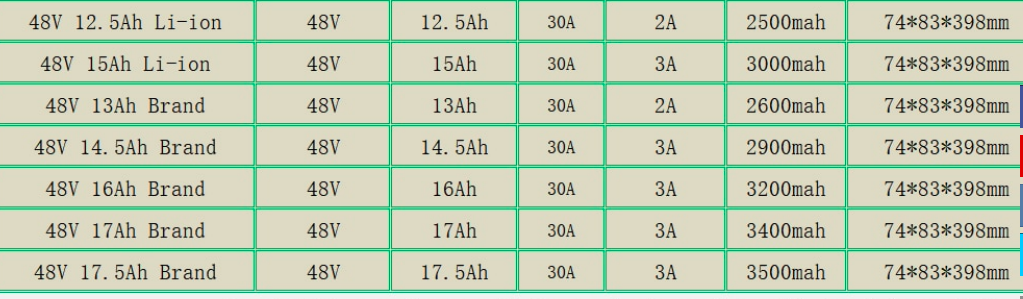

I just picked up on the AliExpress vendor from another fourm that has the right case, probably the one you are using? However I don't think that they will be any more up to the job than the stock ones given they are 30A and the cells vary due to mah so that a 15ah battery as listed is only using a 3000mah cell as opposed to what is "supposed" to be in the stock 17.5ah battery are 3500mah, which of course is what bumps up the total Ah's. So I don't expect that they will even provide the same amount of wh's as the larger cells and dependent on how they have the BMS set may be the same, better or worse. Maybe get in touch with them to see what type of BMS setting they use?

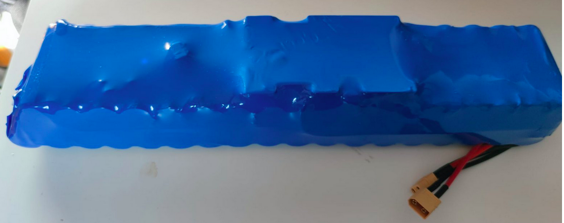

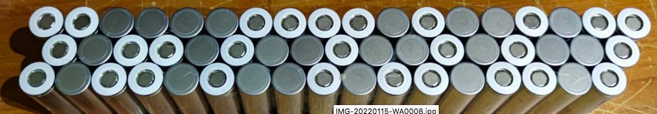

Obviously lots of moving parts! Here are some pix of a 13S4P 20ah 48v Samsung 50G 21700 cell with 30A smart BMS fit into an E10 frame which as far as I can tell is the same battery cavity the Z1 uses?
Obviously takes some doing and the owner said he replaced the battery lock with a charge port which was smart. But looks like a win win for him as he got a higher Ah battery using arguably higher grade cells. Will be keeping an eye on how he says it performs....

Interesting. Are you sure this is 13S4P, that would be 52 cells, but it looks like two rows of 19cells (38). Hard to really see them all though
I’m thinking it’s 13s3p. Using 21700 cells with 4900 mah, that would be 48v15ah, about the same as a 13p5s using 3000 maH 18650 cells
Copied from the source:
13s4p battery, 52 pcs samsung 50g cells smart bms 30A
