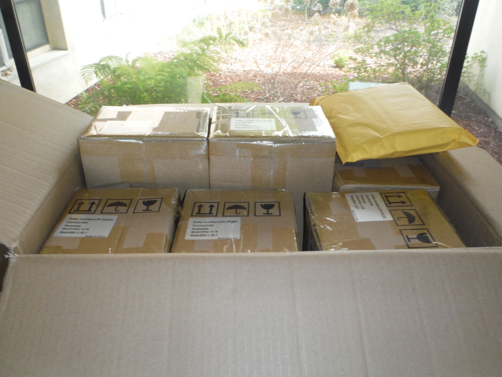

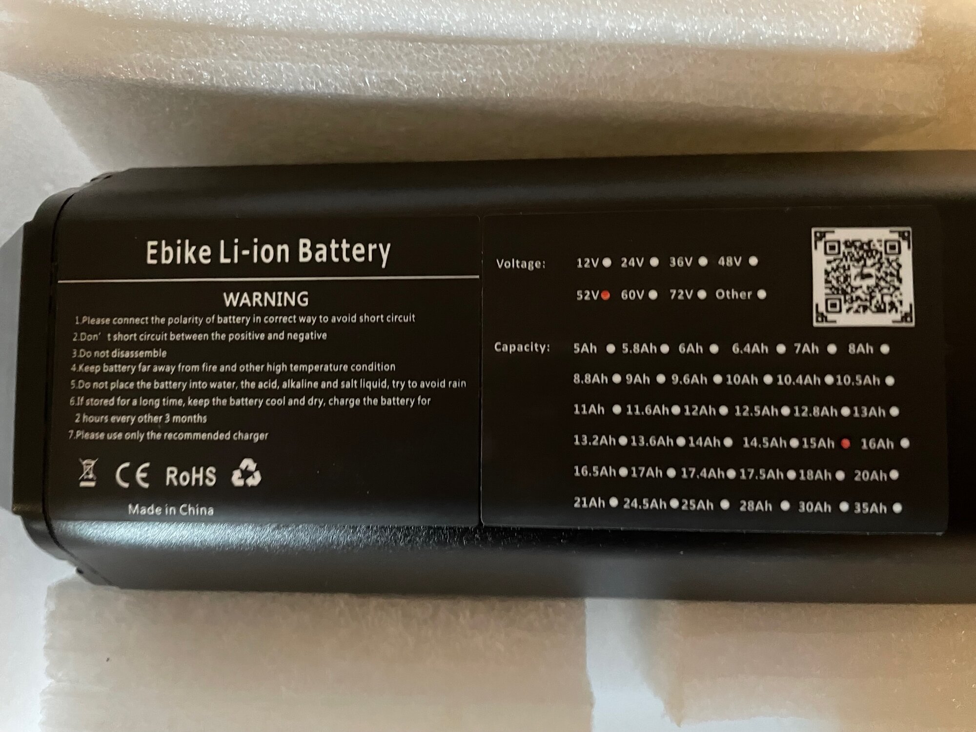

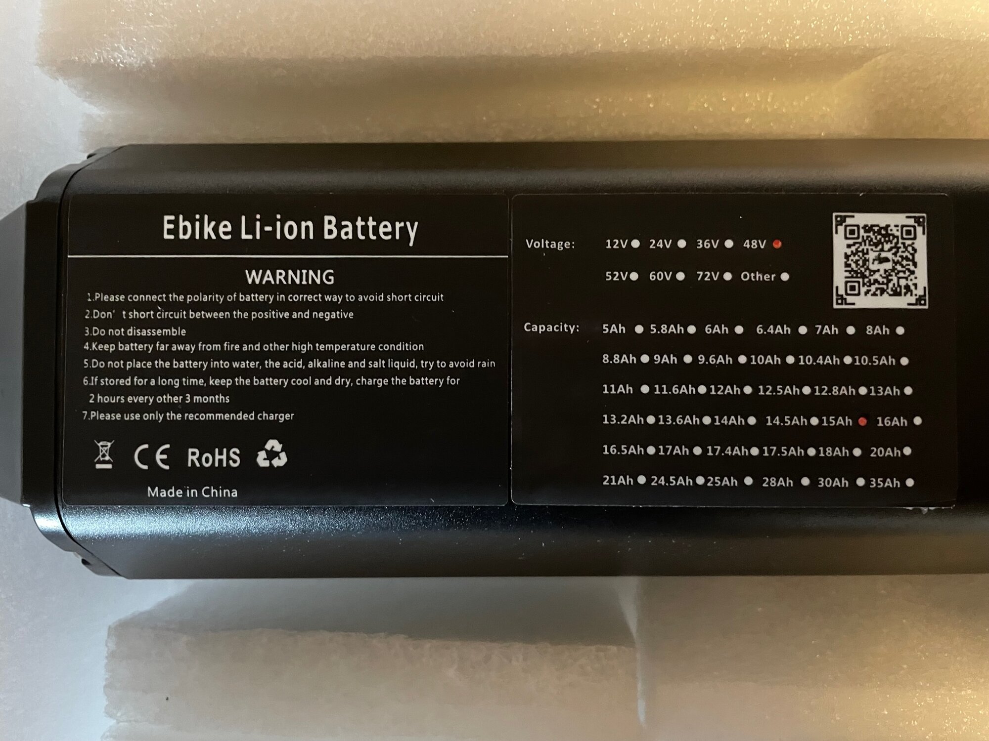

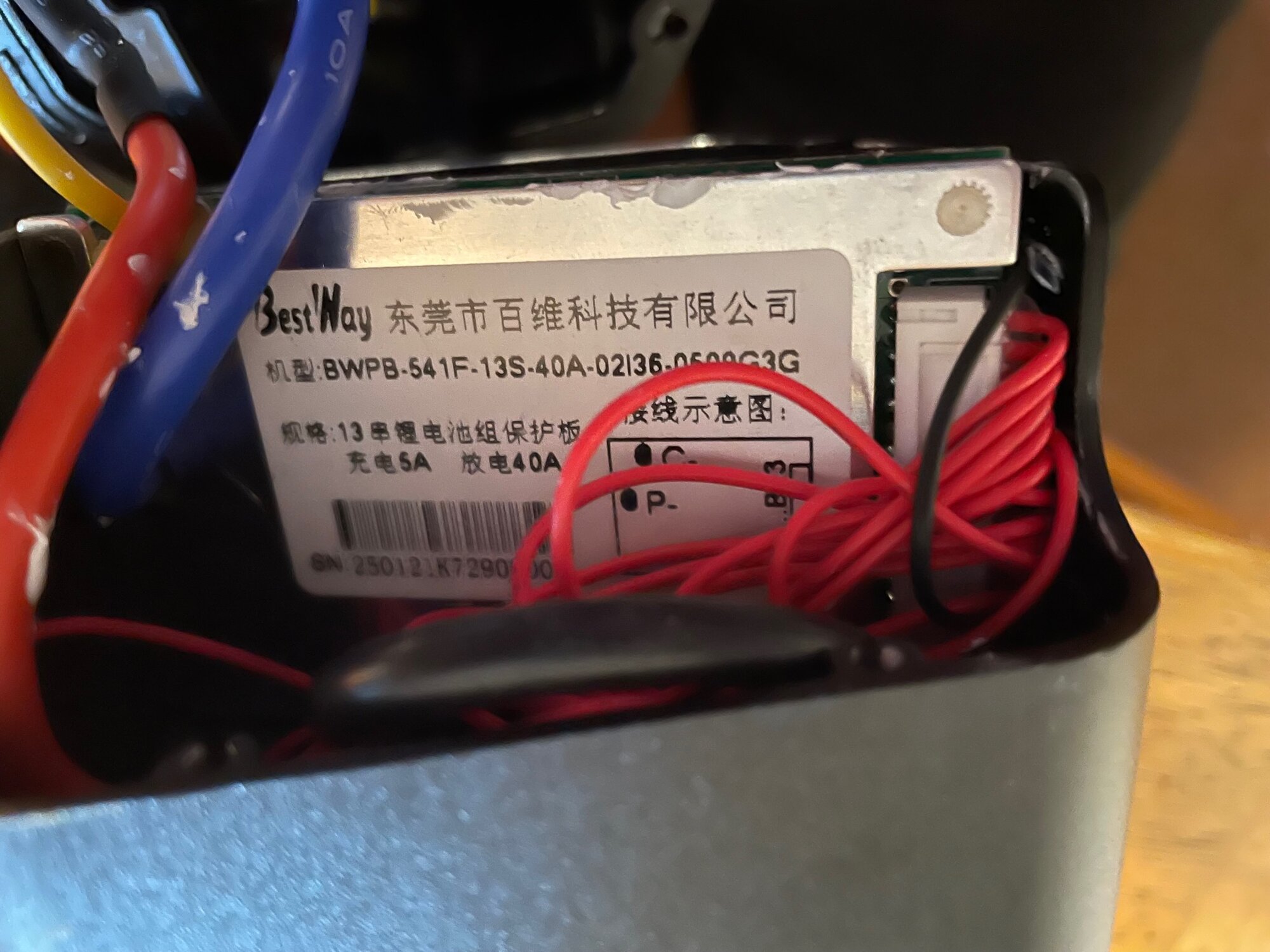

Received my battery order today. I ended up ordering two batteries as one is for a friend that got a Z1 and needed another also. I couldn't get over the idea of using 21700 cells and was able to work with a manufacturer in China that had the stock case available. Due to the cells larger size however they are less wh's but with my experience with 21700 cell batteries the last 4 yrs. and how they perform I think they should be well on par with the stock 18650 battery that I have found to be not quite up to snuff. Should be fine for a second battery as I am getting 25 miles now with my stock one.
I also wanted to try a 52v battery so I got one of them as well as a 48v. Both are 15ah so the 52v is 780wh and the 48v is 720wh and they have a larger 40A, 30A is stock actually 26A, BMS. That is all that they could fit in the stock case. The whole process took me 2 months with the Chinese New Year in there including design but only 28 days from time of actual payment which isn't too bad I feel in this day and age of uncertainty.
I have the 52v on the bike charging and the display set for 52v and will be trying it out first. Weather is not conducive to testing here however....

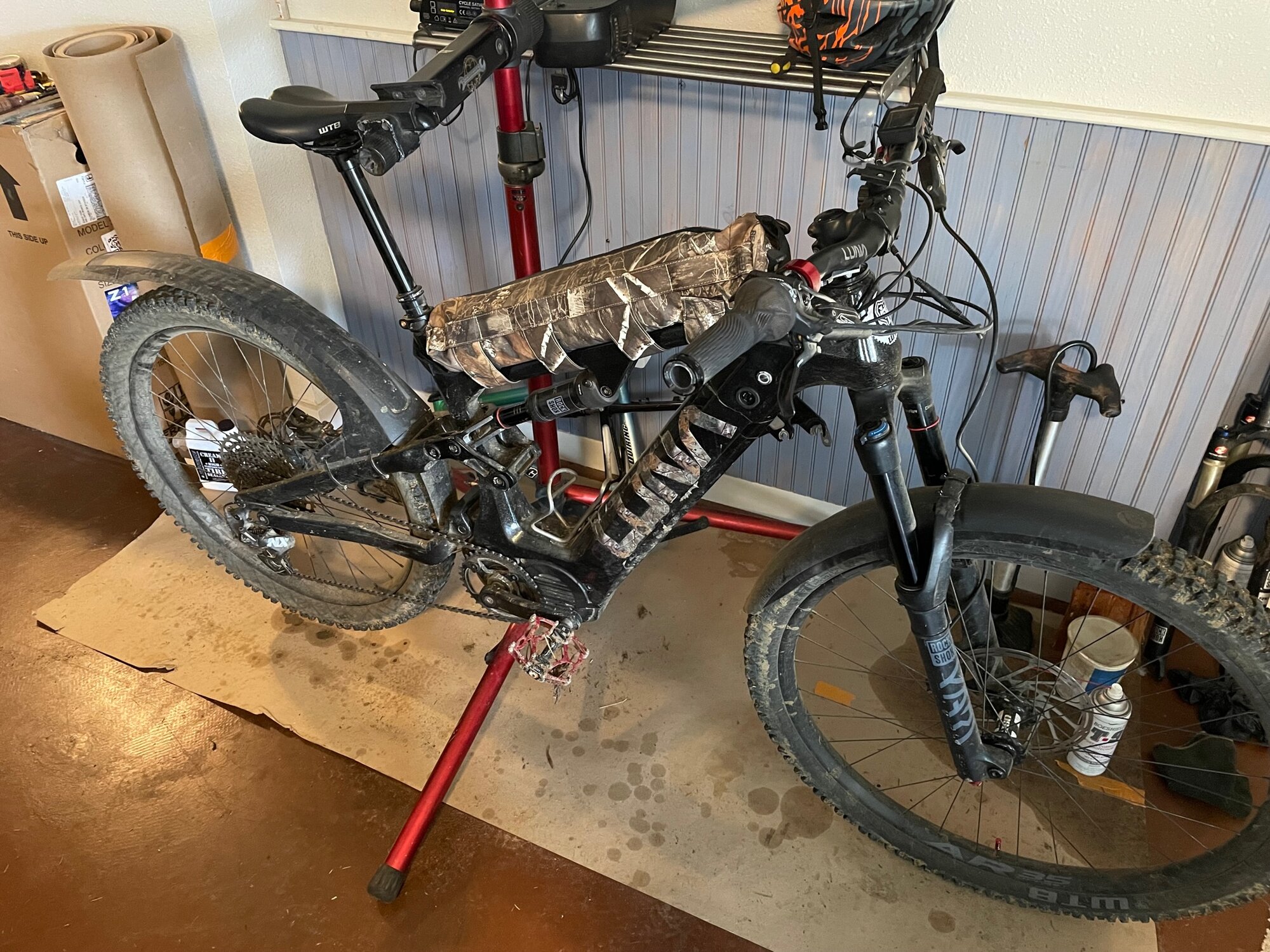

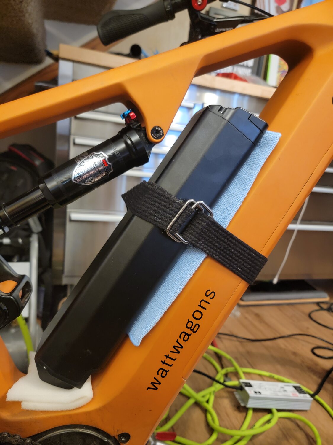

Finished off my dual battery setup
Total of 1500wh's on board that at a sporty tempo should yield 50 + miles, Ultras are battery hogs I know...... The rides planned for this setup are primarily gravel logging road adventures here in the PNW and so the extra weight is not a big issue. Handling seems fine to me. Daily use is with the onboard internal battery with the 2nd left at home.
Do you just swap two batteries, or are they somehow in parallel? I ordered some ideal diodes from China but order came in incomplete so thinking I might just swap batteries half way through ride. I fipped shock to put valve on top and battery then fits in triangle.. if weight up high become sissue.
My plan is to just swap batteries with this setup and keep the stock connections in play just bringing my key. As it turned out one of my batteries is 48v and the other is 52v anyway.I just got done with a ride and hardly knew it was there handling wise and certainly doesn't slow things down. Does decrease standover a bit though but I don't plan on much tech single tracking with it aboard, mainly gravel double track where it is not an issue.
You must have the lg size E22 frame cause it will fit like that but I have a medium and even with that shock knob turned it's a no go....I am not 100% pleased yet though and am noodling another idea that will work but take some skills to put together I don't have. Like 3D printing.
