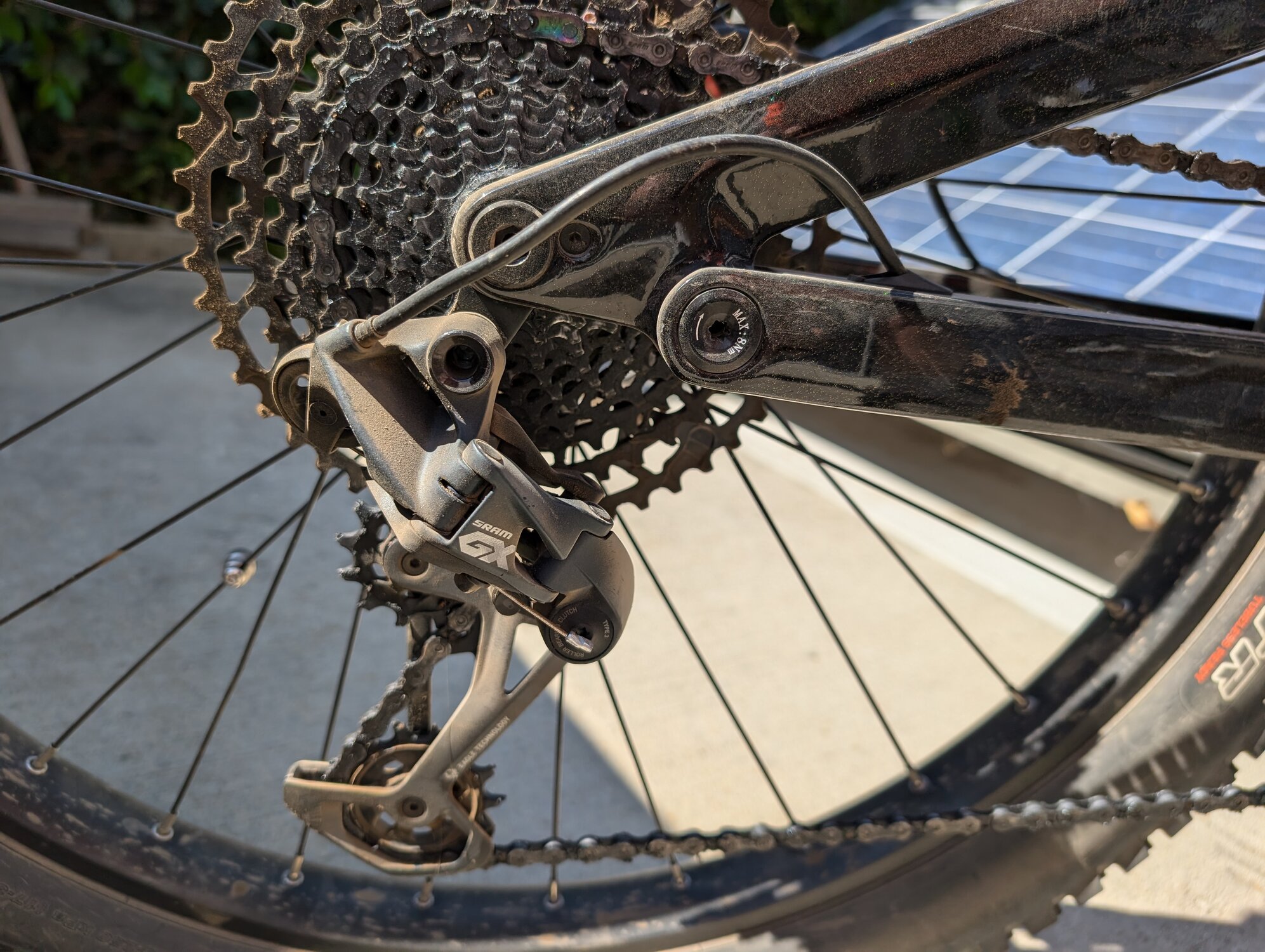

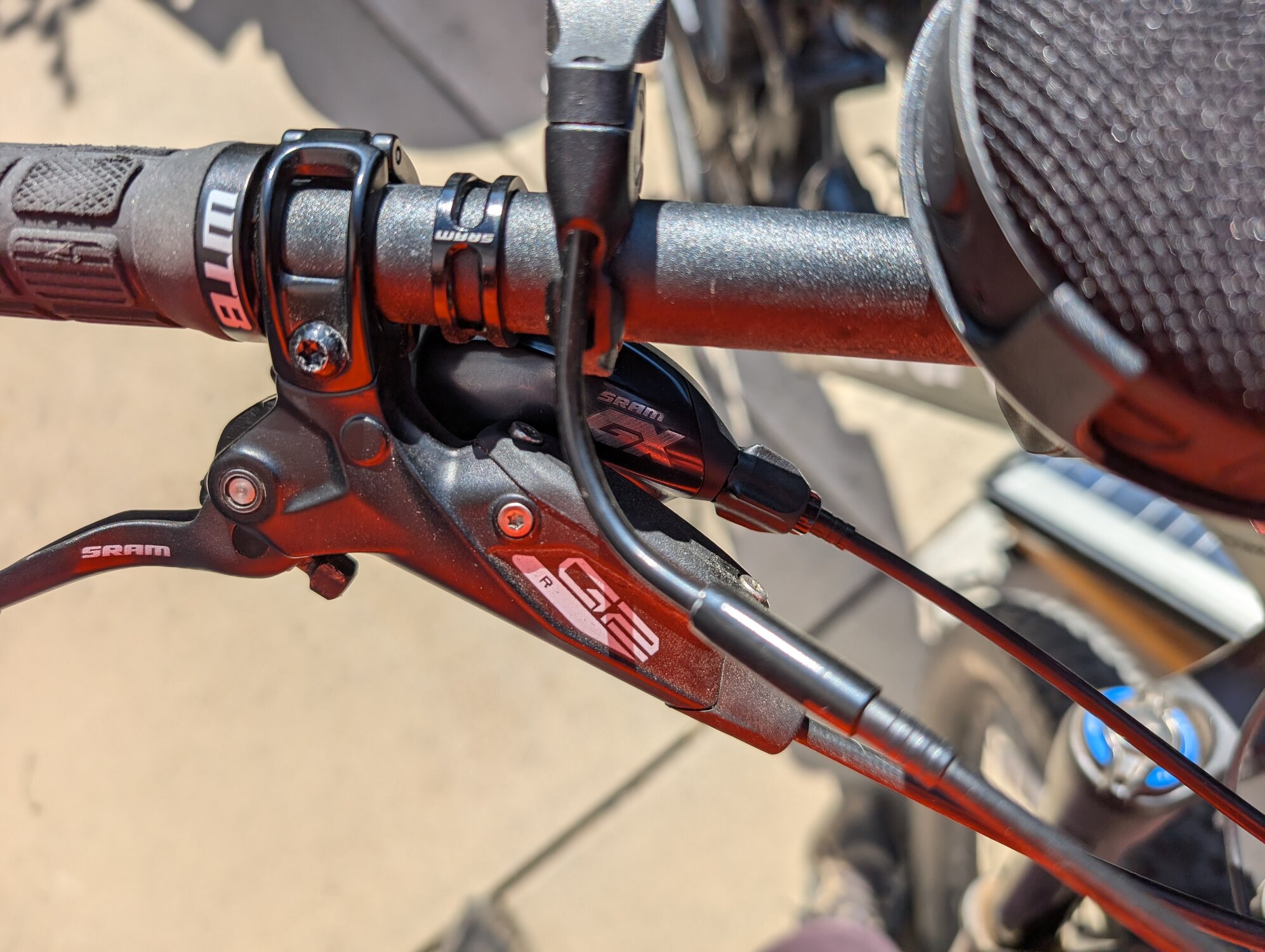

Well, as other have suggested, upgrading to the SRAM GX derailleur and GX shifter made a big difference. So far I have a couple hundred miles on the new setup. Shifts up and down are crisp and well defined, the drivetrain responds predictably to adjustments, and there's much less force required on the shifter for down shifts. Not to mention that I can now jump down multiple gears, as opposed to the SX single cog down shifts. In all fairness, my derailleur hanger had a tiny bit of misalignment that I measured with my home-made alignment tool, and the SX derailleur had a slight tweakage to it. But I'm very happy with my $150 upgrade I got from BikeTiresDirect.com. Everything bolted in easily and fit perfectly. My only issue has been infrequently throwing the chain when shifting to the smallest cog. I followed the SRAM Tech video derailleur instructions but think I need to draw in the high speed limit a tad.

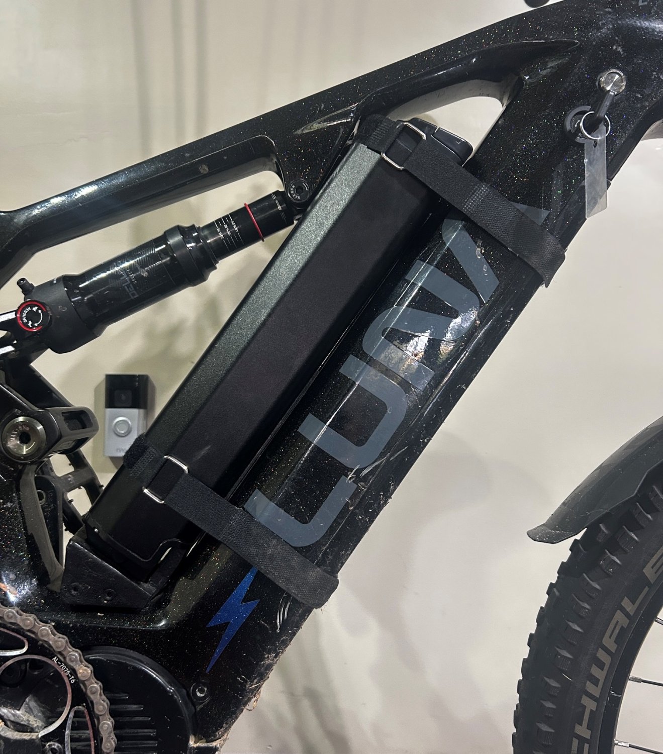

  8. Battery: Still using the oringal battery, as a back up. I like to ride hard and long. On the way home from my long rides, I want plenty of power to rip up the terrain so I carry two batteries, one resting on the downtube secured with velcro straps. See pic below. The biggest criticism of the Z1 was the battery range. It's an eMTB, so if you are riding hard and using a lot of assist, your range will be curtailed. If you ride conservatively, it's got plenty of juice. I ride MTB syle once a week with two of my friends. They both have 20 Amp batteries and they always run out of juice before I do. I love it. I've been able to squeeze 40 miles out out of my battery riding paved surfaces in PAS 1-2, and occiasionally 5.
