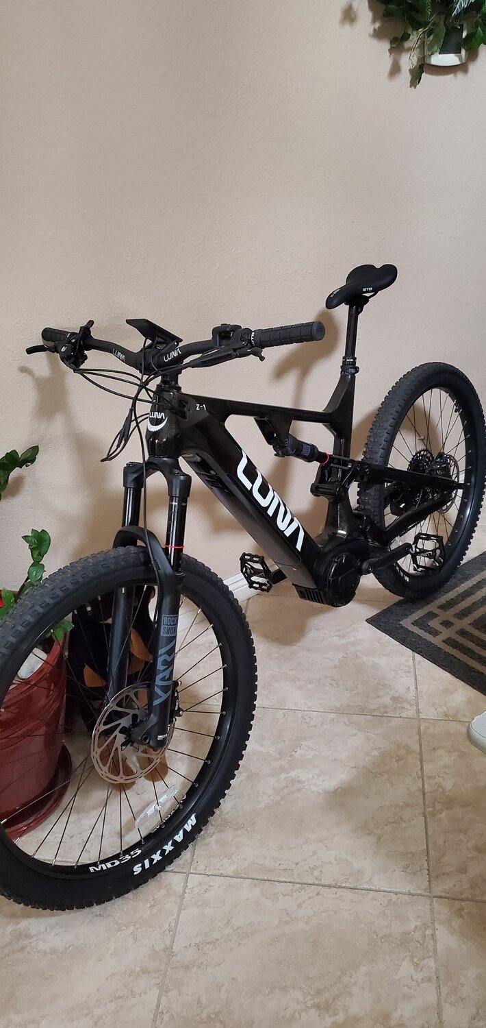

I have not been able to take my Z1 out yet bc the roads are too salty and snowy in MN. I’ve been staying on my fat tire with the same bafang G510-620 mid drive motor. Listening to all the battery range posts has made me concerned and I started searching for another battery to get before the snow melts. Hard to find anything for the dengfu e22 so I reached out to Luna about acquiring another battery. They responded quickly letting me know they plan to have them available soon but not right now. I also asked about the specs/ size battery available through dengfu maybe. I have pasted a helpful response from Luna below with a link to Alibaba.com.
Luna’s email response:
You could purchase a dengfu e10 battery on aliexpress however.
I would email the seller first to make sure you get a 40A BMS inside.
You need a minimum 40A BMS for the Ultra motor.

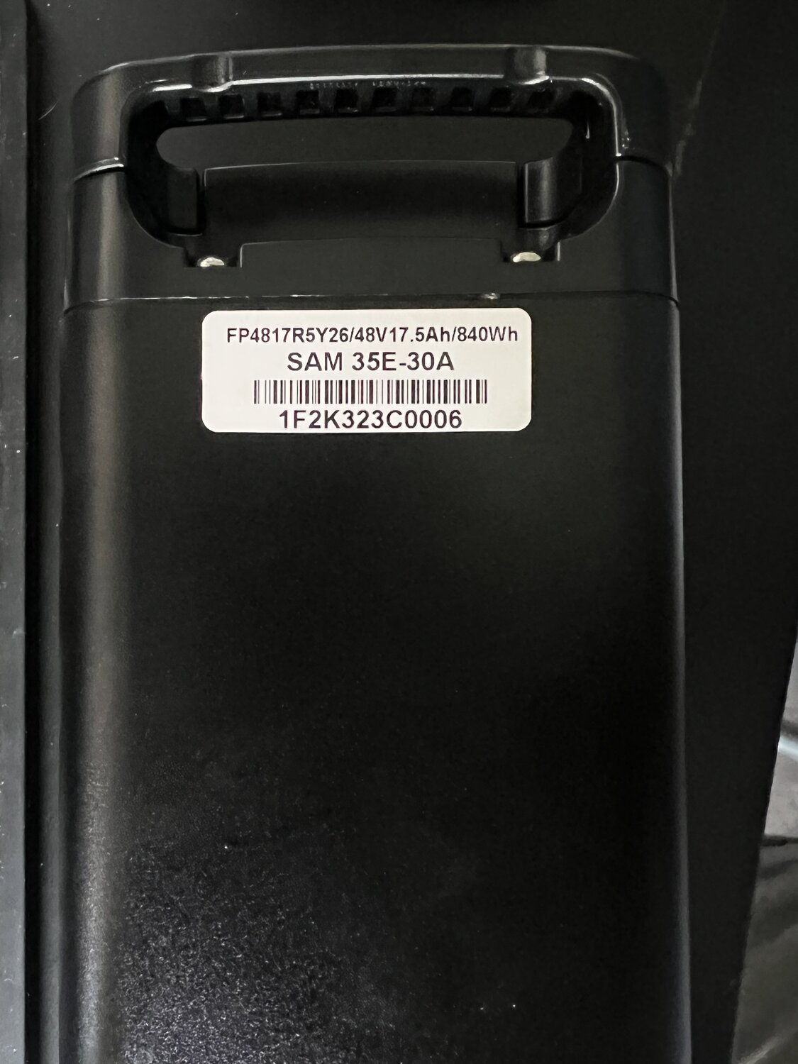

The battery I got from Dengfu looks to be 30A, and it does not bypass the battery power switch.
Here is the label on the battery
