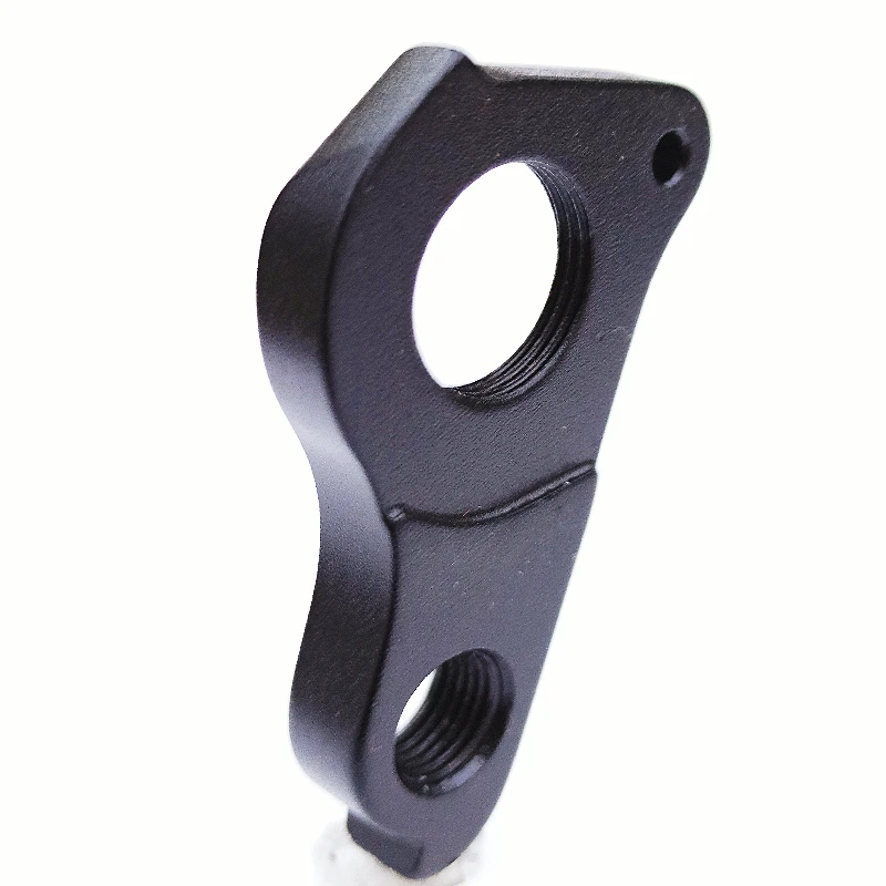

Funny as it sounds derailerhanger.com is legit. They can make copies of what you need. get it before you need it. Got (3) for mine and they match up fine, hopefully I won't need them but cheap insurance.

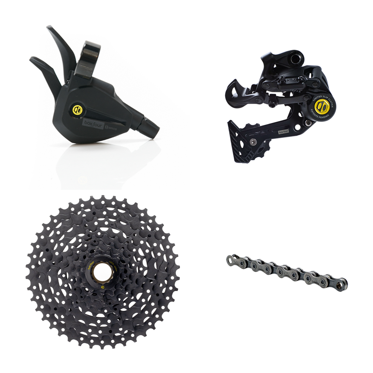

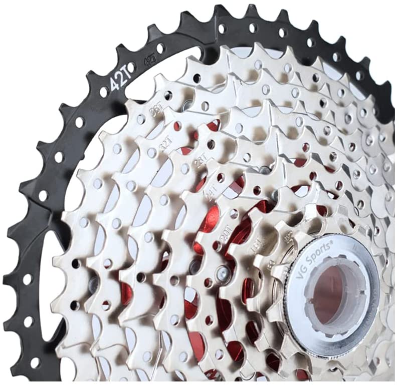

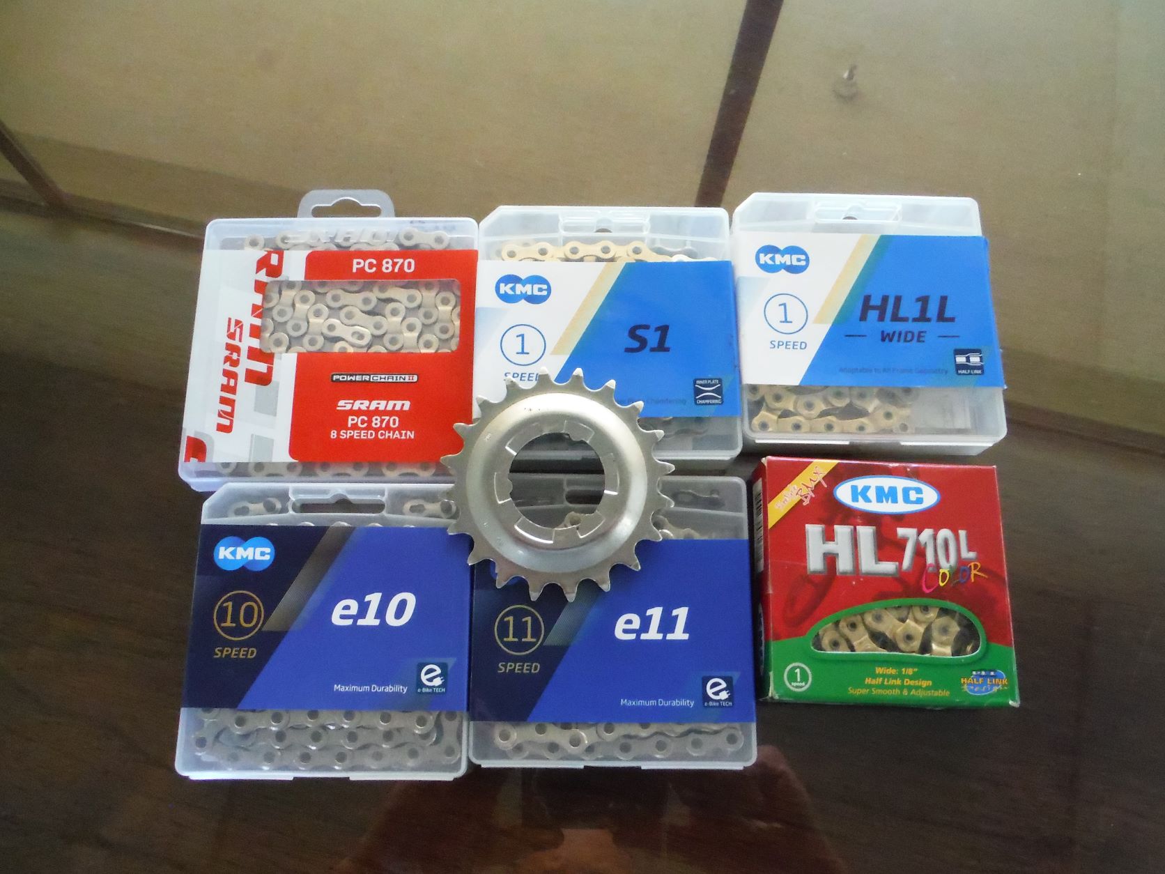

My Chisel was an 11-speed. I made it a nine. 9-speeds are thicker, or wider and they cost less. I like the KMX X9 chains. Here are a couple of Christmas Luna X2s. I made hers with a more comfortable cockpit and saddle. I might upgrade their drivetrains to 9-speeds when they eat the first cassette. That can happen very quickly on these bikes. Here is also a photo of where I ride. If you want to view custom builds see PedalUma.com for some ideas.

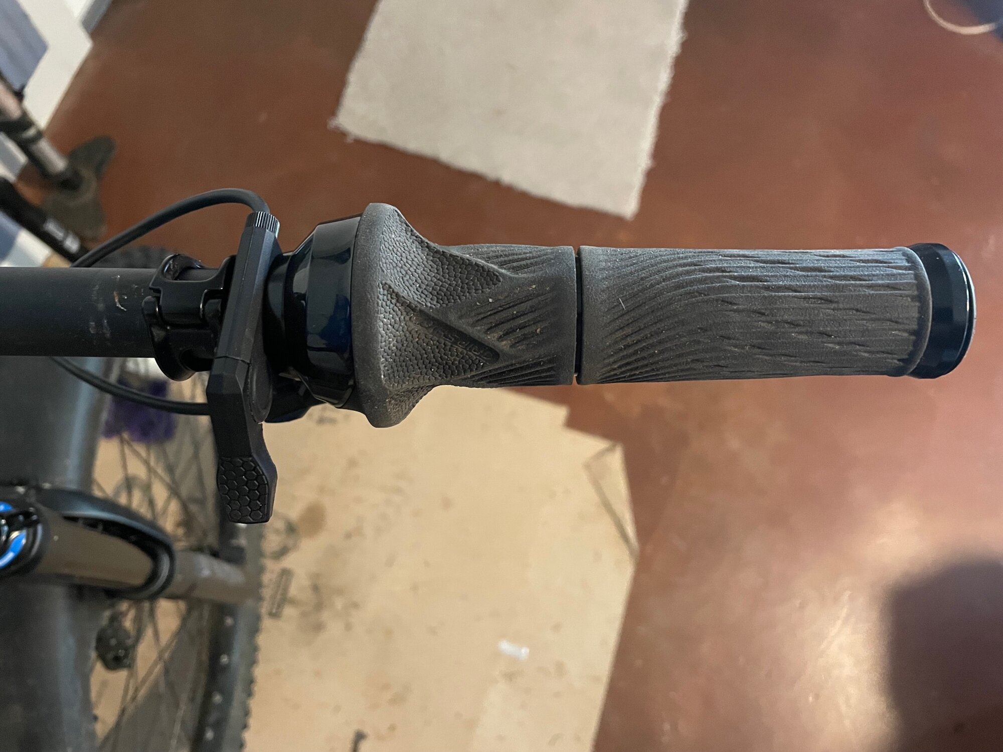

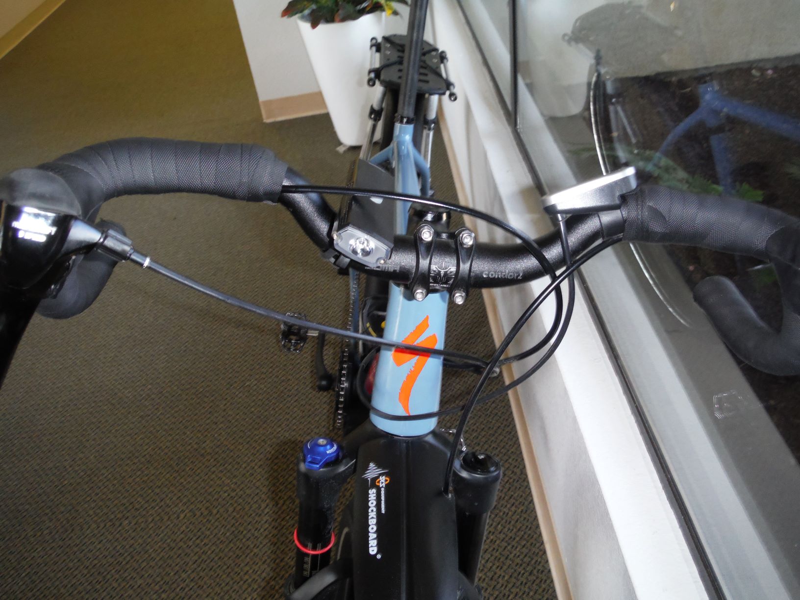

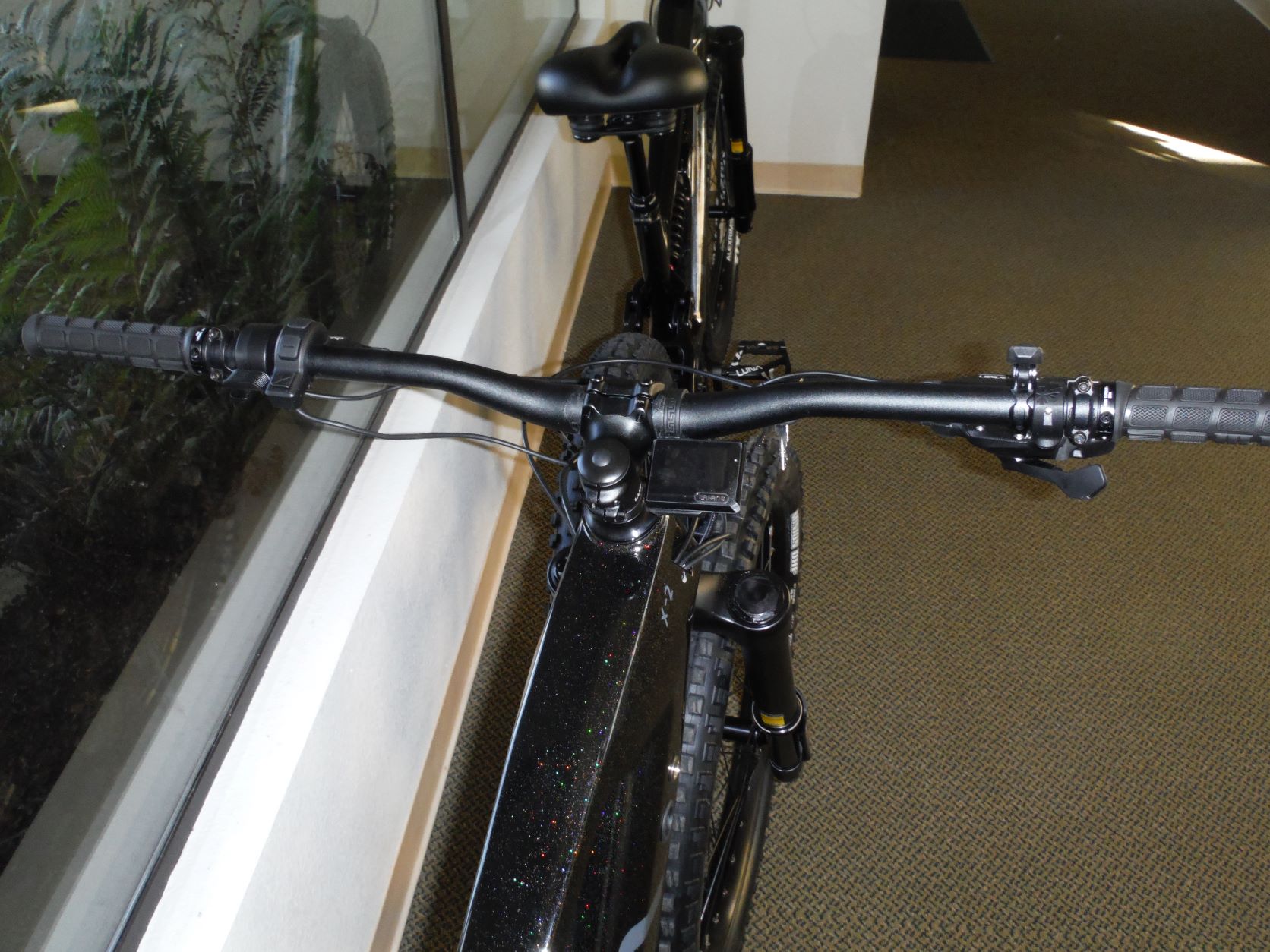

I run my throttle on my Z1 on the right side and after seeing the possibility of a narrower format one made over in Polska I contacted the maker and got him to send me some. Biggest difference for my needs is that they are 5/8" narrower than stock and are also ergonomically correct for my needs. Caveat here is that I have never had a motor assist bike without a throttle on it and have a pretty good idea of what it takes to make it feel right.
What it did for me also was move my brake lever over so I can easily cover it with at least 3 fingers now instead of 2.
My bike suffers from the stock jumpy throttle, at least until I can get it flashed, and if you press it at the bottom of the lever it will go full blast easily. However pressing on it close to the pivot point it is easy to feather it.
It was a plug and play install btw as Marek made the switch to Bafang style Higo's before sending out.

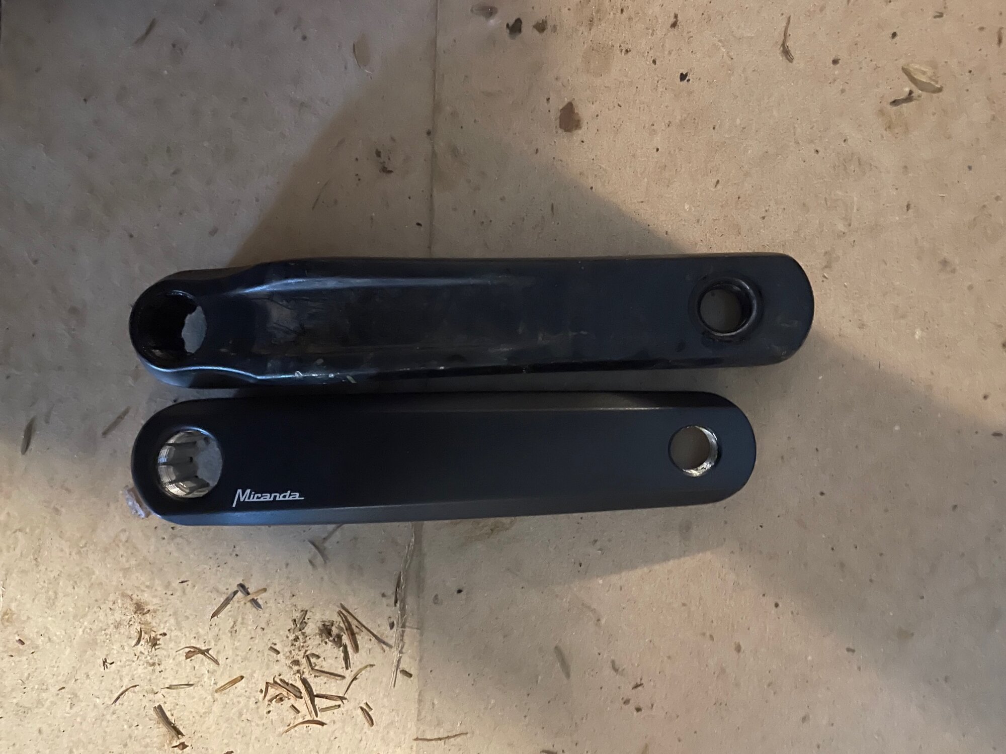

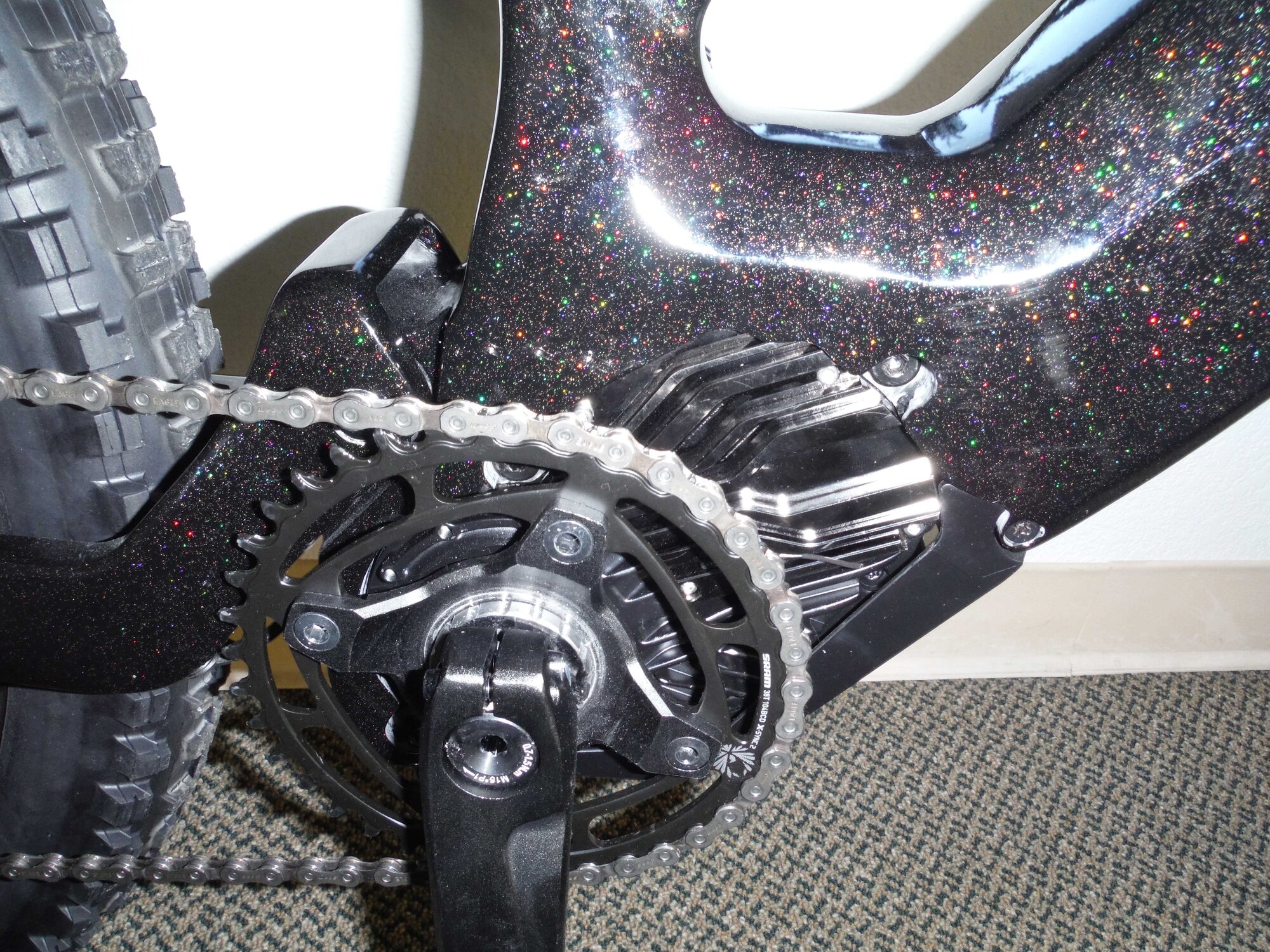

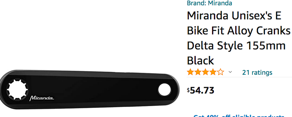

Also got my 155 Miranda cranks from Australia and installed them. Pic showing that there is a definite difference in length!
Also got my 155 Micanda cranks from Australia and installed them. Pic showing that there is a definite difference in length!
165 crank arms are for some downhill MTB applications where you want to avoid a pedal strike on suspension stack situations. That is when the suspension compresses again and again before it can rebound. Most crank arms are 170 or 175 on large bikes.

Im gonna say that even the 165mm cranks are to long for a full travel bike, I don't think a DH bike really matters as there not really pedaling much at all. My bike motor I got from WW came with the Miranda 170's right out of the box and I think I gave it 2 -3 rides before nixing that noise. The 160's make a big difference in not having pedal strikes and I know a couple of people that have the 152, 150mm sizes on their full suspension rides as well and they like them just fine. Just ordered another pair of 160's from Praxis over in the UK as I came to an abrupt stop in between a couple of big rocks awhile back and actually bent the non-drive side crank arm. So my pedal stroke was wonky making a full revolution. Took it off and clamped it in the vice and straightened it the best I could but after looking at the splines on the inside some were starting to round off so I got the new set. Think I payed $65 or so shipped and it took less than two weeks. Couldn't find the Miranda Delta 160's anywhere. The praxis looks just as good and they even come with their own crankbolts, we'll see.

To me pedal strikes are for sure a thing to watch out for and always have been but for sure the advent of long travel suspension has upped the odds of it happening so a new sense of awareness has to be learned I feel. #1 for me was the reality that you don't want to post on your bike with a crank in the 6 o'clock position even on relatively benign looking terrain as there is a good chance if your suspension compresses it will dig into the ground and stop your forward progress pronto.
Quite frankly I had not considered shorter cranks until the Z1 and resulting results of the formerly described incident being taken as a warning and after talking to a friend that has them on his Levo and swears by them I decided to get with the program. Got these from Amazon:
Got a chance to trial the shorter crank arms yesterday on some substantial hill climbs close by my house. Aside from the strike issue I was curious as to how the decreased leverage would effect hill climbing ability but at least with how the stock programming is set up on my bike the only thing I noted was that if I used a high cadence, which I am apt to do with assist, there are no penalties to the shorter levers. Took a few rough routes to check for strikes but only time will tell how it all works out but optimistic that it is the right choice and a relatively cheap solution that is easy to swap out.
I do doubt it would be worth it to only go to a 160/165mm crankset though as in for a dime in for a dollar and switching to 150 or 155 seems to be at least a readily available option anyway.
As far as the throttle goes the fact that I pay attention to detail with it is not so that I can use it while under way as I only use it for starting off most of the time until I activate the PAS via the cranks or as a walk assist which I find works well and is always ready to go. The jumpy nature is in regards to the fact that as my bike came stock if you activate the throttle from a standstill you had better be ready to hang onto the bike as it will buck like a rented mule....it can be regulated however with a more gentle approach and the new one is better for that than the stock one. As I said the narrow factor also is a plus for how I like my controls to be oriented.
Another thing to consider when going with a shorter crank arm is your seat height will probably need to be raised up as a result of your pedal stroke not being as full. Food for thought.
Does anyone feel that a 12 speed e-mtb is prob not necessary and a 8-9 would be a better fit? I feel with a Ultra motor, there would be plenty of gears for most riding. I live in mostly flat lands, but even for other locations, it sounds like 8-9 speeds using a powerful Ultra motor would prob be optimal? Plus the benefit from a larger stronger chain to support the power when/if needed seem like a better overall setup? It doesn't look like Luna will offer this, so I would have to customize once purchased. Its an option, but would be nice to find a bike setup this way from the factory.
I know there is never the "Perfect" ebike for everyone, LOL.
Yep. So does Box Components, and Shimano. Box pushes their '8 is enough' and 'Prime 9' for ebikes, while Shimano is expected someday/sometime to release 'LinkGlide' for eBikes, although I believe it's in 10s and 11s, but same general idea.
I've gone back and forth on Box, with some noting they believe their cassettes (possibly derailleurs as well, others?) are made for them by Sunrace, and reviews are kind of mixed.
Microshift isn't e-bike specific but makes a clutch derailleur setup in 9s at the least.
I had a line of a full set of Shimano Linkglide components overseas but - couldn't get the chain, which apparently is claimed to be specific.

This should be the one for the X1 and X2 - unsure if the same on the Z1.
If not, get a pic and send it to one of the aliexpress derailleur sellers and they’ll find it…
Did anyone ever determine if these are the correct hangars for the Z1? I bent mine this weekend and its only a matter of time till I break one, would like to get a pare to have on hand.
