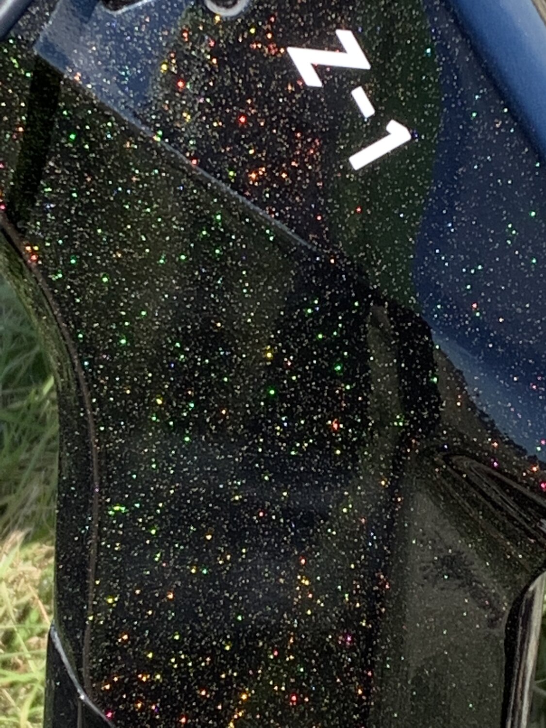

Tried to take a photo of the Galaxy paint in the sun. Photo doesnt do it justice. It’s really sparkly.

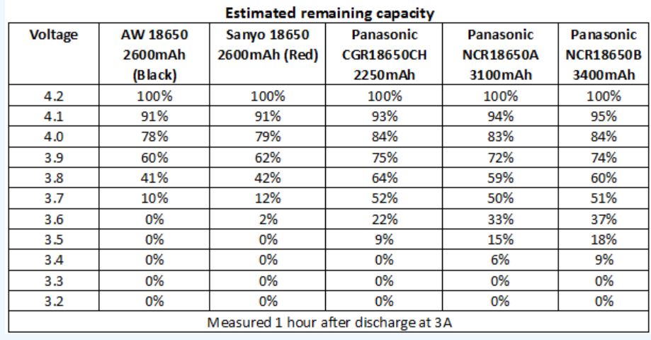

I've got a few more cycles on my Z1 battery and I'm keeping an eye on range. Today I got about 24 miles range on mainly flat terrain with some moderate hills, mainly in PAS 1 & 2. My display was at 9%/46.5V when I returned, about 3.6V cell. Whether this is near fully depleted depends a lot on the specific battery chemistry and manufacturer (see pic). I never hit the LV cutout or felt any power reduction. After about a minute the voltage recovered to 46.9V but only jumped to 10%. After an hour sitting, my display was up to 25% and 47.4V, about 3.65V/cell average. I'm not exactly clear on the specific algo Luna/Bafang is using on their display, but I'm somewhat encouraged by the moderate range improvement after a few charge cycles. I get about 35 miles range on my hub drive bike on similar terrain with a slightly smaller 16AH battery.

That is still around 30wh/mi which is at least 10wh/mi more than I would like.....

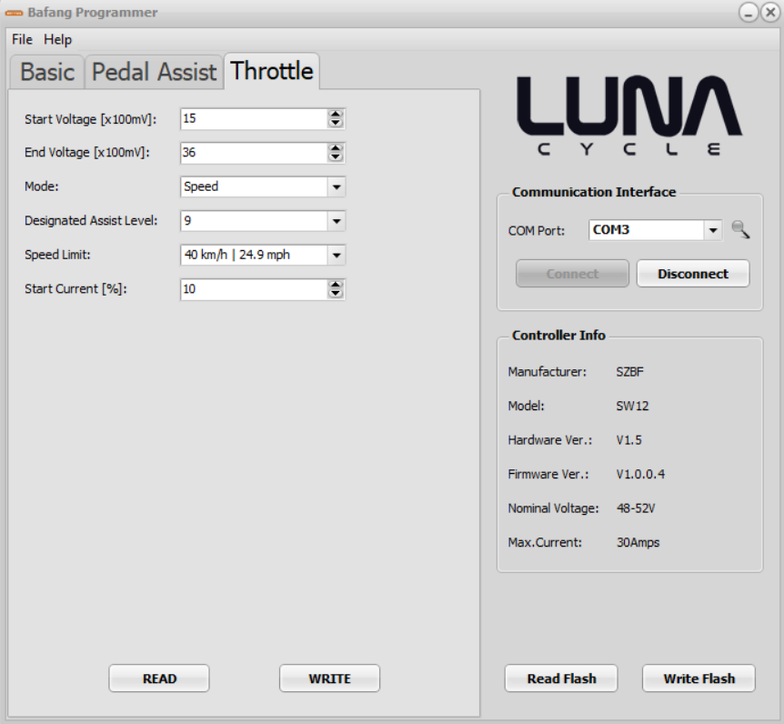

Thanks for the advanced tip. I at least want to try and change the settings to 9 to see if it will dull mode 1 some spreading out the percentages? It is a little touchy doing "the move" if you know what I mean....Otherwise I just got a programming cable today and going to try and do the deed from a Mac, wish me luck...Edit: While doing research on how to ran into this that says you can lower the LVC to 38v: https://endless-sphere.com/forums/viewtopic.php?t=99669 Caveat there is what cell structure/ah they are but if they are good cells they should be able to handle it but ultimately it is the bottom safety line of the controller that dictates.

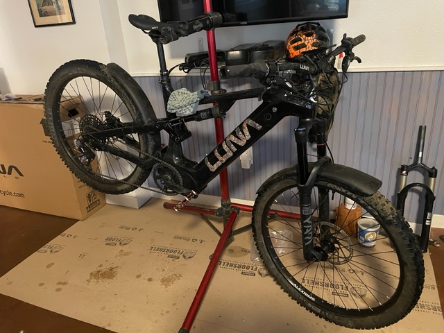

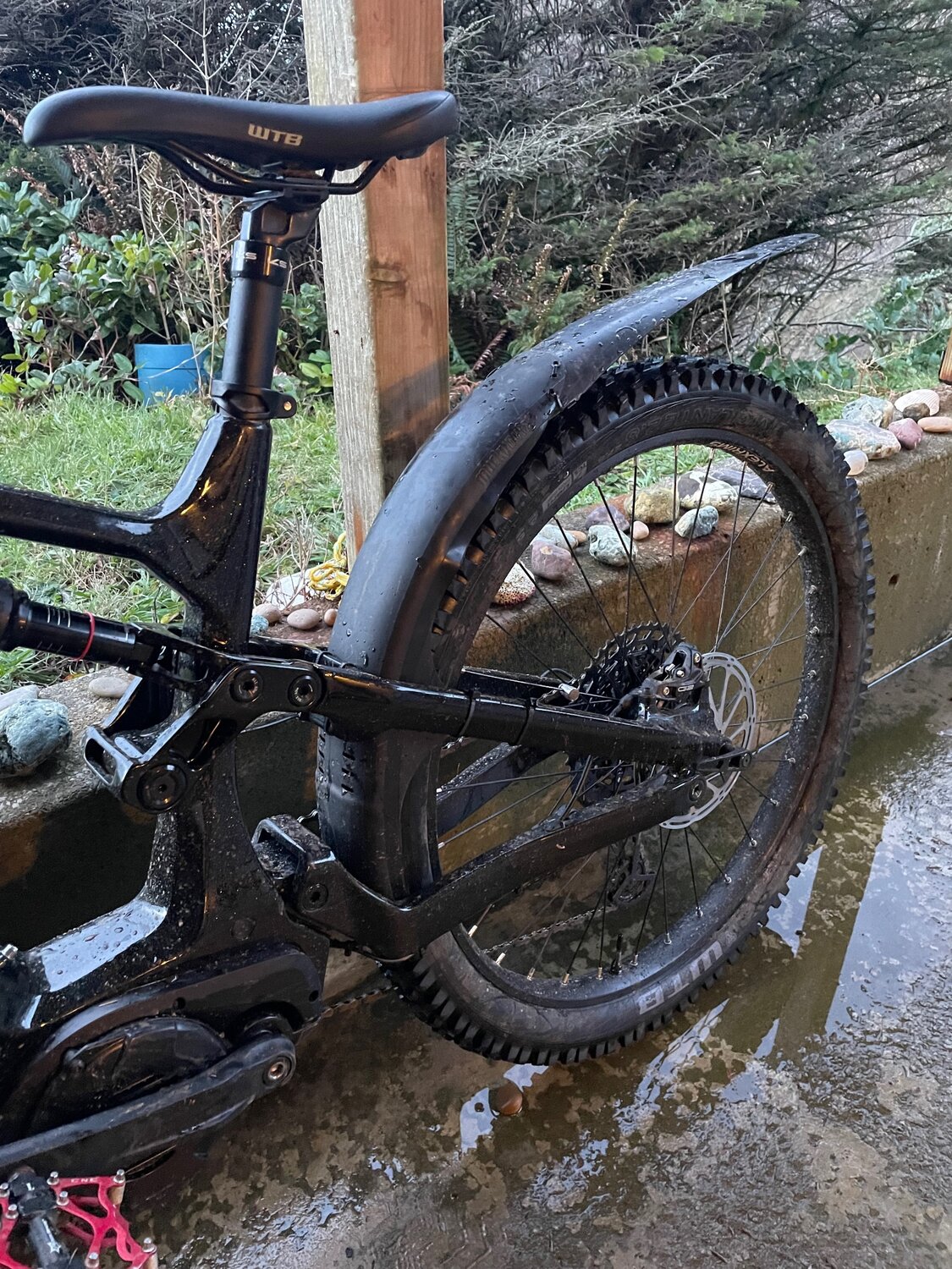

Finished dialing in the rear fender. Took two extensions and a heat gun to get the spray pattern on my coat the way I wanted it, barely there. I have not complaints with the stock front but might put a flap on the bottom to combat build up on the motor.
Finessed the dropper into working order and set to the right height but not happy with the lever so have a new one on the way that I think will have better access.
Jon!'s suggestion about setting to current worked great for the throttle btw. Made it way less touchy. However you want to treat it with respect as it will go to full power if you grab enough of it. Hasn't happened to me because I'm wise to it but trial rides for now are cancelled......
Key factor over the long rear specific ones I mostly saw is the coverage I get between the seat and chainstay that protects that pivot shelf.

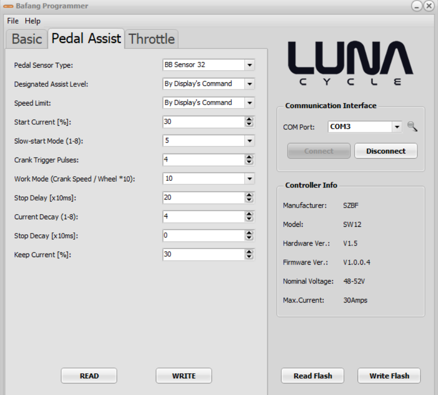

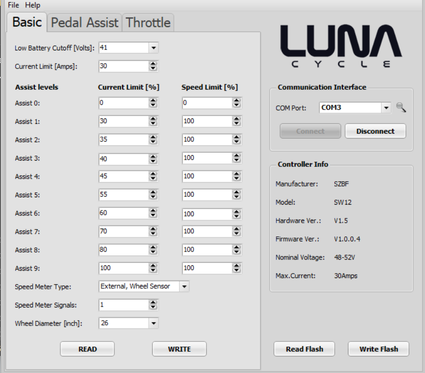

Alright, I purchased a Bafang cable and connected to the controller. Here were my settings. Of note, my low battery cutoff is set to 41V. I'm not certain if I'm in the "bike dies at 46v camp" because I don't think I've taken any rides long enough yet, but now I absolutely need to do a range test. While I was in there, I did smooth out the assist levels. Haven't tested to see if they feel better as such. Hopefully Friday.
  • Like
Reactions: JRA
Your wheel size is wrong if still set to 26, should be 28 which is what a 27.5 measures in a plus tire.
Interesting that the LVC is set to 41v which is pretty standard although it could be set lower depending on what the actual BMS is set to go off? Seems like a volt above that is doable as long as it isn't stressed every cycle.
