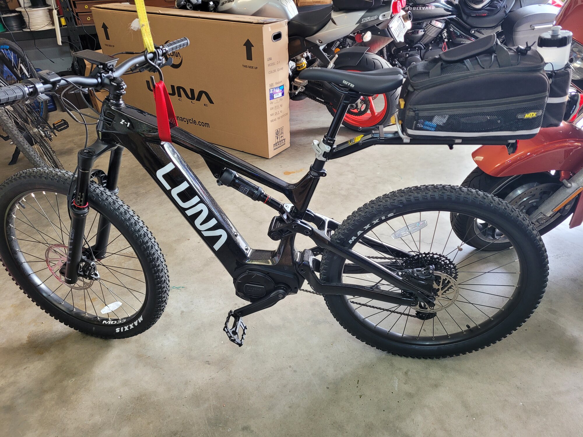

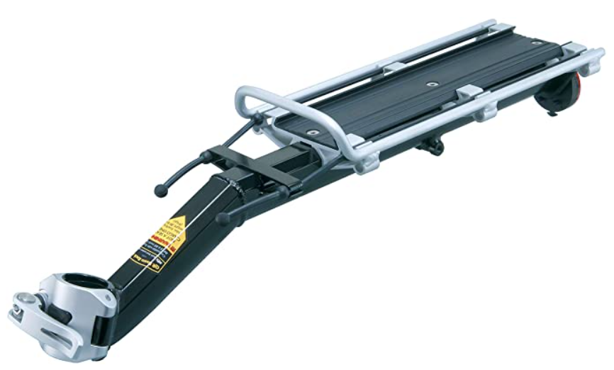

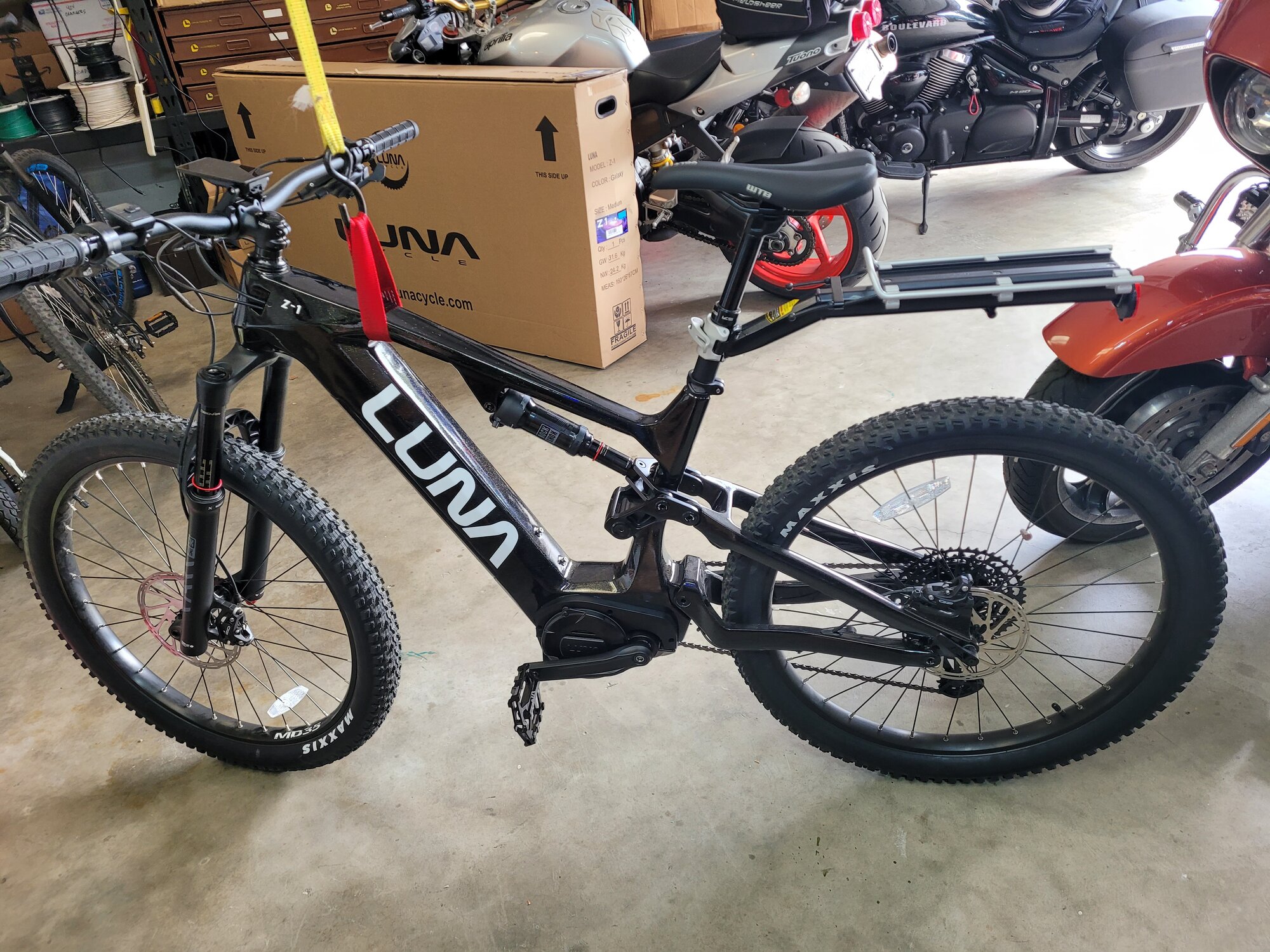

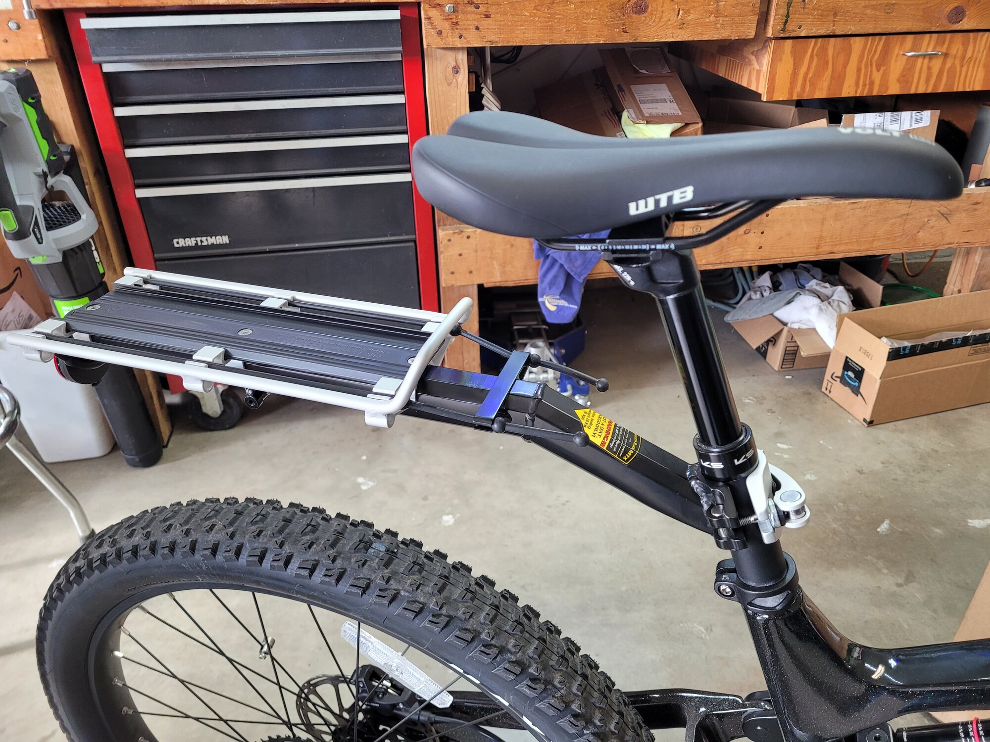

I've already got the MTX bag that slides on this rack from my other bike so it was easy to keep things in the family. There's concern that the clamp may prevent the dropper from actuating so I'm going to be the guinea pig with this.
So far I'm pretty impressed with the rack. I was worried about slamming a metal clamp on my alloy seatpost tube, but there are rubber inserts that attach securely to the inside of the clamp so they won't scratch the painted tube. I think I've got plenty of rear tire clearance. I'll have to see if it moves around.
