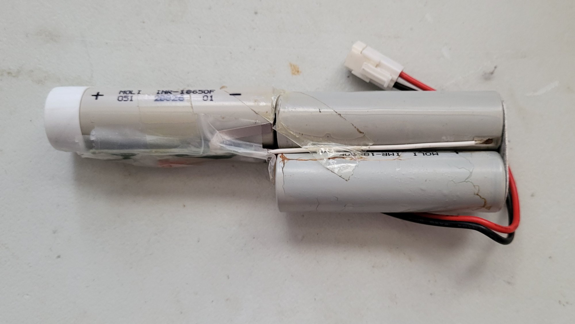

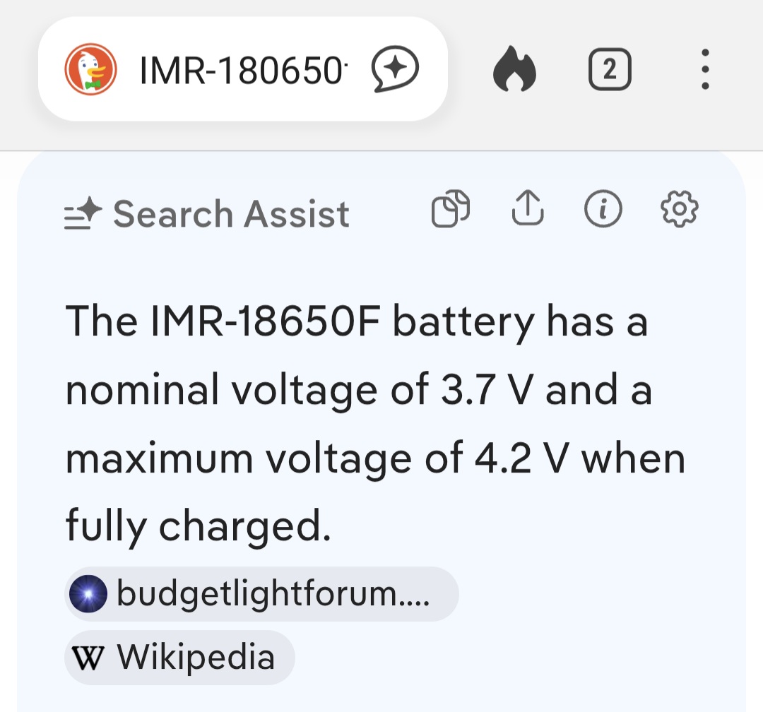

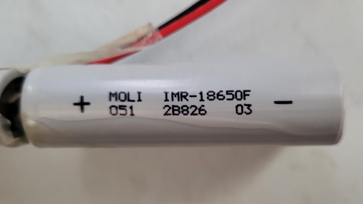

This is a "standard" 12 volt Li-Ion battery pack,..
3 cells in series. No BMS.
(I peeled off the plastic shrink wrap)
It was from my mother's electric bathtub chair/lift.
It was charged with a simple 12vdc power adapter that was always plugged in and connected directly to the battery, so it was always charging.
(the adapter didn't have enough power to operate the chair on its own)
There was never any "overcharging" type issue because the cells never reached full charge, but mom did manage to kill the battery.
(she thought that if she held the "UP" button on her remote long enough, the chair would eventually lift up higher. Lol
Took 5-10 minutes to kill the battery pack.)
Even when the battery pack died, it didn't burst into flames. It just lost most of it's capacity, and would only lift the chair an inch then you'd have to wait for it to "recharge" to get another inch of movement.
(We ended replacing the battery, and adding a switch to the lift mechanism that would turn off the power when the chair was at the top position.)
FYI, you can't connect a simple 3 cell lithium pack to a car because the alternator running voltage is frequently over 14 Volts.
(12V car batteries charge at ~13.8 Volts)
That would be 4.67 Volts per cell, and you'd cook the cells.
If you added a fourth cell in series, each cell would only be at ~3.5 Volts which is almost useless and too close to "empty".

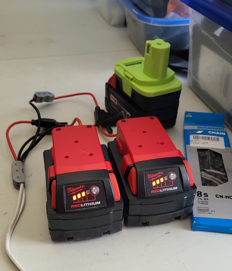

I managed to hook up two Milwaukee 18V batteries together to run my old POS ebike,..
The old SLA 12V batteries crapped out, so I bought a 36V 8ah Li-ion scooter battery pack which does have a BMS.
@6zfshdb Do you happen to know if Milwaukee has the LVC in the battery?
My ebikes' controller will apparently shut down at LVC, but I've never had it kick in, (especially running the lead acid batteries) but I'm not sure if the LVC is different for an ebike expecting to run off SLA batteries?
It was you that informed me about the LVC being in the tool, and I proved it by plugging my "dead" Ryobi battery into my Ryobi worklight, and the light worked but the battery didn't work in any other tool.
My Milwaukee batteries do have a built-in bar graph display, and I've got a voltage gage on my ebike as well, but I guess that I need to keep in mind that it's possible to over-discharge my batteries?
@6zfshdb ,.. thanks for informing me about the battery adapters that are available.
I had no idea something like that was available.
(I thought I'd have to cannibalise an old battery to get a "connector ")
I bought 4 adapters (intended to be used to power a child's electric ride-on toy) that work great to easily connect my batteries to my ebike without soldering.
I also bought a couple Milwaukee-Ryobi converters to use my Milwaukee batteries in my Ryobi tools.
The adapters have a USB port, so I can use my batteries as a power bank.

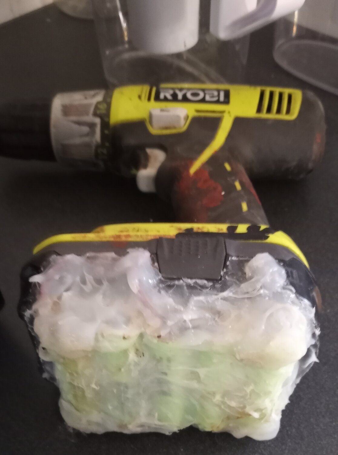

Well, now I'm confused??
I remember us talking about that a couple years ago,..
I managed to get my Ryobi flashlight to work when the battery didn't work in any other tools??
(Maybe it's got something to do with LED "bulb" ?)
I'm just going to assume that Non of my batteries have a built-in LVC, so I'm just gonna have to keep an eye on the batteries.
My Milwaukee batteries have a "fuel gage", but the original Ryobi batteries have no gage.
I've got one new Ryobi battery that has a gage, so I retired this Ryobi battery that I Turbocharged. 😁
