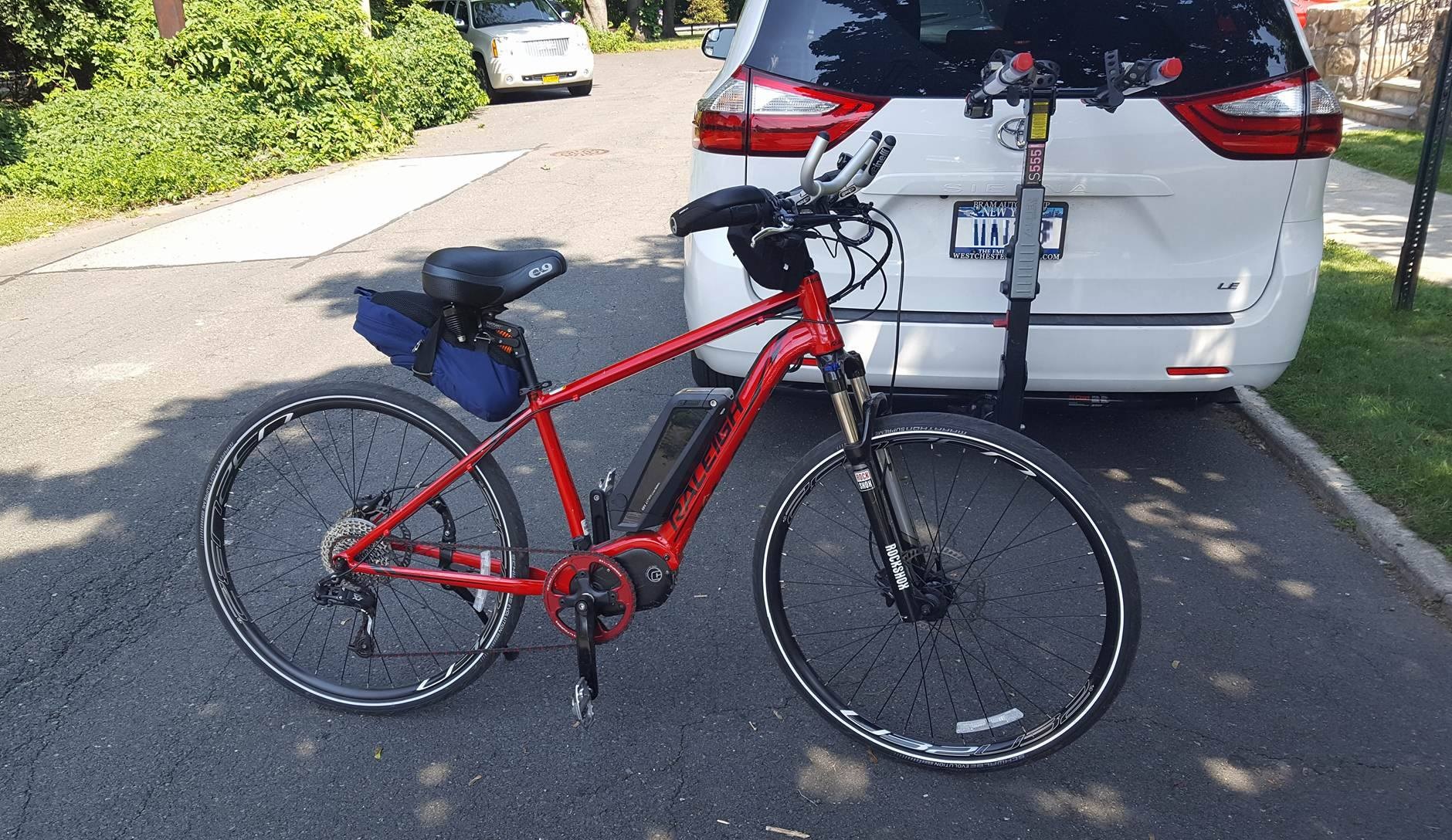

Red. The fastest color. (scientifically proven to be!)2015 Raleigh Tekoa IE, changed the standard 42 teeth steel chain ring to a red 46 teeth narrow-wide aluminum chain ring. Went to a Bike Sunday today where the Bronx River Parkway (Westchester, NY) was closed to car traffic for 4 hours. Total distance ridden was 52 miles and the ride time was 2 hours and 20 minutes. Average speed of 22.29 mph for the whole 52 mile ride.

The Tekoa's TranzX motor is similar to Yamaha, it thrives at the lower cadence range of 60-80 rpm and losses steam beyond that. I quickly leaned that if I stay within the cadence window, I maximize the performance and range. At 28 mph, the cadence is 90 rpm, so I had to increase to PAS to 4 (max assist level) in order to achieve that. With the new chain ring, I can stay at PAS 3 and still reach 28 mph (@80 rpm cadence). The new chain ring is about 10% increase in gearing at the top end, or equivalent to having an 11th speed. However, you also lose the equivalent 1st speed gear ratio, since it's is now transformed into a 2nd speed. I never missed the lowest gear ratio since the new change is still adequate for climbing hills.LOL! I want to believe what you say about red is true since I really love my recently purchased old new stock red Tekoa. It looks like a twin sister to yours except for the neat chain ring mod. That is an extremely impressive average speed for that distance. So do tell how that mod factors into both that timed fast ride and in your other rides. There are positive/negative aspects to such changes, but do the positives outweigh the negatives, at least in your riding needs? I feel certain they do, since you contemplated and then put in the effort to make the switch. Would love to hear a bit about the difference you can feel and/or measure.
The Tekoa's TranzX motor is like the Yamaha, it thrives at the lower cadence range of 60-80 rpm and losses steam beyond that. I quickly leaned that if I stay within the range, I maximize the performance and range. At 28 mph, the cadence is 90 rpm, I had to increase to PAS to 4 (max assist level) in order to achieve that. With the new chain ring, I can stay at PAS 3 and still reach 28 mph. The new chain ring is about 10% increase in gearing at the top end, or equivalent to having an 11th speed. However, you also lose the equivalent 1st speed gear ratio, since it's is now transformed into a 2nd speed. I never missed the lowest gear ratio since the new change is still adequate for climbing hills.
