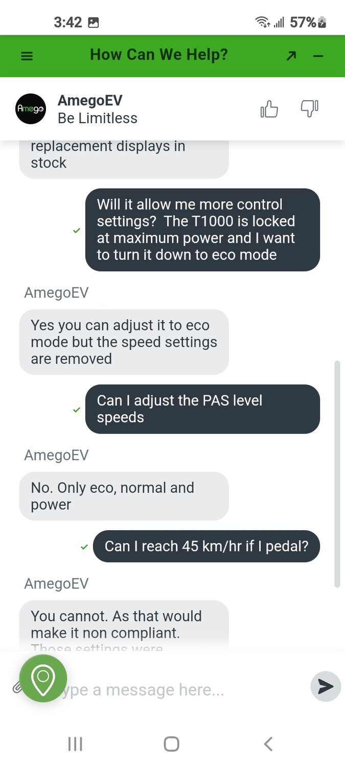

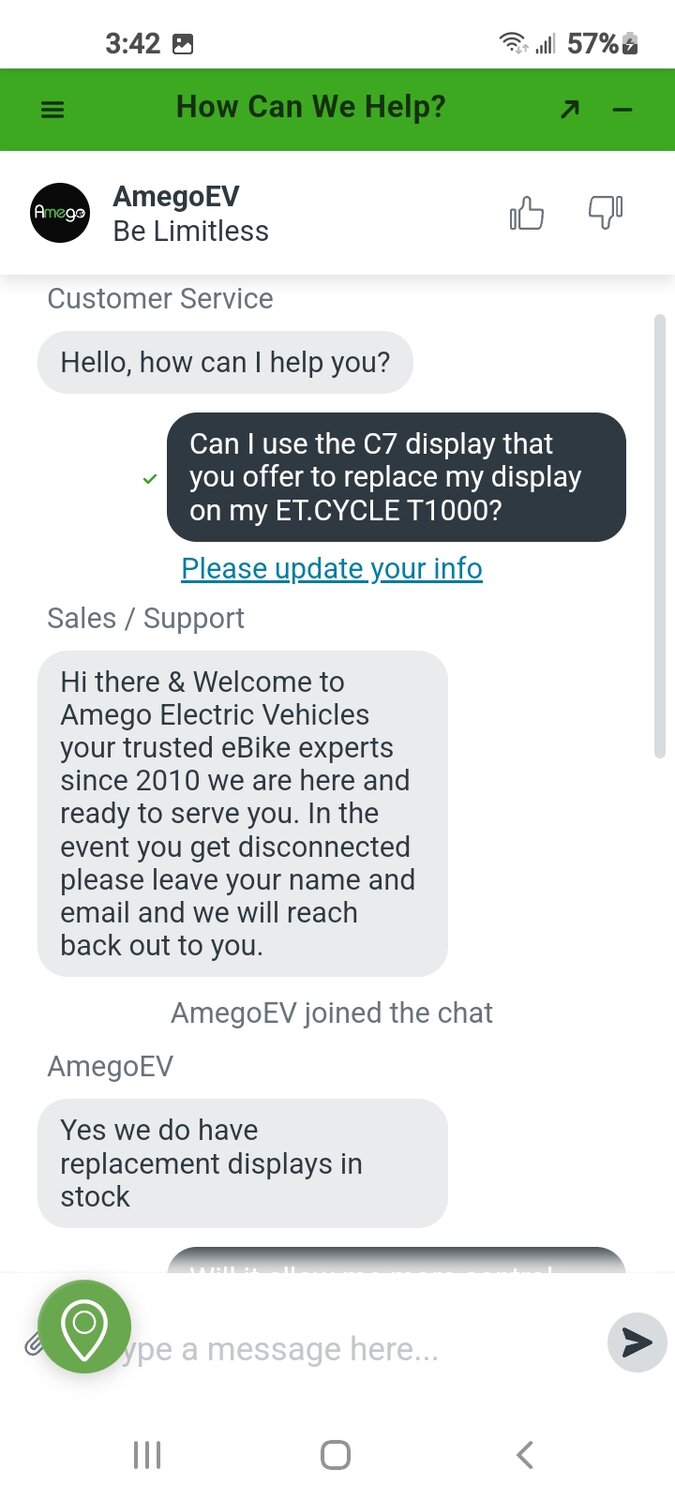

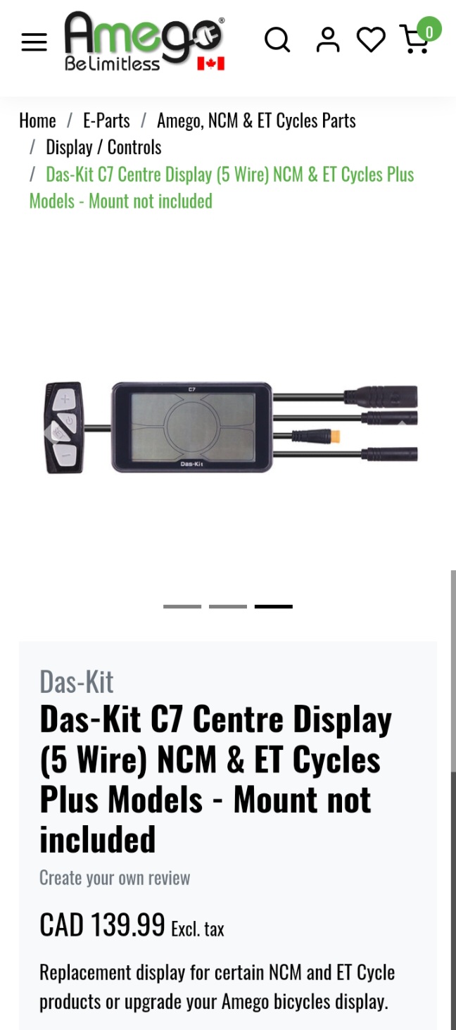

Amego sells a replacement C7 Display for $140 plus tax and shipping that will allow you to turn the power level to ECO mode which should help with reducing the Kick when the motor cuts back in.

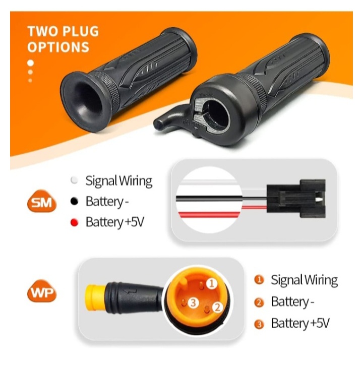

Almost all the twist and half twist throttles have a male julet plug, and our Das-Kit needs a female plug.
This full twist throttle has the female julet plug that we need, but it is full twist and the wire is a lot longer than we need.
This half twist throttle has a shorter cord, but it would need a double ended female coupler to plug it in.

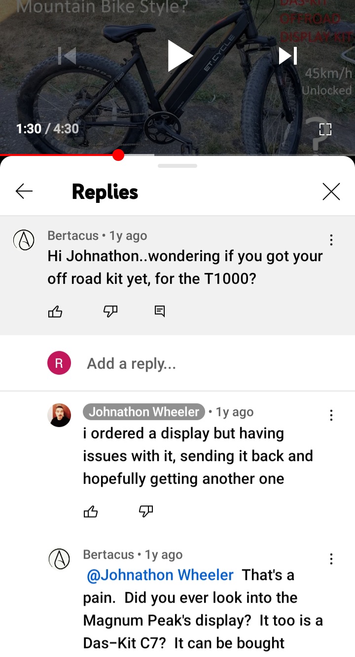

I did see a You-Tube video where someone changed the display to a Das-Kit C7BBT which he had to order from Australia but haven't seen the results yet.
I saw that video too and he hasn't updated.
I'm pretty sure it's working fine, but it's illegal so he probably doesn't want to post anything about it.

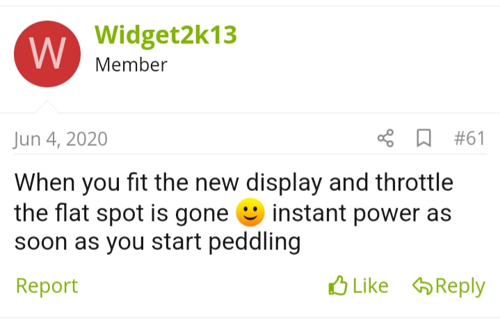

I am almost positive that the Australian display will work with our T1000's but the lag after you stop pedaling and start pedaling, will still be there in any PAS mode.
EDIT: I found this post about the Australian C7 display in the throttle thread..
It looks like the Australian display does eliminate the lag when you start pedaling.

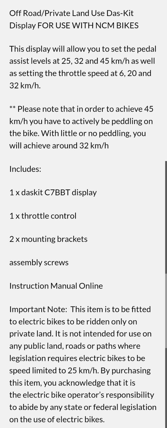

I found a place in New Zealand that sells the off-road C7 display, and they list it as compatible with the T1000.
It is quite expensive and only comes with the display and not the throttle. (but we already have that.)
And a YouTube video showing the operation of the display.
So, it looks like the C7 Off-Road display would alow us to both turn down the power, and eliminate the lag before and after we stop pedaling.
And, we can set it to 32 km/hr to be legal in Canada 🍁.

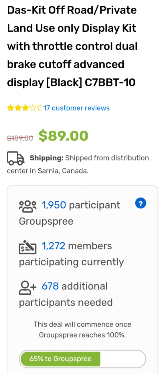

I also found a "group spree" purchase for $89, but I don't know if this is in Canadian funds, or if you have to pay up front and wait for 678 more orders, then maybe 6 months to a year to get them from China?
(Or if it's a scam??)

I did see a You-Tube video where someone changed the display to a Das-Kit C7BBT which he had to order from Australia but haven't seen the results yet. I'm wondering if anyone has a solution for this ? Is it possible to buy an unlocked Das-Kit C-7 Display ?
I watched that video again, and read the comments and found this,..
He was having problems with the display and sent it back.
I don't think that he updated anything about it since.
That sucks for me, because I bought one. Lol

I did find this though on the Australian website,..
To go 45 kph, you need to be "actively pedaling".
I think that the guy in the video thought he could go 45 kph without pedaling?
I have no interest in going 45 kph.
I want to turn down the power and turn down my throttle speed.
And the off-road display apparently also eliminates the lag when you start and stop pedaling.
So I think that this display will work perfectly for my needs.
The display from Amego is $140 plus $25 shipping and with tax, comes to $186.
I got the display from New Zealand for $225.17 CAD which allows me to turn down a lot more settings.
