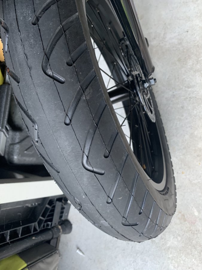

After reinstalling the new tires the right direction and dialing in my tire size in settings I did some speed tests today. I had 3 runs using GPS and display where I briefly hit 31mph in 7th gear(11 tooth) PAS 5. The motor will cut out at 28mph if you don't change it above 45kph in settings. The tires were at 35psi and they are quiet and awesome for street riding!

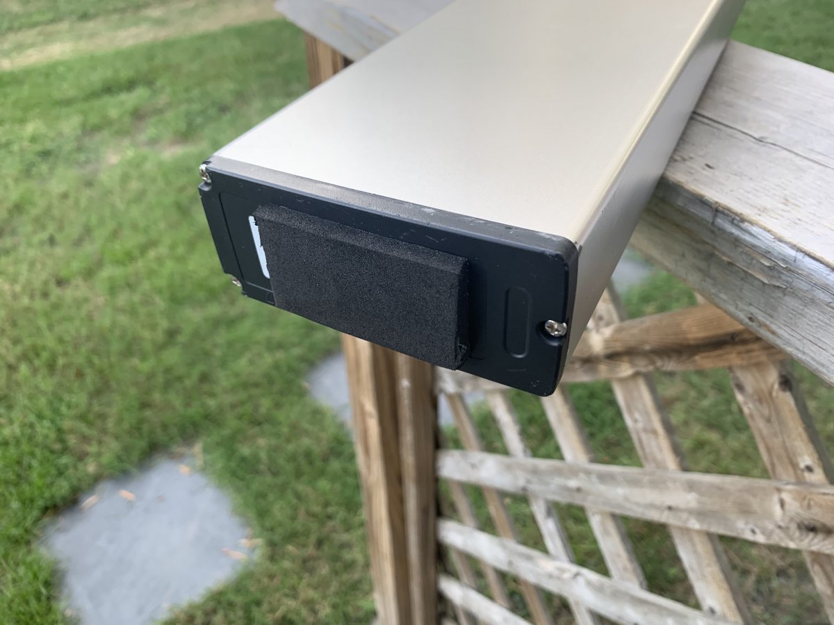

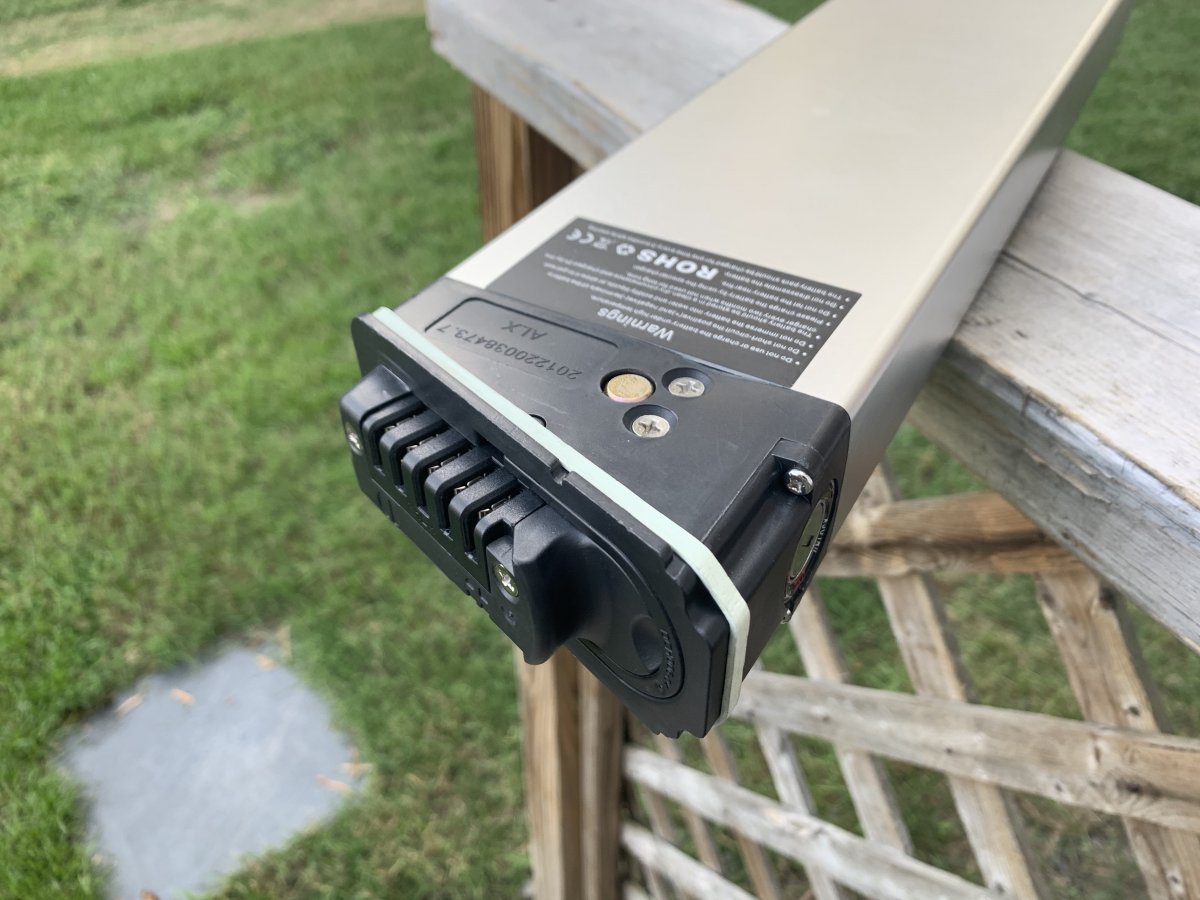

I put a piece of weather stripping on the back of the battery and a thick rubber band around the front to eliminate all rattle. (pics below)

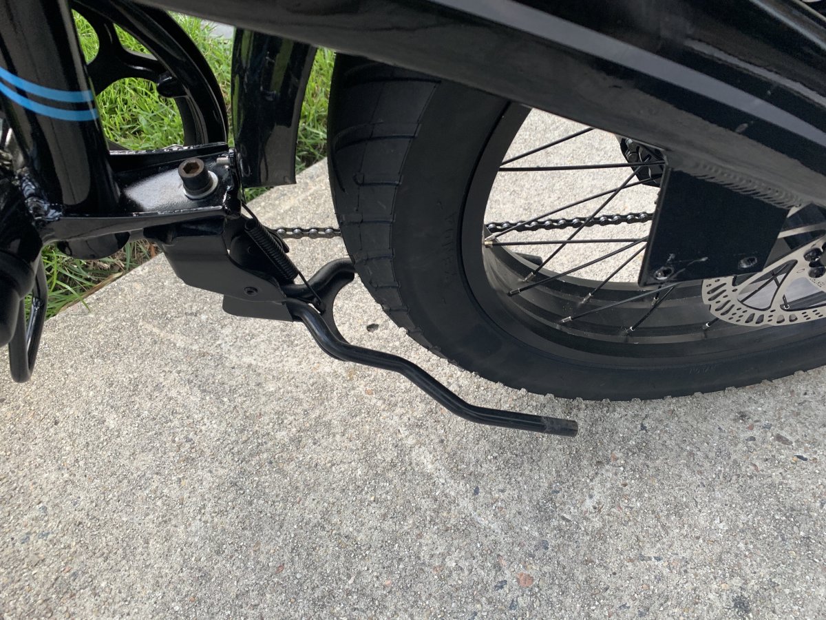

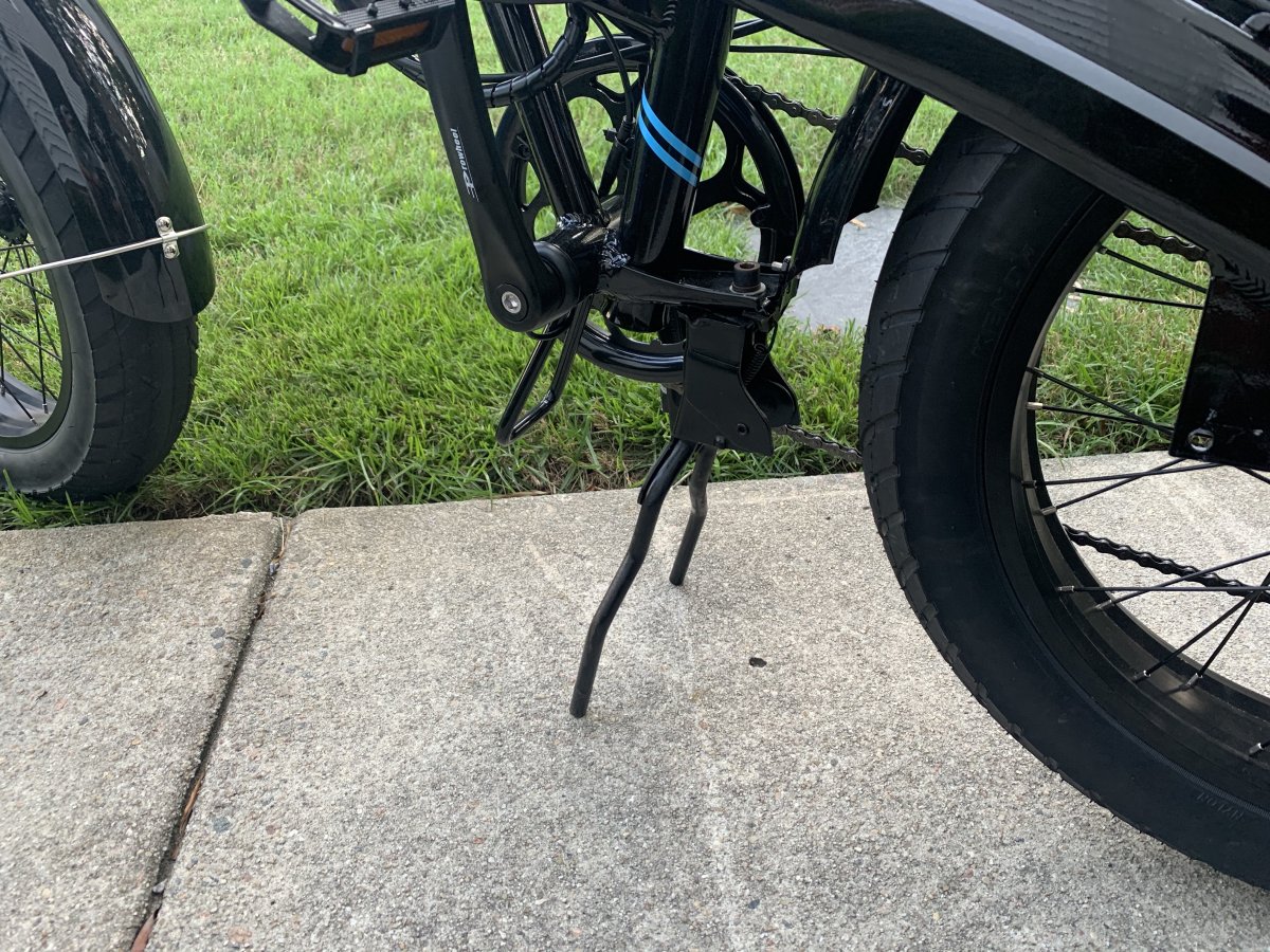

Installed a dual leg kickstand from a junker found on trash day.

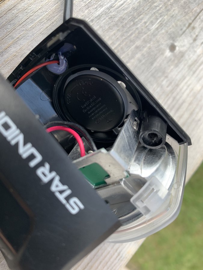

Hid a Trackr Bravo with double sided tape in the headlight just in case it goes missing!?

Love the tires
The tires and new gearing make acceleration and maintaining speed much better. They ride great and are quiet. You can inflate them to 35psi, I installed them backwards in my rush to ride. Will provide links.
Tires
Freewheel
I liked the tires until I clicked on the link and found out the the price in Canada was $194 each :eek:
