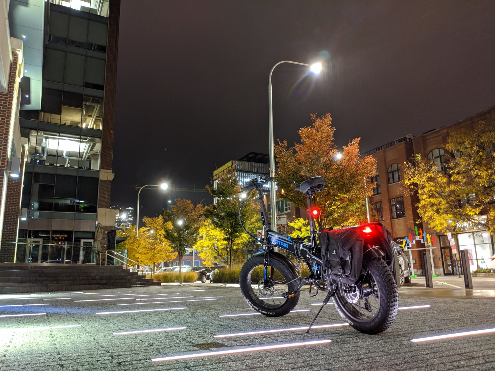

Anybody know if Ortleib Back-Roller Classic pannier works with Lectric XP rack? Or recommend a quality pannier?
Look up the Rhinowalk 25L bike bag on Amazon, you can't tell the difference between it and the Ortleib and it only costs $56! It's fully waterproof, has a small pocket on the front for tools, comes with a shoulder strap, the mounting points are adjustable so you can push it right to the back of the rack so you have less chance to hit them with your feet (depends on the size of your feet) and it is tall enough to fit your extra battery in it. It comes in black or yellow and is available on Aliexpress as well but the price is no better and Amazon will ship in 1 or 2 days.
Ok I bought them. Due tomorrow morning! I’m still a little nervous about how the bottom attaches
The bottom has a long adjustable lever that fits over one of the legs of the rack, it seems to work best when pointing to the rear or down at an angle towards the rear.

I have been busy riding I have now lost 9 pounds in less than 2 months and I was active before, go figure. Rode 49 km last nite, 42 the nite before. Here's a place by the river near my place. another trail that I didn't know existed till I bought this bike
