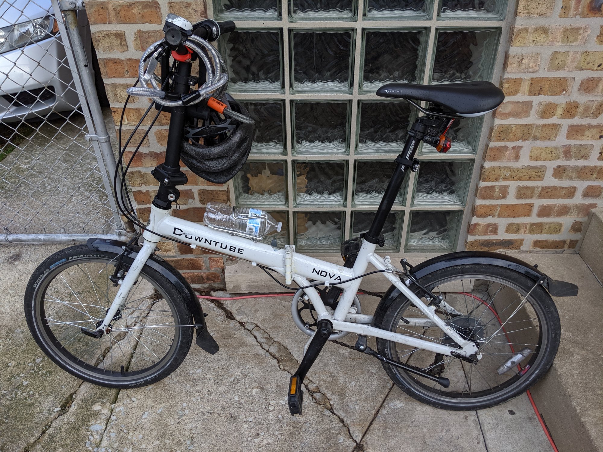

Eventually I decided on my Downtube Nova for it's lightweight and simplicity and price over everything else available at the time. I was a broke college student and did not have the funds to purchase my favorite bike. It was however light and passable. And no, I could not afford a Brompton!
I miss these old folding bike days but electric propulsion has really changed the landscape of bicycling as we know it.
Yay. ANother Nova owner, at least ex-Nova, The only thing on ours that gave me trouble was the hinge needs an annual oiling, or it starts to squeak. I initially bought the 8FS with full suspension a few years ago, but my wife commandeered it. So I got the Nova. I installed 250W motors on each. Both are around 35 pounds. Depends on what batteries I use. We only ride them for fun on bike paths. Much more nimble than my Ecotric 20" folding fat bike.

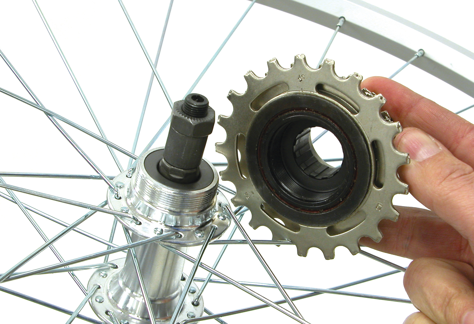

The back of your freewheel (cassette) is threaded and so is the motor (hub) and they screw in together. If crossthreaded, it wont go on all the way. Here's a picture I found on the web, it's not an ebike, but shows the threading. 40398. You'll get the idea.
edit: I didnt explain cross threading. its when you go to screw in something you dont line up the threads correctly and it gets buggered. thereby not seating right

The back of your freewheel (cassette) is threaded and so is the motor (hub) and they screw in together. If crossthreaded, it wont go on all the way. Here's a picture I found on the web, it's not an ebike, but shows the threading. View attachment 40398. You'll get the idea
Ahhh I see, intersting.. has anyone else had any issues with the cassette being cross-threaded from the factory? I am normally used to slotted rear cassettes that don't have threads, but if I remember correctly, my old 90's schwinn road bike had a rear cassette like this. You would think that if this was cross-threaded, it wouldn't be in a nice flat plane and would make all sorts of noise in almost every gear.
That being said, I don't see any visible threads looking down close, and everything appears to be snug and tight and close. Guess I will need to wait and see what others say for comparison, I'm very curious to find out.
I would think that if it is really cross threaded, you would see a little "wobble" of the cassette as you turned the wheel. It doesn't have to be cross threaded, I was just entertaining the possibility that the cassette is farther out for some reason. maybe threaded correctly, but something (manufacture defect) is preventing it from seating correctly.
