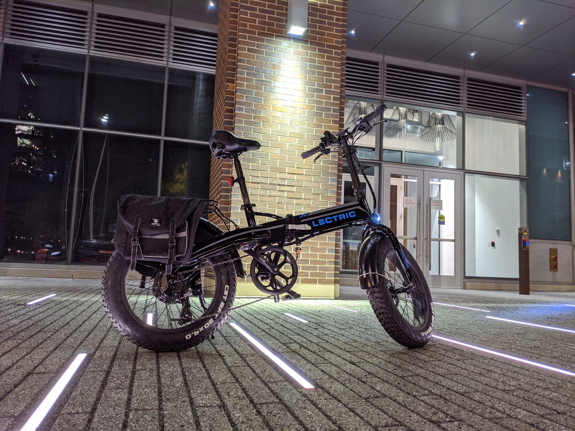

As I was leaving work I couldn't resist this shot. These in-ground lights are pretty cool and it started drizzling! I swear I love the Fulton Market neighborhood more than I do my own. If only I could afford an apartment here.
I live not far from you (Wisconsin), so if the weather permits I'm out every night after work. Got to get in as much riding time as I can before the snow starts flying. Great photos you took there👍🏼

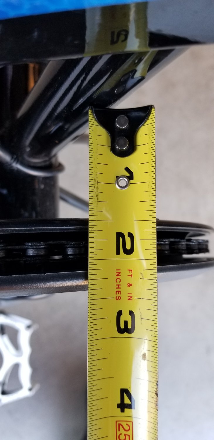

Can others here please check their 7th gear for cross chaining and see closely if it's dragging on the 6th gear?
So I looked at mine last night. it looks pretty much the same as yours as far as chain alignment, just not bad enough to rub. But I changed my freewheel for the 11 tooth high gear a while ago so it's not the same comparison. there's no visible chain wear and no noise. The rear cassette to motor spacing looks just like yours (maybe even a little worse). I did take a picture of the spacing of my front chain ring measured from the small angled tube next to the ring.40437 about 1 7/8 inch. I dont know where to go from here without having it in front of me.
So I looked at mine last night. it looks pretty much the same as yours as far as chain alignment, just not bad enough to rub. But I changed my freewheel for the 11 tooth high gear a while ago so it's not the same comparison. there's no visible chain wear and no noise. The rear cassette to motor spacing looks just like yours (maybe even a little worse). I did take a picture of the spacing of my front chain ring measured from the small angled tube next to the ring.View attachment 40437 about 1 7/8 inch. I dont know where to go from here without having it in front of me.
You sir, rock! Thank you so much for checking out your bike. I too, have ordered the same freewheel as you, and am looking forward to installing it, so when I take the rear cassette off I will then be able to tell if anything looks out of place there. Should be doing this this weekend.
In addition, I will check my front chainring for spacing and compare to yours (Looks like it's actually 1 7/16" instead of 1 7/8").
Lastly, my wife has a white XP coming in tomorrow, so I can check hers carefully as well to compare. I will find an answer soon!
- No response to my inquiry with Lectric on this issue thus far.
I was measuring to the center of the chainring teeth but it's all the same.
