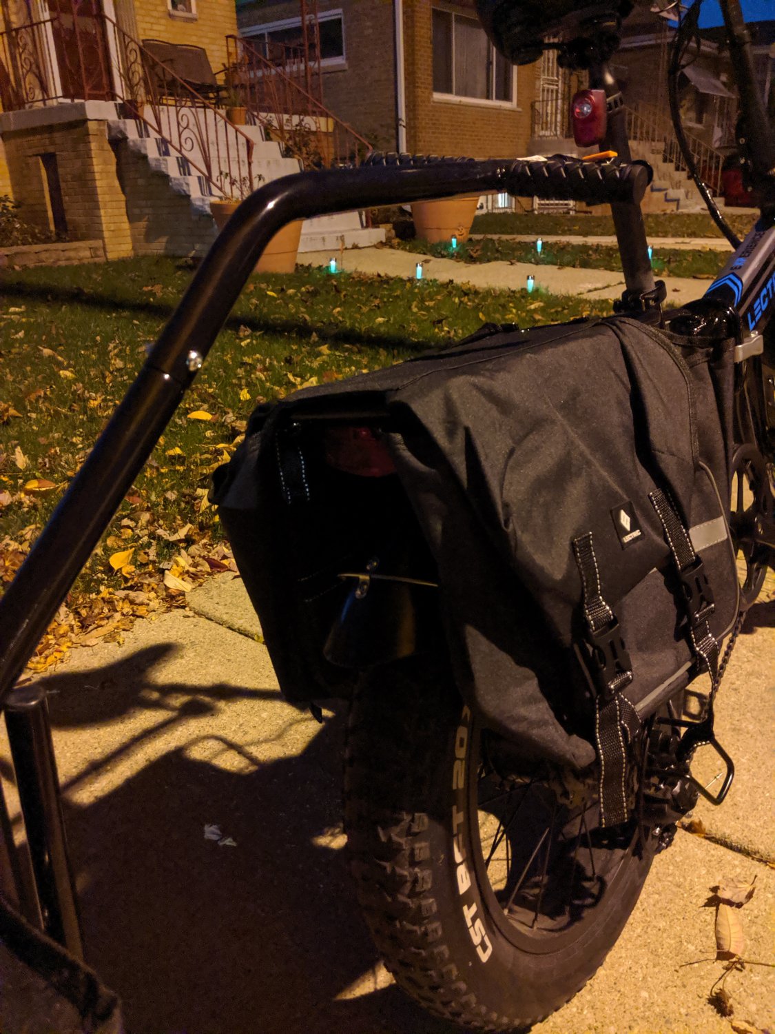

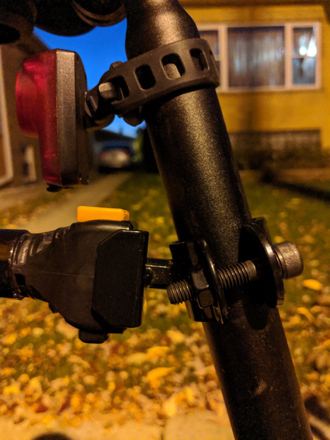

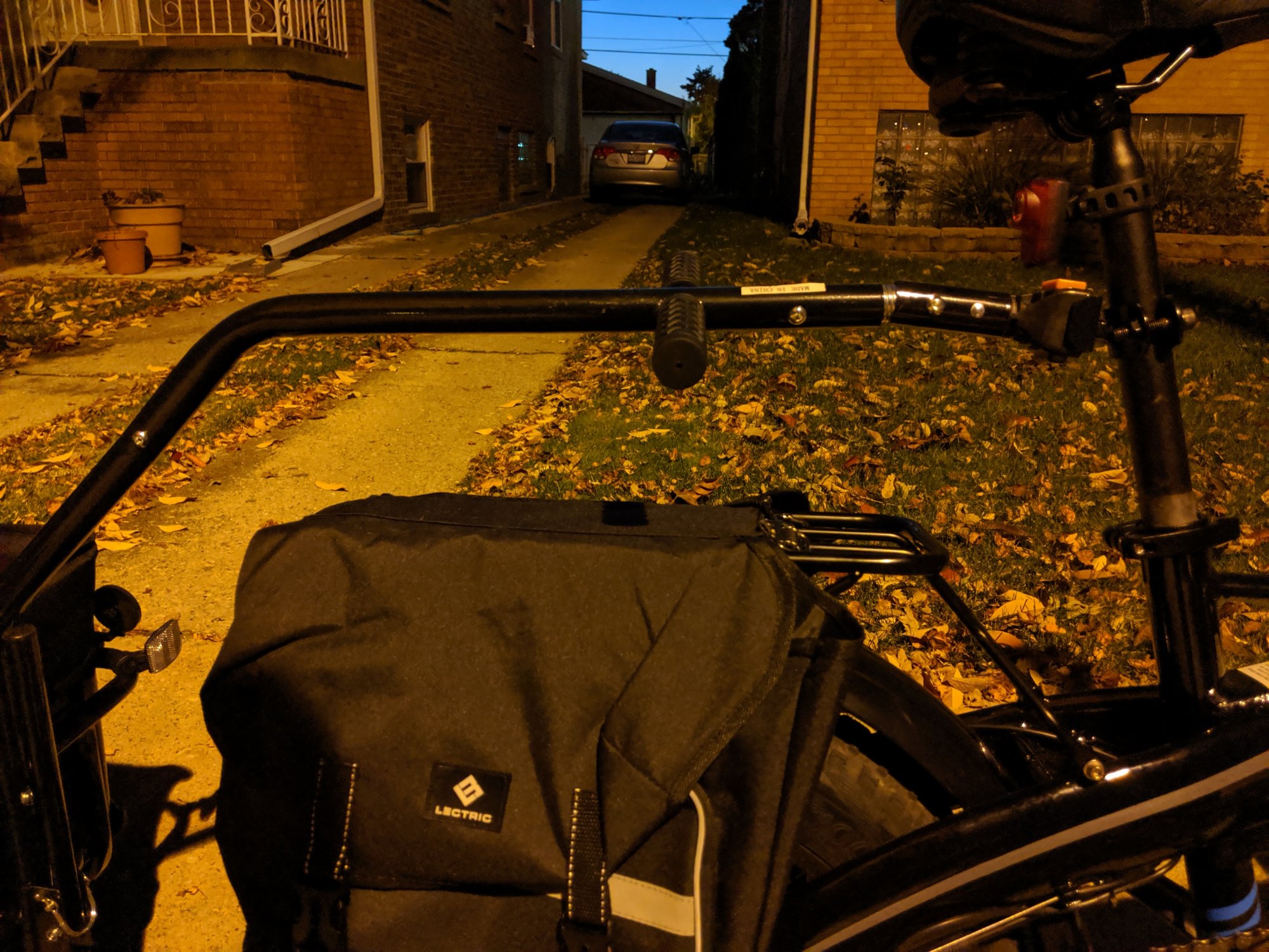

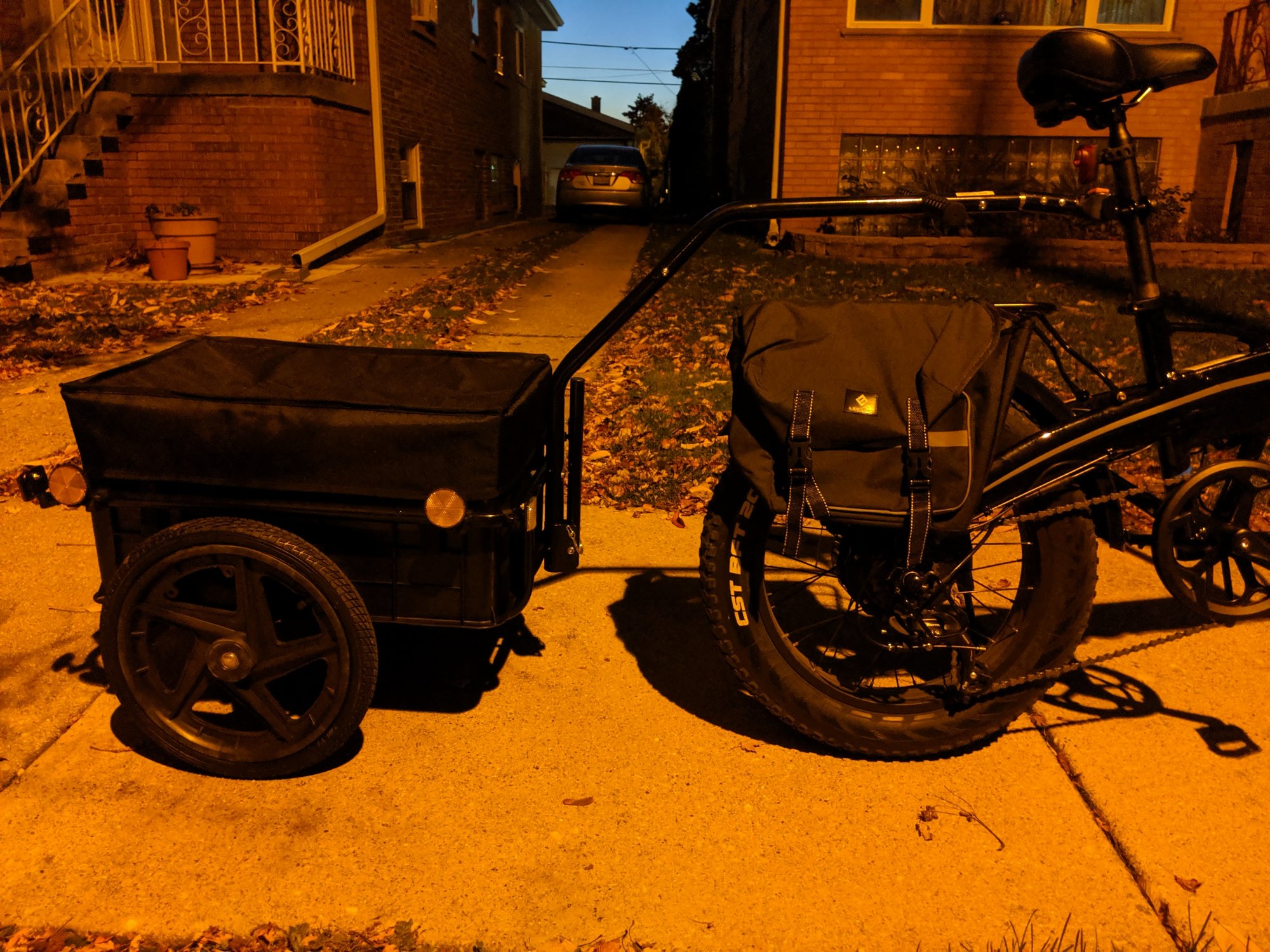

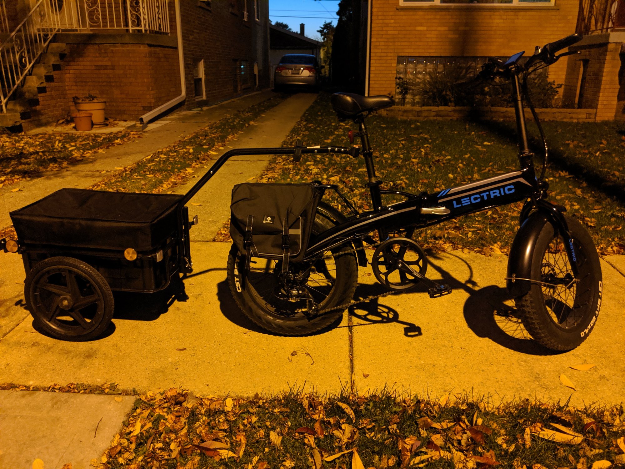

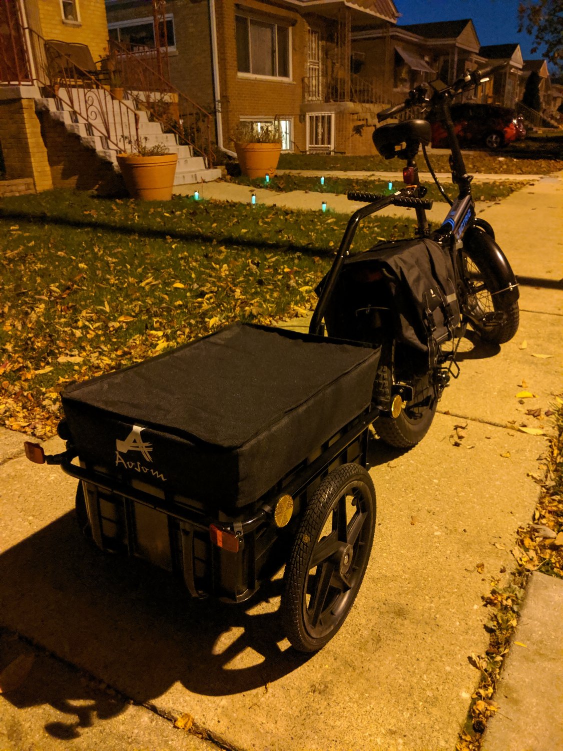

I finally got my cargo trailer all setup and ready to go. It took a little bit of elbow grease and patience to get it just the way I wanted.
I assembled it, used Loctite Blue on all the threaded fittings, aired up the tires to 40 PSI, and attached it to my XP. Overall I think it looks and works well with our style of bike. The 20" wheels with the lowered rear rack provide plenty of clearance for the swing arm. Up, down, side to side it doesn't seem like it will be a problem making contact with the rear rack. The only thing I had to change was the factory metric hex bolts that attach to the seatpost. The factory bolts were too short so I ran to the hardware store and picked up some longer ones. Afterwards everything fit perfectly.
Here's some pictures I just took. Sorry it's so dark right now but I'll take more pictures in the daylight. I test drove it a few times around my neighborhood just to see what it felt like. For my test run I didn't install my battery and just rode the bike as is. I went over bumps, cracks, pot holes to get an idea of how it performed when empty. It does bounce around a bit so I will have to be cautious of this because the trailer is so light and does not have any form of suspension. But otherwise if the road is smooth this trailer is very easy to pull and although it was empty and lightweight it doesn't feel like it's even behind you. I'm sure with a full load and with pedal assist it won't be a problem either.
The beauty of electric motors is having instant torque off the line. I'll be able to haul a ton of groceries with this simple little trailer.

I would contact Lectric if the bike is still under warranty with that thing attached to it. I don't think that plastic reduction gears inside the motor will be happy about extra weight. Also if right now motor operates at max when going uphill what will happen to it with extra weight? What if you burn that motor because it can't handle the extra weight? Is the bike weight limits for that reason? Anyway I know nothing about it and if I was you I would ask people at Lectric.
If the total weight is under the 330 lbs it's within limits. Gross weight rating is gross weight rating as long as it is not exceeded.
I wasn't thinking about all of this but that's not a bad idea. I'll have to reach out to Lectric and see what they say on this topic.
Are there really plastic reduction gears inside the motor?! I would think metal would be the obvious material to use due to heat, turning and the twisting forces on those gears. Interesting.
According to Lectric's FAQ:
"What's the weight limit?
The suggested max weight for the bike is 275 lbs (124 kg) and the rear rack is rated for 50 lbs (22 kg)."
The manufacturer of the trailer says it weighs 22.05 lbs (10kg) and it's max load capacity is 88 lbs (39 kg).
I assume if I'm below the total max bike weight I should be okay. I did a grocery run already and it performed very well. I used mostly PAS 2 when loaded and put in my own effort to help the motor a bit. I'll report back what Lectric says.
