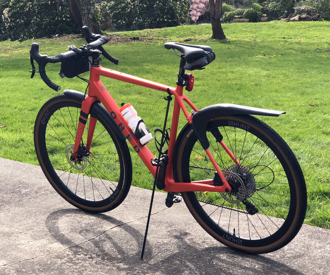

Most road bikes don't have a kickstand anyway. Perhaps just remove the other bolt and either don't us a kickstand or get a Clicktand. That is what I use on my Cannondale Topstone Neo Carbon 3. They are made to measure and quite handy. Be sure to get the measurements correct if you order one.
