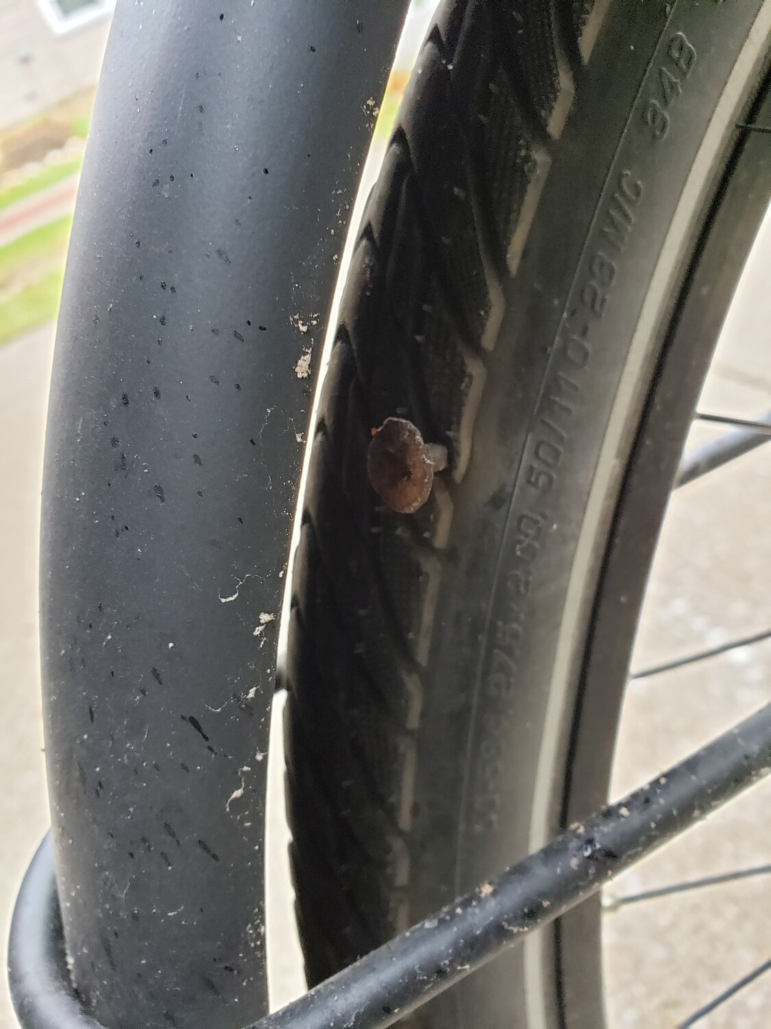

Hello! Here in Michigan it is quite common to find metal "filings" in a bicycle tire which cause flats. I believe that they come off the carbide snowplow blades as roads are plowed. Not much you can do about avoiding them as they are impossible to see. We also have a fair amount of flats caused by sharp gravel or glass. Prior to purchasing my EBike, it was very common to have flats every 500-750 miles. Best thing you can do is to buy tires with high puncture resistance. I have 3500 miles on my Trek Allant+ 8s using Schwalbe Marathon E-Plus tires. They are nearly impervious to the typical punctures caused by small objects. They are given the highest rating for Road Grip, Durability, and Protection. I did have one flat just recently. There was a very large sharp screw that entered the tire just outside of the protection belts. My Allant+ 8s has just over 3,500 miles and these tires show no wear. Typically I had to replace tires at the 2,000 mile mark.

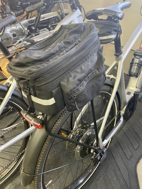

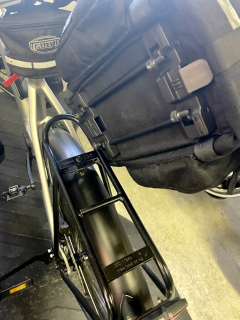

We have two Allant 7's. One is a stagger and one traditional. Plus a Trek Rail 7. The bikes have been great for going on a 8 months. I enjoy working on and maintaining them myself. One issue I've been made aware of is the chain ring lock nut. On the mountain bikes these have been coming loose. For grins and giggles I checked our Allant's and sure enough they weren't any more than 15 Nm and should be 30 Nm. Something to check when you service the drive train (chain, freewheel and chain ring).
On another note: been chatting with others regarding the Allant 8s and racks vs the 7 series. Here's the solution we've used. The bag is more or less a traditional bag but I've had this for over 35 years. Used on a tandem prior. The brand Jandd out of Santa Barbara uses really good materials and the quality is quite nice. The trick using the "Racktime" rack is to buy one of the attachment devices. This allows super quick attach and detach without having to use the velcro straps which are fiddly and not that secure if hauling any weight. What you have to do is attach the fixing rails to the bag. Once done it's a fantastic system!

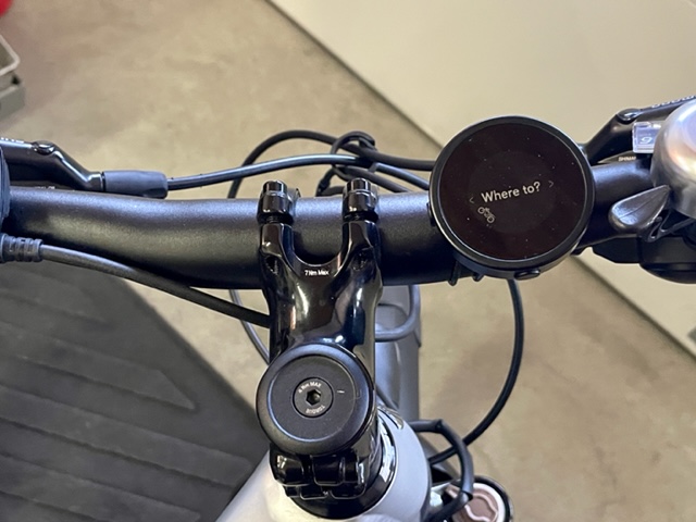

I'm not keen on mounting my phone to the bike (just personal preference) but found a great solution to navigation in a product called Beeline. Mounts right to the bars, and uses a phone app as the engine via Bluetooth. The app is really easy to use. I use it for motorcycle and bicycle applications. They make bike specific and moto models. The moto model has duel use for bike or motorcycle.

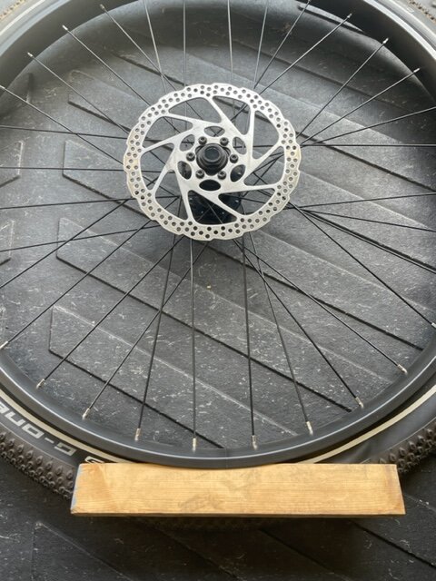

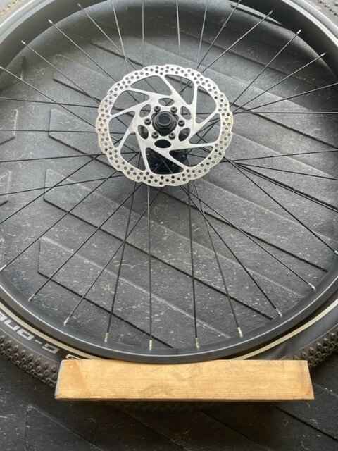

Something that I hope will help many with Allant's wearing the Schwalbe G-One tires or any other hoop that seems glued onto the rim. This is simple and effective way to reduce major aggravation when trying to fix a flat or remove a tire. The trick is to find a long flat piece of wood like a 1X2 and use it as a lever pushing down on the tire bead. Use your feet if necessary just be careful as to not damage the disc or wheel on pavement or anything. Guaranteed to work 👌 You may still need tire levers to pop the bead over the rim. Sometimes I need nothing more but good to have just in case. Remember to squeeze tire into the center of the rim to make install and removal easier. When filling the tire it can take up to 40 psi or more to seat the bead. You'll hear a satisfying POP 💥when it's found it's way home. Hope this helps out.
thats a good idea. though thats the part I ahve the least trouble with. sometimes its hard to get the tire off to be able to push hard enough on the lever.
