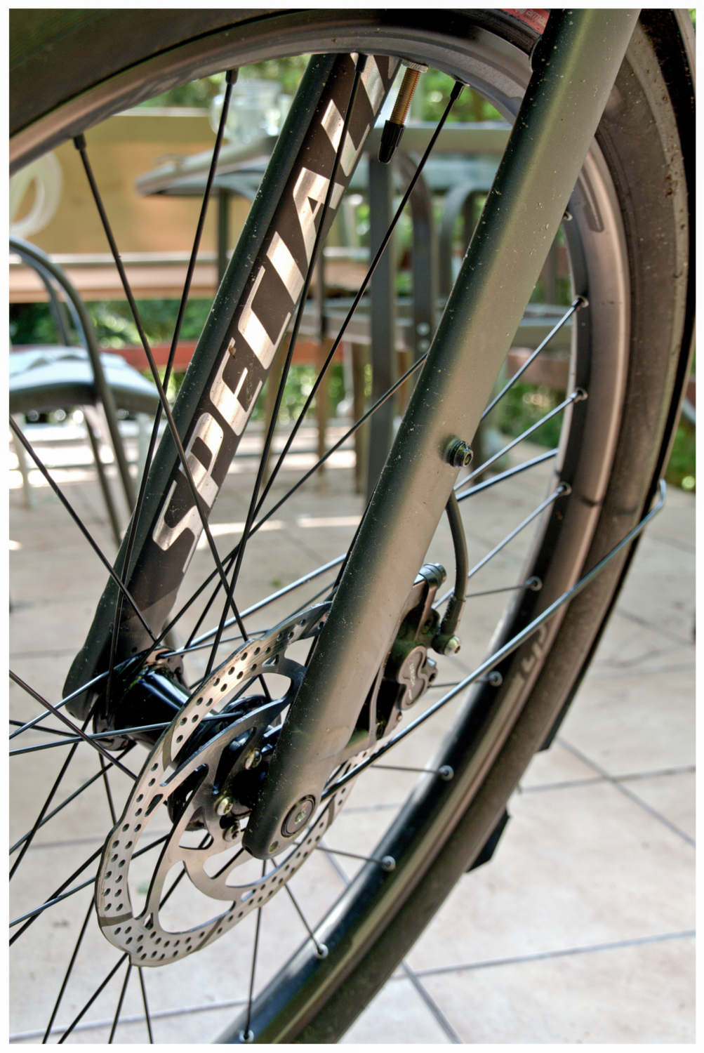

There might have been a pad spacer (linked picture shows the model I received) with the buying documents
which you should put between the brake pads during transport with the front wheel taken off. At least for a longer drive.
You use this pad spacer after installing new brake pads, too.
It helps to preserve the correct distance for when you insert the brake disc back in place.
There might have been a pad spacer (linked picture shows the model I received with the buying documents)
My local LBS provided these spacers with our Vados. I clip it in when I remove either wheel to prevent the hydraulic pistons from being over extended if I were to inadvertently squeeze the brake lever. To install new pads I use a piston press like the Park Tool PP-1.2 . As the pads wear the pistons extended further into the caliper. They need to be pushed back into place to provide a wide enough gap for the rotor when installing new pads.
